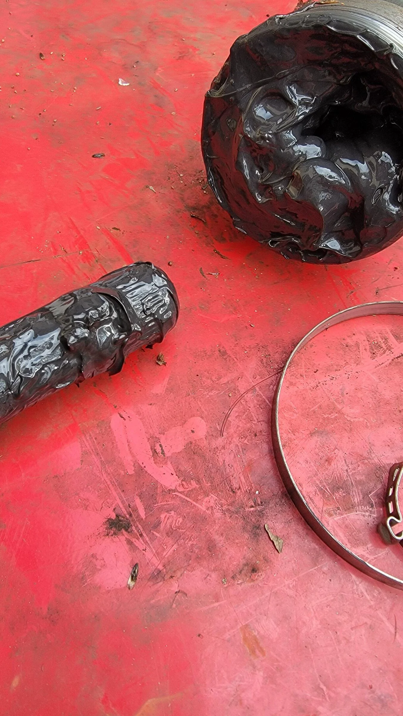

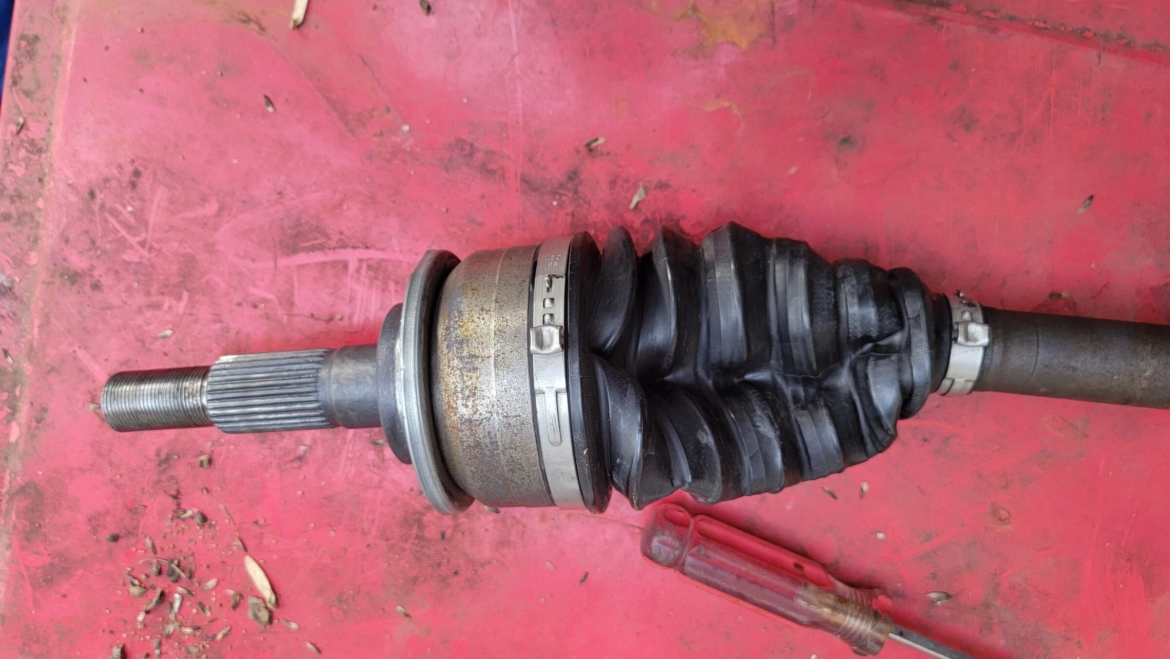

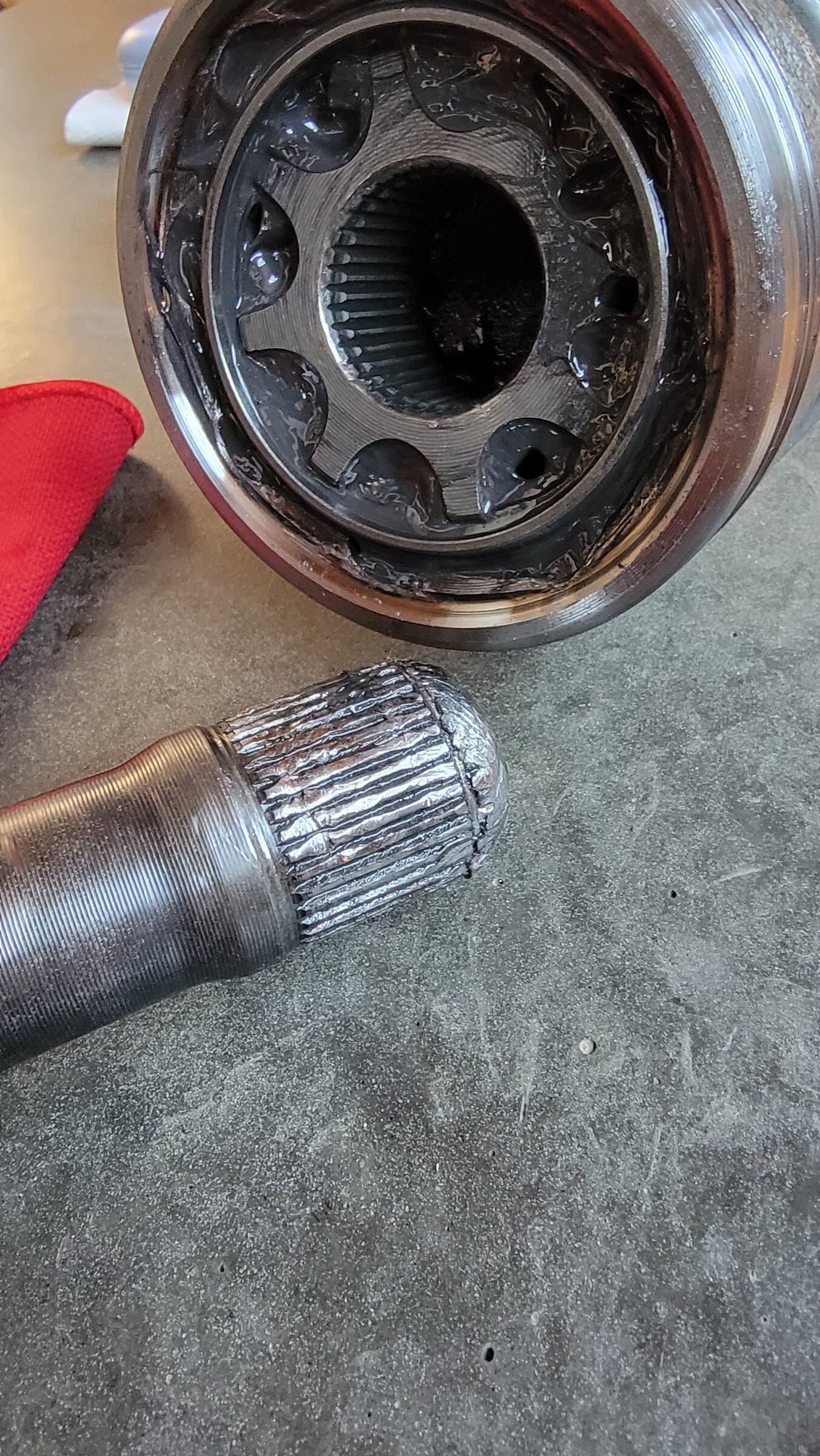

Could it be your CV axle is floating an not in the outer joint, as was the case with ours and many others. Does the noise change when you put it in 4x4? Do the front tires spin when in 4x4?

Wow! Not sure, have not had it in 4x4 yet. I made an appointment to have the dealership check it out though. I am hoping it's a big problem. Thank you for responding!
