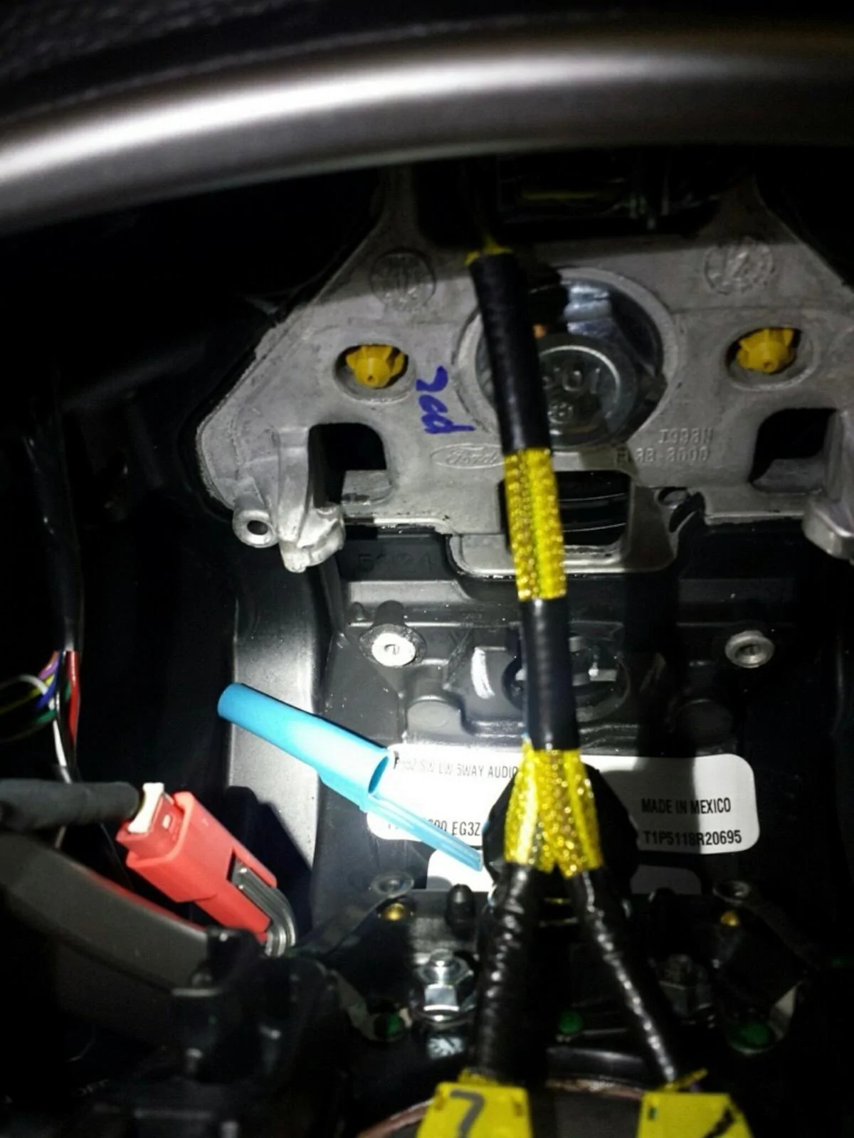

I have no idea what it could be, but funny story..
I did a PDI a few years back on an F150 that had a similar concern right off the transport truck. Turned out to be a pen cap behind the airbag left by someone during assembly. So at this point I’d say it could possibly be anything lol
Picture of said pen cap:
HA! That's absolutely insane! I can't even imagine the double take you must have taken when you saw that.

Lol yeah crazy things happen. Hopefully your noise is an easy fix, I would probably just bring it into the dealer and have them listen to it. Could be something as easy as one of the connectors behind the airbag just loose and moving around.

I actually just had this same problem. it wasn't too loud but definitely noticeable. the dealer replaced the clock spring which wasn't the problem. it was actually something in the air bag compartment. Get it looked at ASAP. if you have the same problem. I would hate to have what ever is in there hit me in the face in an accident.
Thank you for your response! I think I had actually read your thread at some point. I'm glad that they were able to resolve the problem for you. Maybe it is worth going to the dealership for it... no one likes plastic shrapnel lol

I Haven't had another Thread about it.. that makes me think there may be others with the same problem. of course my old ranger has had the bags replaced twice :oops: dang Takata recall.
I would definitely have it looked at!
