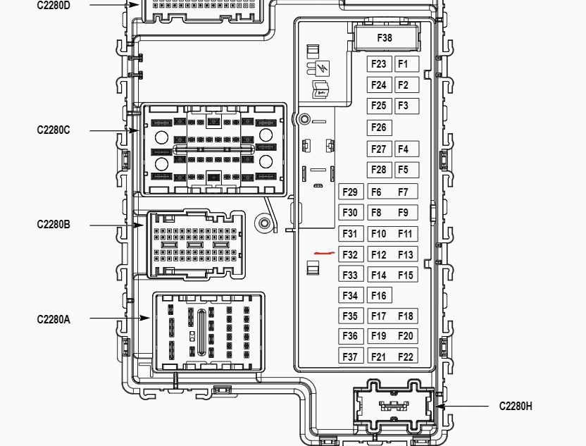

Probably got water in the ACM or one of the other modules/on-off switches. How wet and either put a fan on the the interior for a couple of days, better if you can seal it up and throw a dehumidifier inside for a few. It may dry out and work normally but if not, get an appointment scheduled with your dealer.
ETA: In the meantime, I'd pull fuse F32 in the Body control module (left of steering column under the dash) and kill the power to it so you don't start getting other problems like battery drain.

F32 shut off the audio and didn’t shut off the sync system. I found this other thread, pulled that fuse and it seems to be working as intended?
I’ll continue to keep an eye on it.
