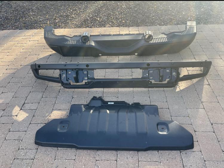

Hey all, I’m considering buying this modular bumper set but first have some questions.
Is my current hardware on my Outerbanks Sasquatch standard bumper compatible?
Do I need to purchase any addition hardware besides the hook covers that are missing? (M2DZ-17E810-GA and M2DZ-17E811-GA)
Any modifications I need to make besides cutting the tow hooks?
Thanks everyone.

When I went from my base bumper to modular I used all the existing hardware. Only issue is cutting the tow hooks like you mentioned. Everything lined up perfect for me so I’m assuming the bolts are the same either way. I modified my plastic skid to work until I can find one. Looks like you have one there which will save you the trouble.
you Will want to get the plastic covers though.
rear bumper I haven’t messed with yet.

I believe you are right on track cut the stock tow hooks and re assemble. Can you answer a question. Is the middle of the rear bumper in the picture plastic or can you actually step on it. The regular plastic bumper just collapsed under weight.

Agreed, just did mine last weekend / front only. Pretty straight forward biggest deal was the sensors don’t mix them up and fine. Metal saw zall blade and hooks came right off.
