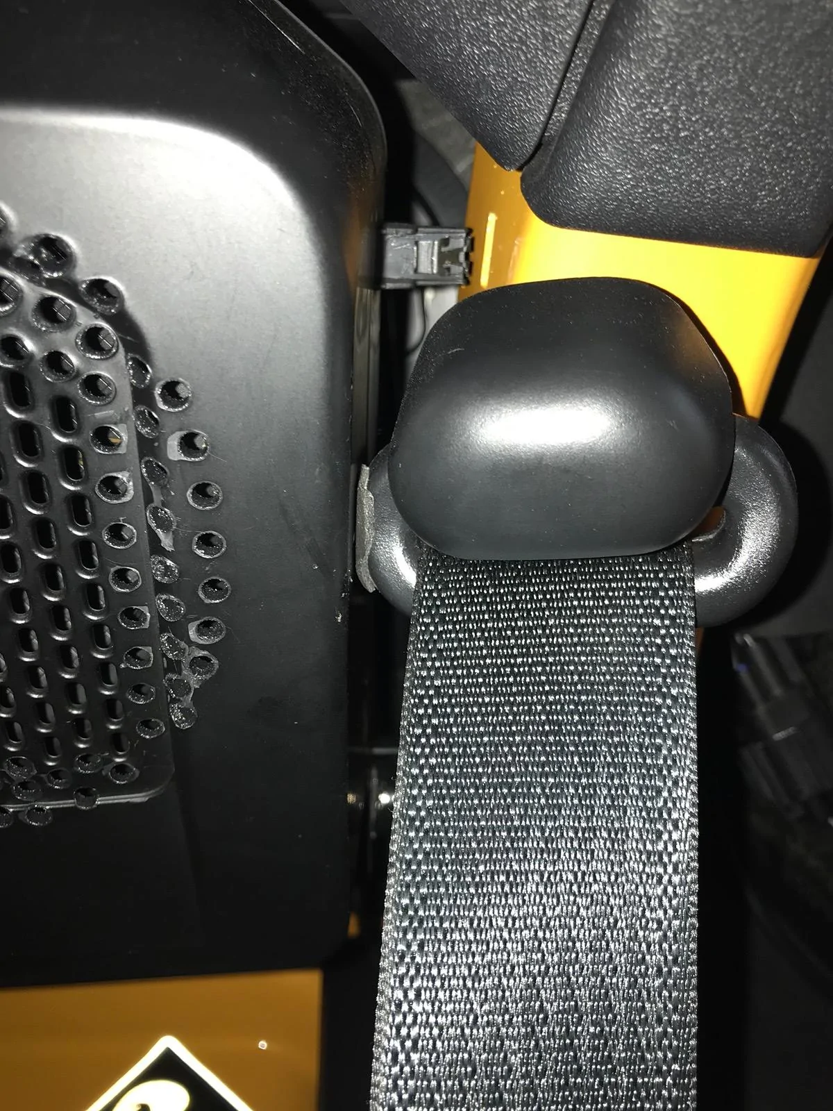

Did you have to remove a seatbelt plastic cover?
No problem at all with seatbelt it just swivels out of the way but like I said it’s only by about 1/16”. Mine are probably closer to 1/8” because I placed a small piece of foam between pod and seat belt to silence any new rattle. Definitely do not need more of those😂

Ok, so after looking at old ones, I think the same brackets are used for both the 2 and 4 door, only thing different is the bushing for bottom mounting bolt when used on 2 door. I also recall that if I used the supplied bushing without trimming and instead used a longer bolt the pod would not touch seatbelt at all. I’m quite certain top mounting brackets are universal 2/4dr.

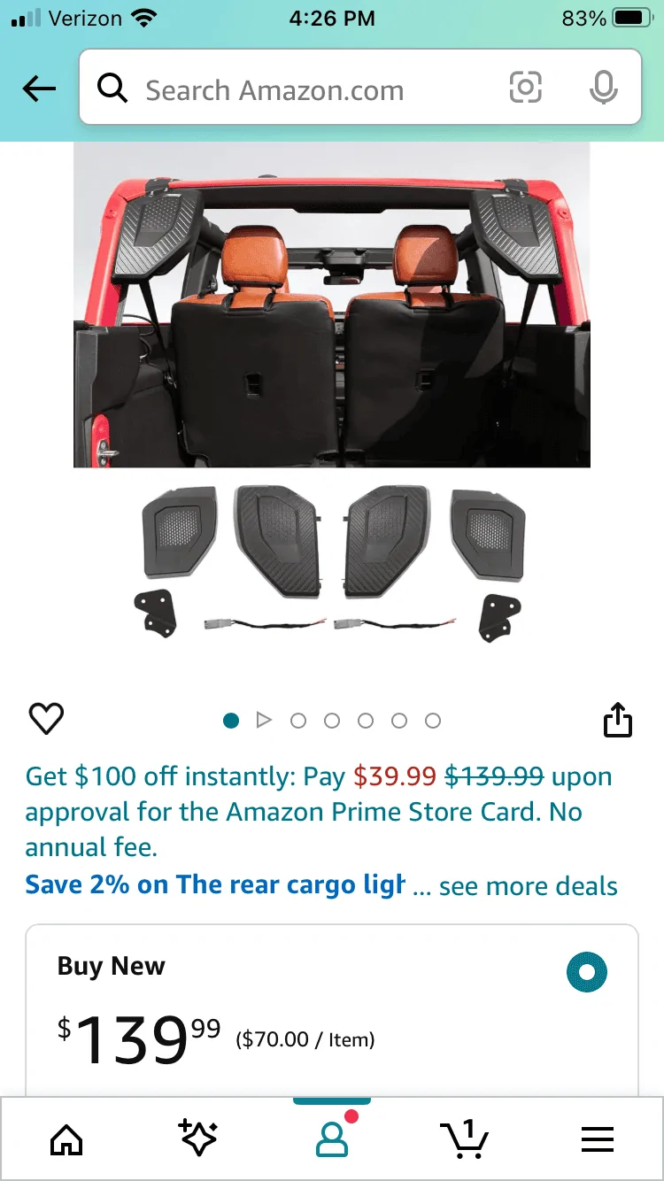

On the link above for the speakers did it come with the needed wires/clips to attach to the factory harness or did you cut those off the factory ones and reuse?
So, the Mabett pods actually come with the wiring harnesses and they also come with the spacers you are talking about for the 2 door.
I mentioned near the end of the video that I believed the spacers are for the 2-door version. Hope that helps.
At the beginning of the video I show what comes in the Mabett pod kit and then the speakers separately.
