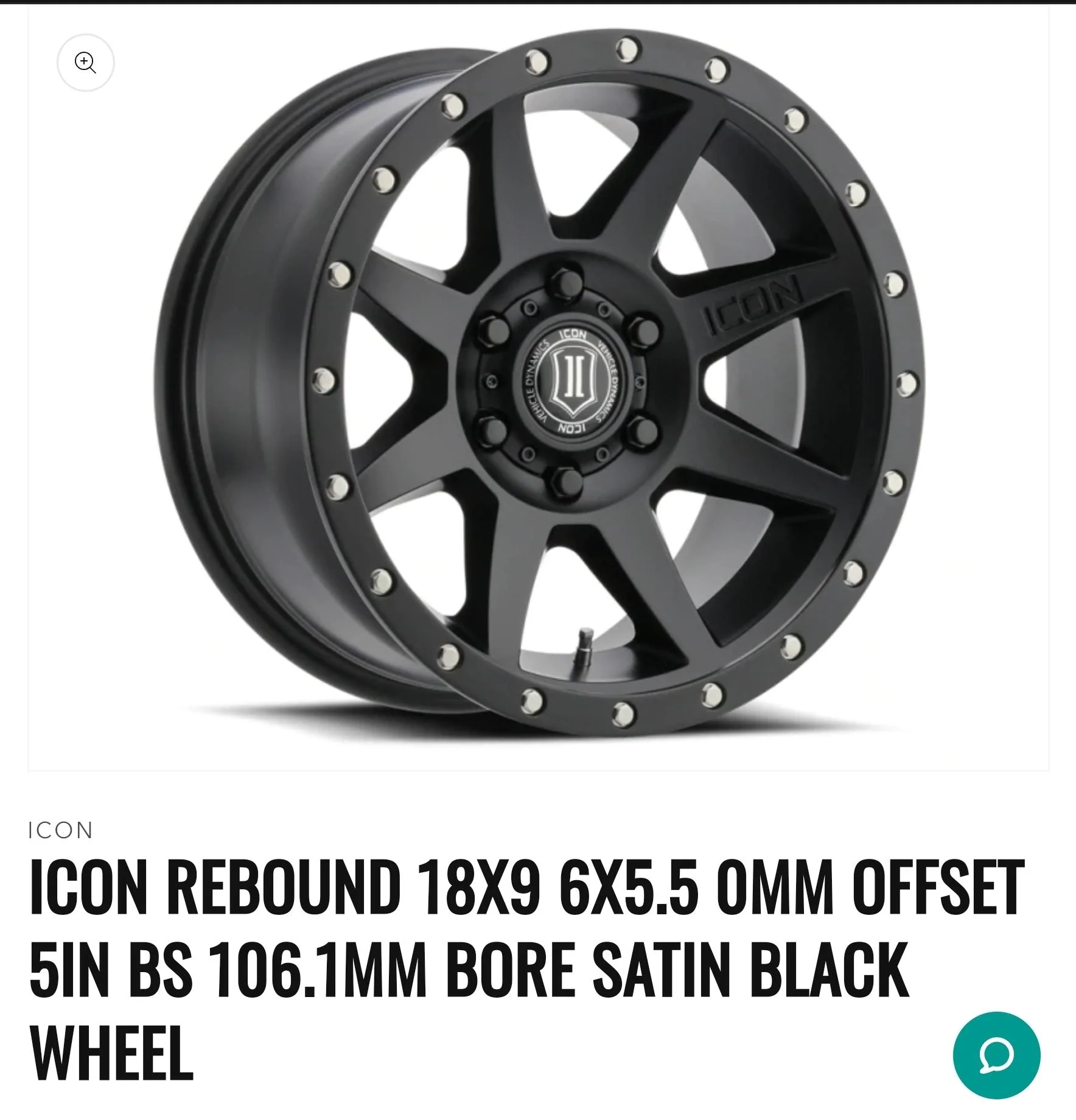

Ok finally I decided!! I'm newbie to buying wheels and tire.
I'm thinking to get Icon Wheels 18x9 with 35" 12.5 ko2 on my outerbank. If does, do I still have to level up the Bronco? Or not necessary? It is non SAS bronco.
Originally I was thinkg to get 20x9 with 33" tires but man~~ so much negative comments I seen..
I like 17s too but just me it looks bit small to my newbie eyes 👀 😅 🙃
Any thoughts or recommendations.? Thank you all.

Forgot to add pics... lol

I'll let the experts chime in, but 35s will require removal of the crash bars and a bit of lift as far as I know in order to be truly functional.

Yes, I was thinking to get aftermarket crash bar, but not so sure about leveling kit needs to be involved or not. Trying to get everything ready before ordering wheels and tires.
Thank you for the heads up!!

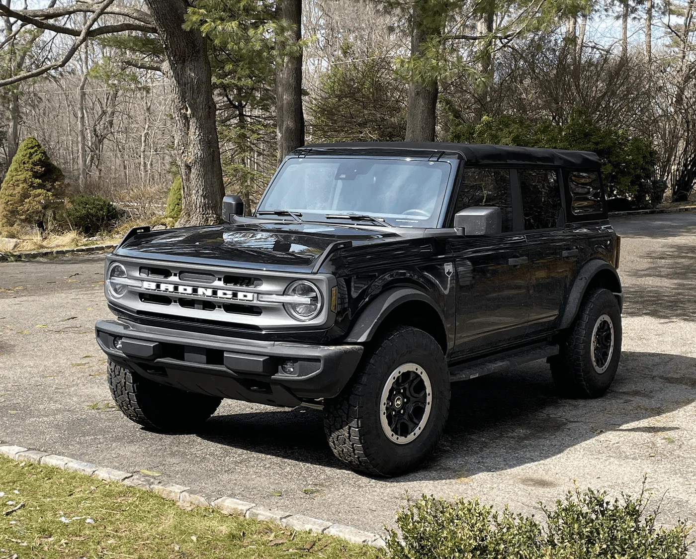

I put aftermarket Sasquatch rims and new 35" Toyo A/T III 's on my Big Bend. I did a Zone 2" lift and ended up with some rubbing when the front wheels were fully turned/articulated. My mechanic told me he couldn't legally remove the crash bars in my state, so I bought 4 Wheel Parts contoured crash bars and had them installed. They work beautifully - no more rubbing.

Thank you very much!! Your Bronco looks great
