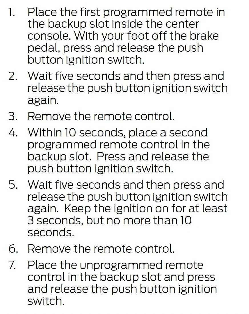

Right, that's a fair question and think that is along the lines of the problem now. See picture, however, and it calls out the Bronco specifically. That paired with the comments about it working fine for the Bronco...
It's Amazon. And you believed them?
Yes, they said it replaces the appropriate part number. So?
As far as comments, those don't count.
You rolled the dice, went cheap, and got something that doesn't work for whatever reason. Send it back.

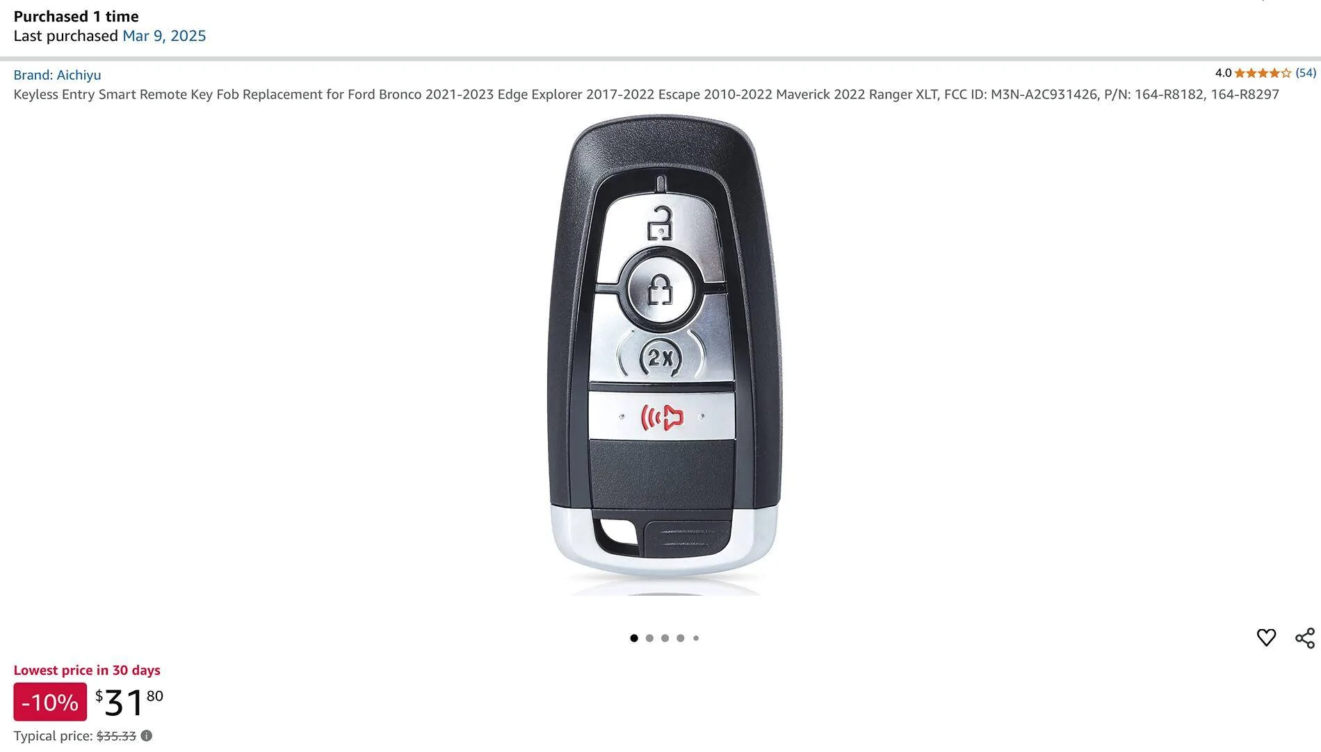

I did it yesterday, this one worked:
Aichiyu Keyless Entry Smart... https://www.amazon.com/dp/B0BW3W2WZG?ref=ppx_pop_mob_ap_share
That's good to know and appreciate your sharing this!
So, despite my unit, above, not working completely it turned out to be a happy accident for my particular use-case...
I have two OEM working keys/fobs and wanted this for a hide-a-key setup when outdoors beyond cell coverage. For a little added security I like that the radio isn't functional and only starts the Bronco in the special slot. No need for a "Faraday bag" when hidden either. I was able to get my key cut for $10 at the local GM dealership oddly enough (local Ford machine is down).
For $40ish total, I'm happy but good to know we can get some cheap fobs to work now too. I suspect mileage may vary even ordering the same exact unit. Curious if others have the same experience.
*Edit: clicked on link and can confirm same unit I bought. I have a manual w/o remote start and that could be the key difference for those tracking this nuance.
