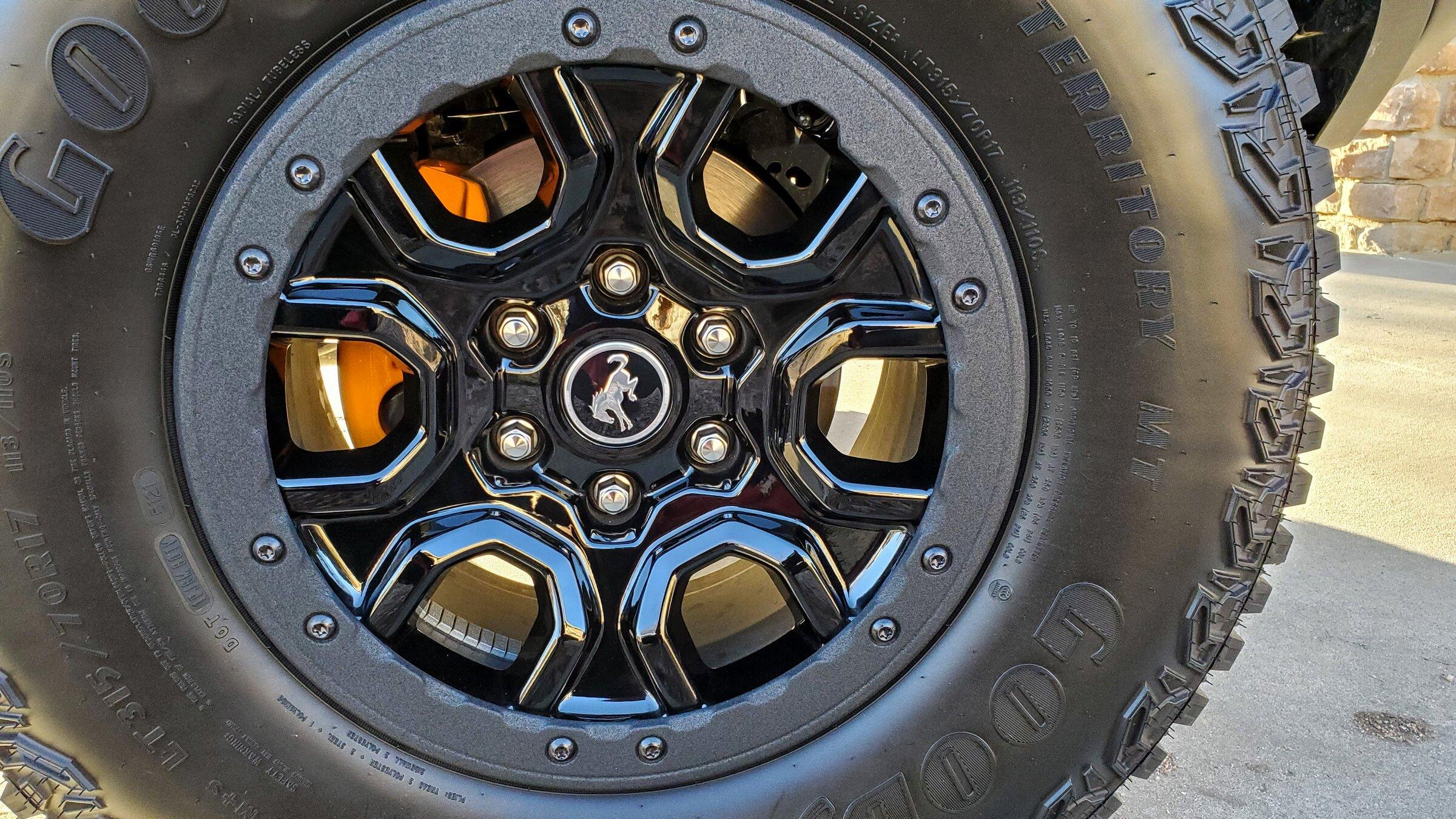

I powder coated my beauty rings grey to match the fender flares. Love 'em.
Ford Bronco Powder Coating Options (Cosmetic Changes) 20220324_182457
did you sandblast them first? I'm planning to do the same, trying to determine if I need to go as far as stripping down the factory coating first. looks great, i'm planning a similar color!
I had a local custom shop do them and had them powdercoat my calipers and tow hooks, among other things. Unsure how they did them, but I love this look much better.
Ford Bronco Powder Coating Options (Cosmetic Changes) 20220324_103841
