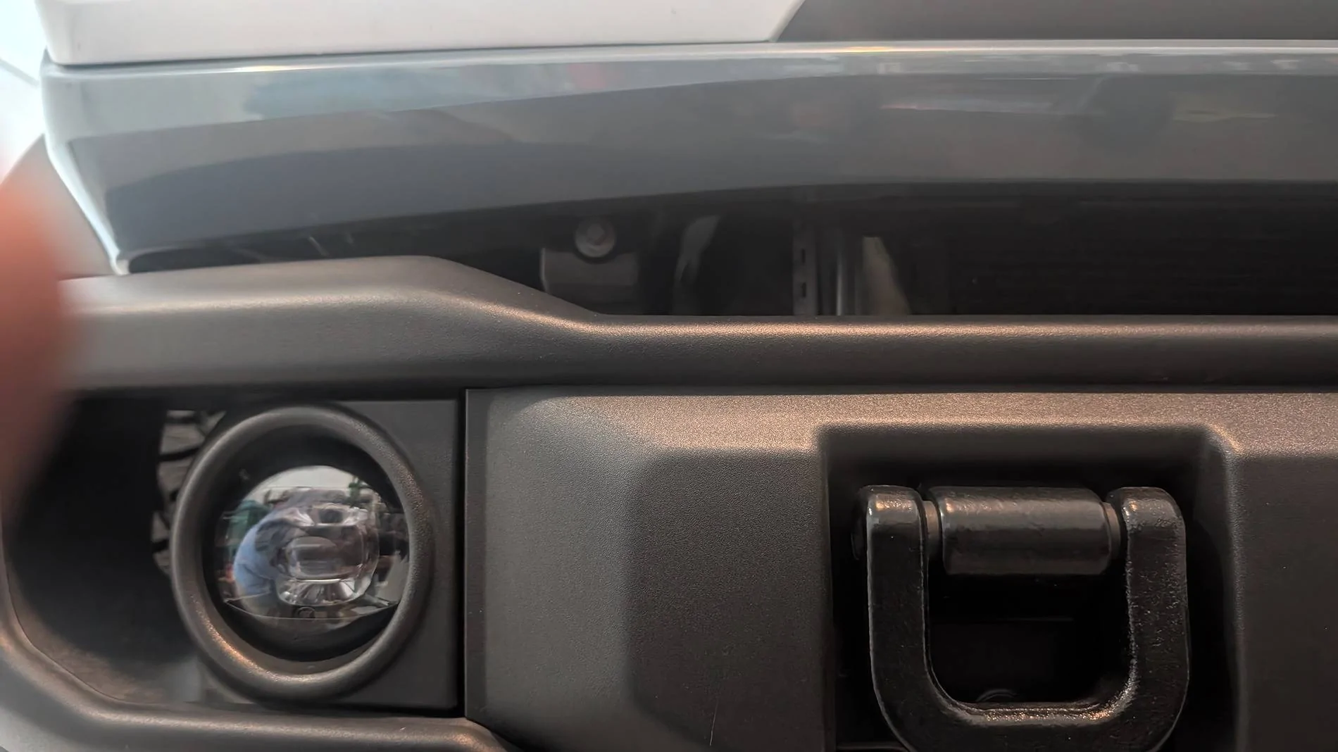

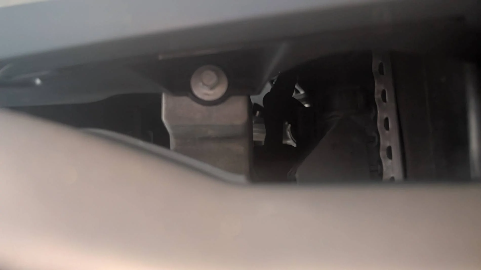

Any chance this could be used as a lighting mount. Thinking a drOving might on each side of this can be used. Anyone try anything like this or see a potential pitfall?

Only concern I would have is that the gap on the front tends to change a little dynamically if you get a little too rowdy as the body mounts compress. It's not by much, so a flat bracket would probably be fine.
I think you would be able to snake a bracket through there, but it'd probably have to be custom made for purpose (whether that's sendcutsend or home fab).
For Capable light mounts specifically, Nacho used to make a quad mount for the plastic bumper that also fit Capable. Seems to be discontinued. DV8 has a bullbar that mounts lights, and Heretic has a direct-mount lightbar. If you're looking at making a bracket anyway, doing some research on how those products mount up might help you.

i believe M&R actually utilizes that to mount their light bar for the standard bumper. They use a bracket to locate the light bar and everything, but that bolt is utilized i believe. So i imagine if you get creative, that would be a cool spot.
