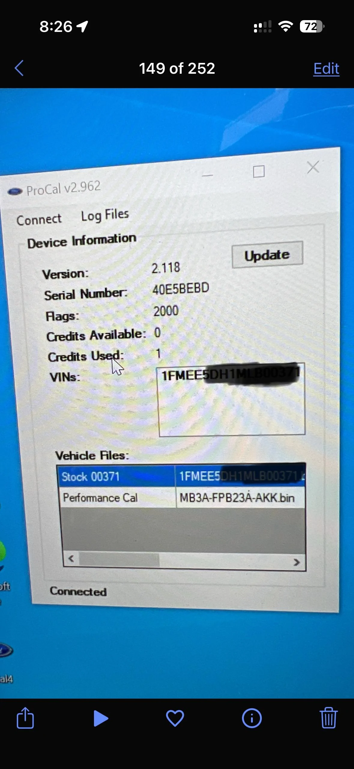

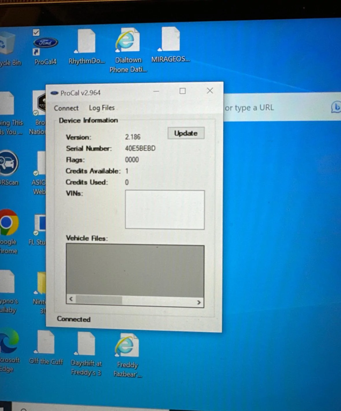

Had something weird happen after I upgraded my Procal on my laptop. I currently have the tune on my car.
After I upgraded I noticed my stock tune and Performance tune disappeared.
So I connected the Procal to my car and the first thing it wanted me to do was save my stock tune before I can continue. So I pressed save and then when I pressed performance tune it said there was none.
So I go back to the laptop and now my Stock and performance tune is available with the addition of a DLCM upgrade. What is a DLCM upgrade.
So I reconnect back to the car and add the Performance tune. It now included the DLCM.
Here are some screenshots of my before, during and after.
