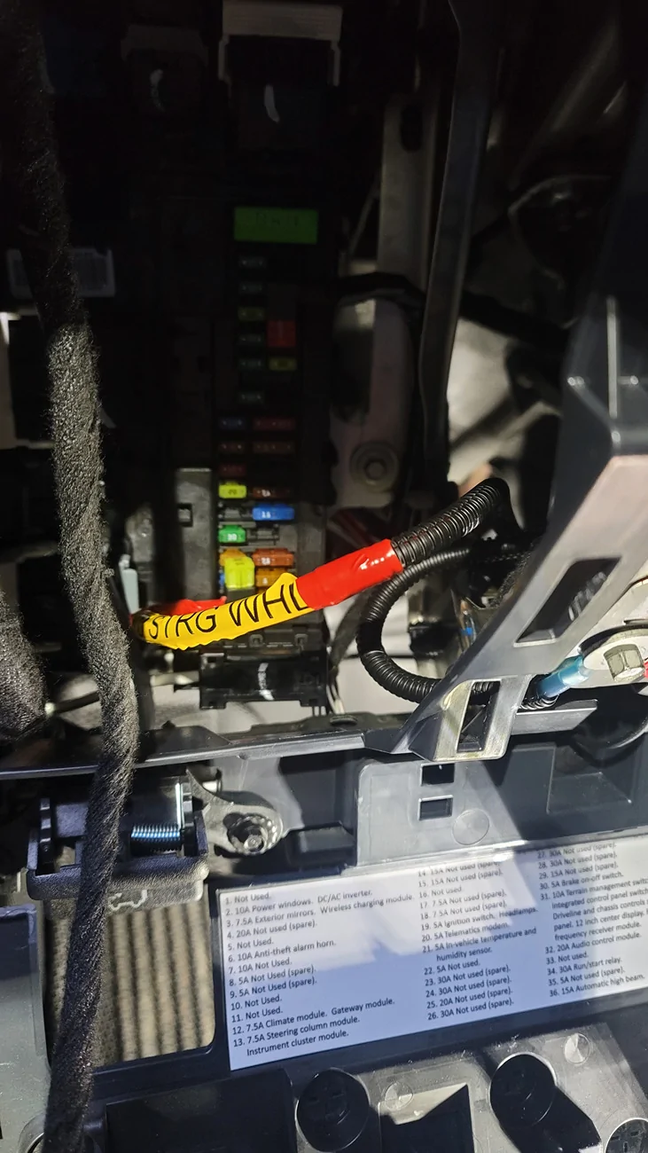

I wonder where the original power was pulled from if you needed to tap a fuse. Got any pics of the install? Not something I NEED but will eventually want to retrofit.
Fuse tap goes in the same F37 circuit the OEM heated wheel would, but rather than tap the back of the fuse panel, just plug in the piggyback.

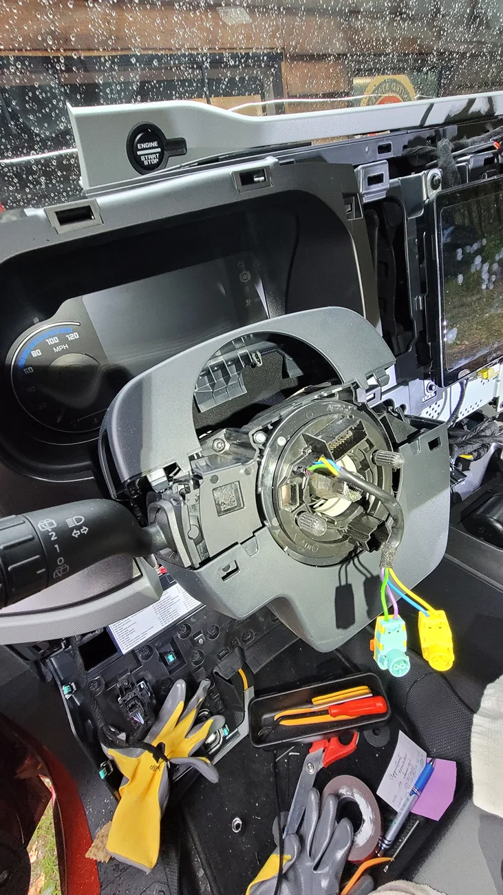

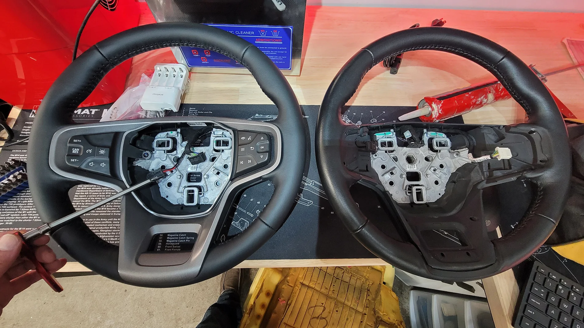

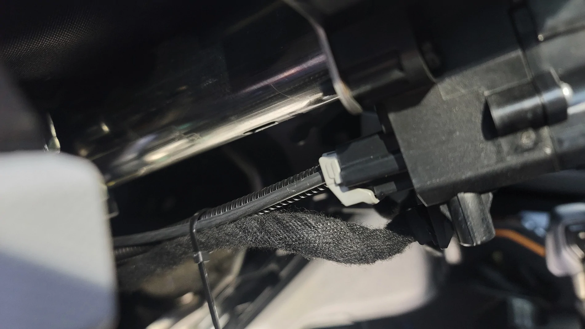

Here is the thread I used, along with a handful of install shots.
