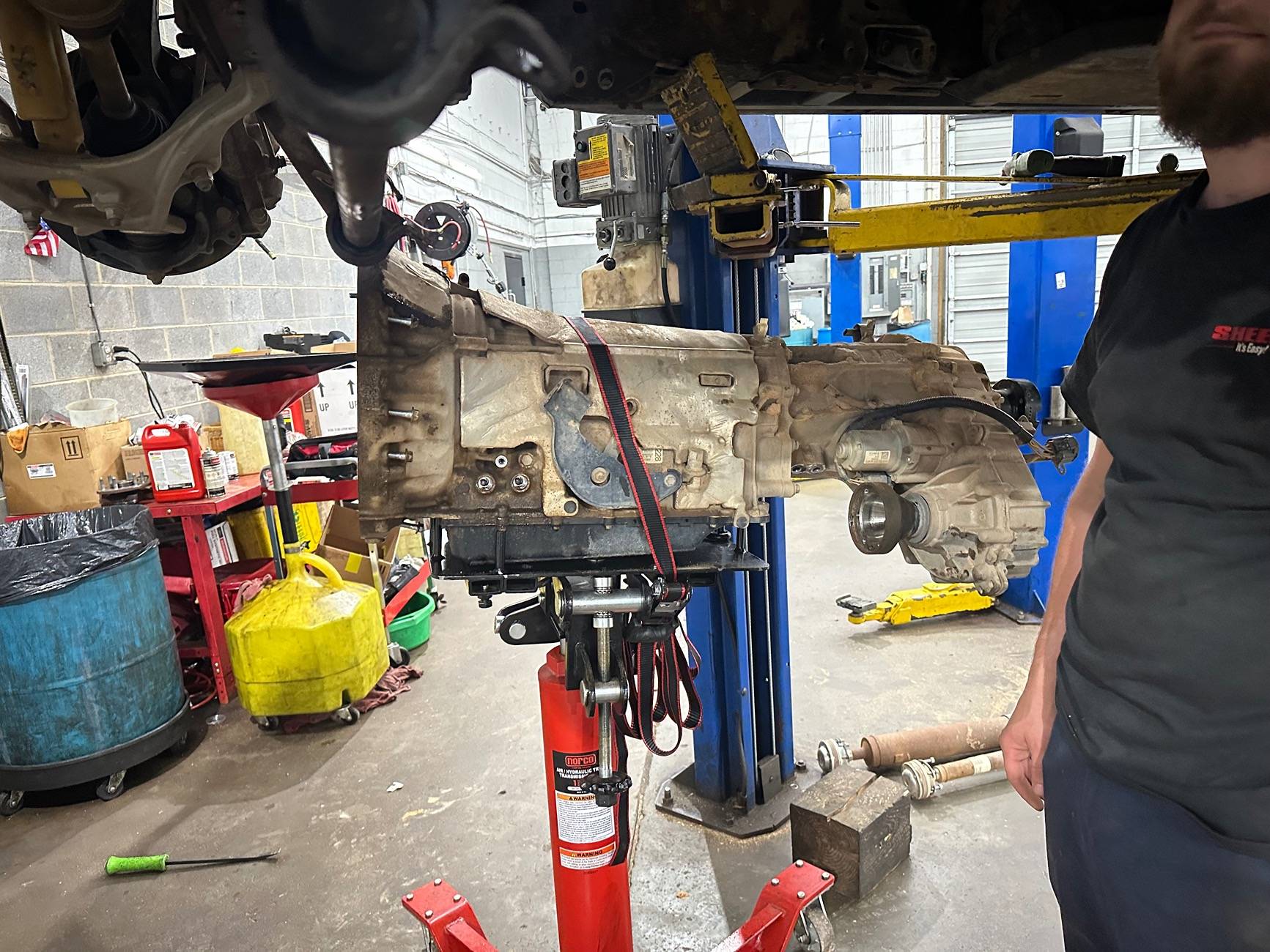

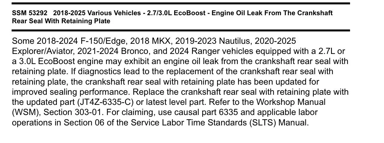

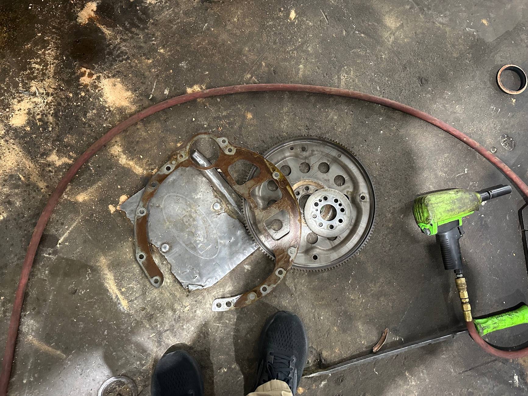

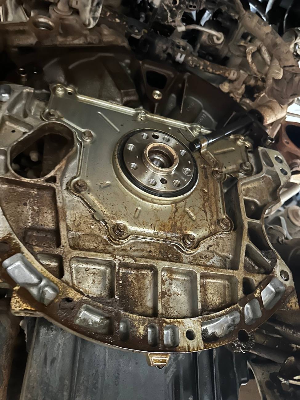

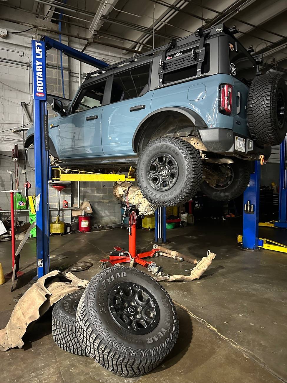

@Ducati1098 they are finally working on it now. Has this been a common issue with the Broncos? They said it was a pretty bad leak about a quarter of oil or so. Thankfully its all covered under warranty.
Yeah pretty common on some of them. I've seen a handful of threads with the same issue.
