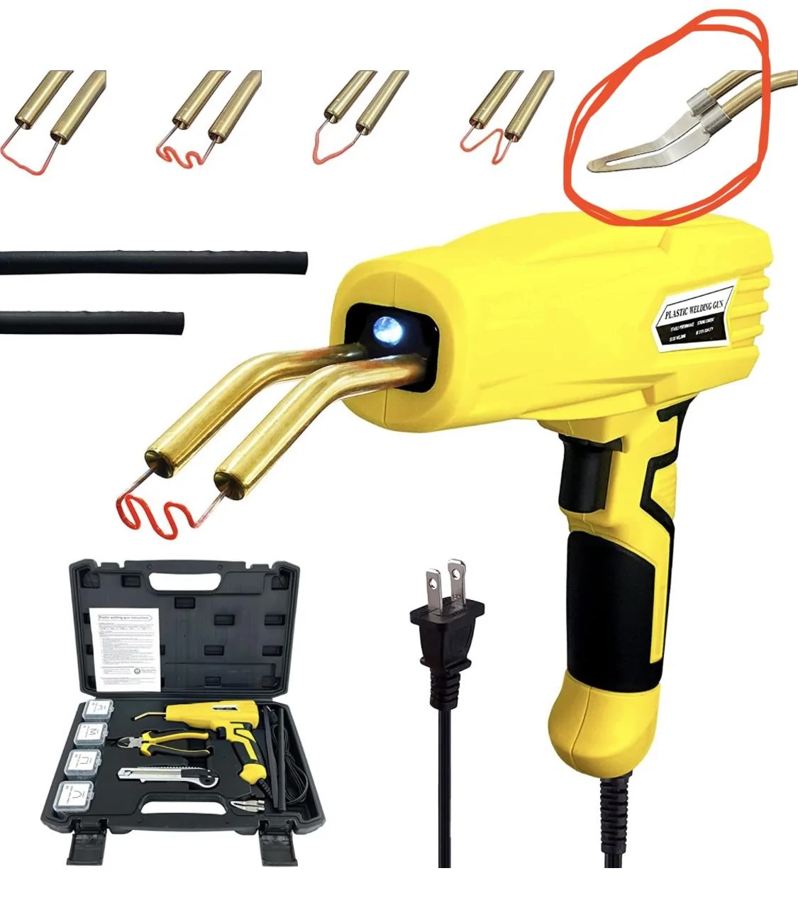

Oh nice I do love some HF trips lol. Now if I did that, do you just push down on the “stake until
It melts enough to hold it in place? I’ve never done it before.
Yep, that’s pretty much what I did. Push down with a flat adapter like this one, until it’s melted flat like the original letters. The HF one is a little different, but should work in a similar manner
