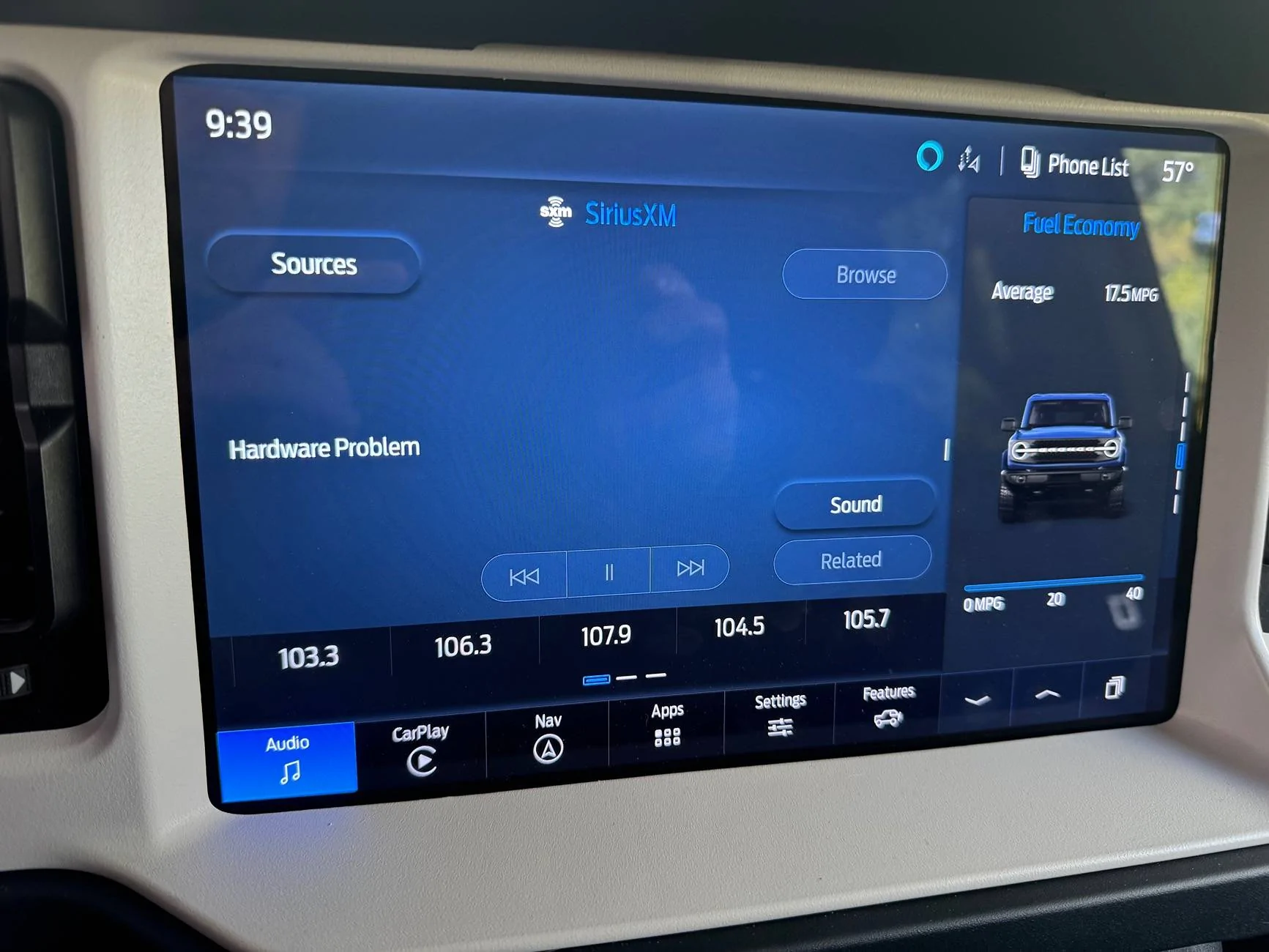

Hi All, Does anyone know what this issue might be? Module, some setting or a button/knob that I don't know about? This is on my new 25 Heritage.
Happens enough to be really super annoying. Does not matter what the source audio is.
On the screen pops up phones volume adjusting. The really weird thing is ... there is no phone connected. No phone connected via bluetooth OR CarPlay. It was driving me nuts so I fully removed the phone thinking that was the issue... and it still happens. PIC of no phone connected and video of issue. If this issue didn't mute the audio, I would not care. I have tried to reset sync4 and that did not solve the issue.

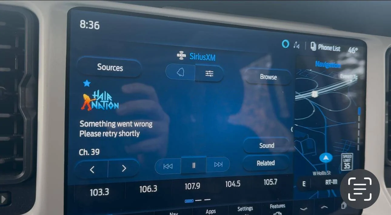

Circling back around on this.... It is still happening even after the reset. I however did notice that this seems to be specific to SiriusXM. Every time this happens (sound mutes and phone volume pops up) I see the notification XM SiriusXM updating. Without fail. It also started to register that this happens more often when it’s cloudy (Pointing again to SiriusXM).
Called SiriusXM and they reset something but as I was talking to the support, they said that this is a HW issue and to talk to Ford. Which suuuucks.
If anyone has experience dealing with the ACU or whatever the module is called, I’d love to hear about it.
I’m more documenting the symptoms now, with hopefully a fix at some point to help others if they run into this.

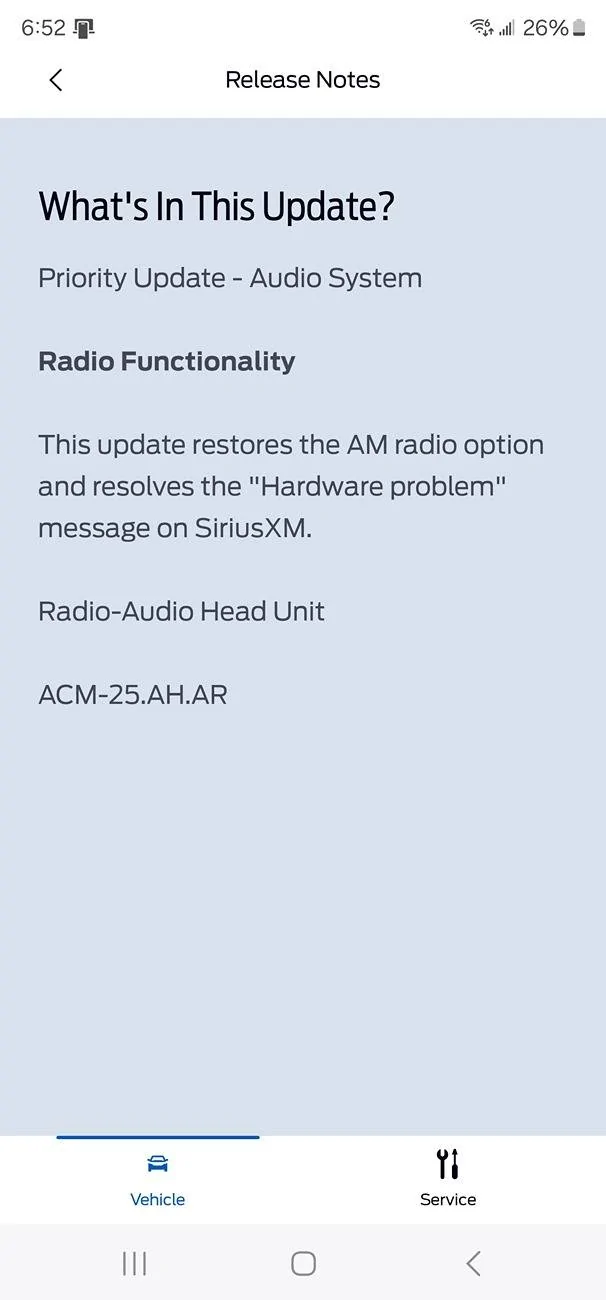

There is a recent ACM update that was first pushed out to F150/Lightnings a week ago that addresses some kind of problem related to Sirius. Hard to say if this also relates to your issue, but it may be software related:
https://www.f150gen14.com/forum/thr...read-f-150-lightning-mach-e.16968/post-639376
Ohhhh. That actually could be a possibility. It does say Hardware Problem in that update. Not sure if that’s a generic statement. I never did see that…. But did see Something went wrong”
Most of these Ford Sync 4 vehicles seem to be running the same Sync versions, so a problem that affects one vehicle can affect others in a different platform. I don't see any TSB or SSM out for the issue on the 2025 Broncos.
I also just ran 3 random 2025 Bronco Heritage VINs through FDRS and none of them showed and pending ACM updates. They didn't show any pending updates for any module period. If this is the same problem, then there is no fix out for the Broncos yet.

Did a little research on this and “Hardware Problem” is the message. So not this issue. :sadface:
