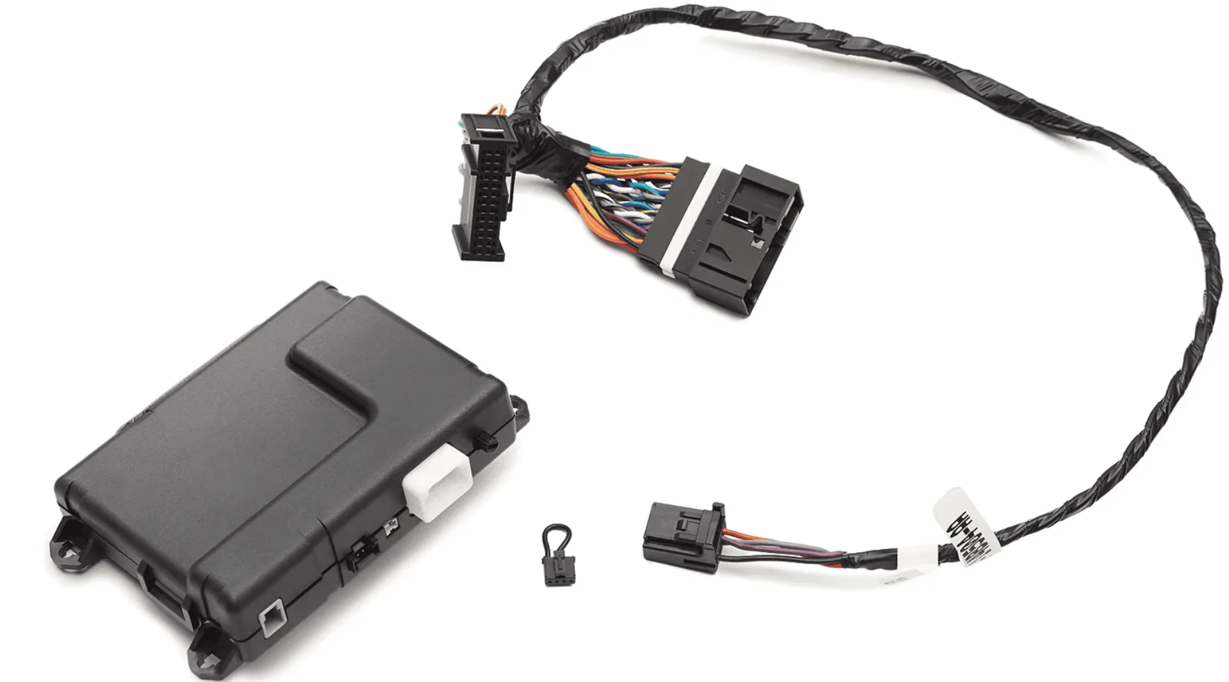

I don't remember if I installed the jumper cable it comes with, but the remote start works like before on my 22 OBX.

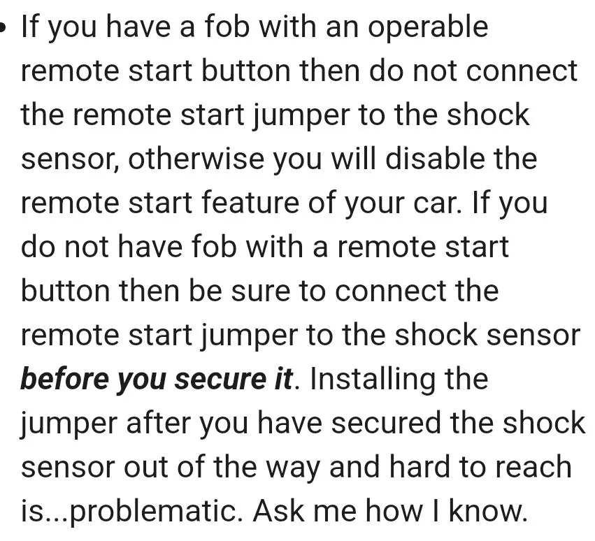

I installed one of these systems in my Bronco Raptor today but have yet to program it. The above had me wondering...I already had remote start via my key fobs. Does the PP module act as a gateway that removes that feature unless I now program it to work and install the jumper? Just wondering before I learn the hard way...

I had remote start before, and nothing changed. No need to reprogram etc.

Not sure if you ever figured this out, but just installed this in my Raptor and no need for the jumper. Installed, started it and let it run for a minute, shut it off and everything works as it should so far. Just may need to dial in the sensitivity a bit.

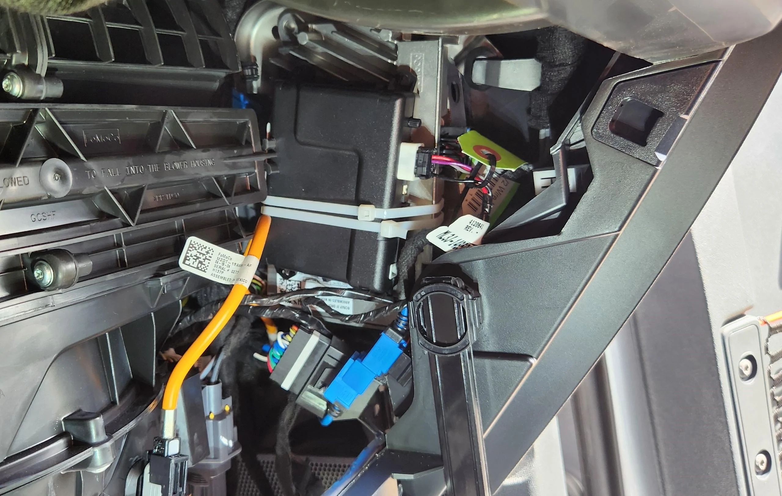

Fun getting at those existing module screws, eh?:)

Yeah I tried getting that back one out for about 10 minutes and then thought about what I was doing because I cut my hand and was extremely annoyed. Only reason to take that out was to zip tie the new one on top of it. I got that bottom plug out pretty easy so instead of using zip ties I noted the contact points when I put the new one on top of the existing unit and then took some double sided gorilla tape and stuck it on. This also allowed me to have quick access to the sensitivity dial and easily install the light when it comes in. So far so good!

Wow. I could not get that bottom plug off without pulling the module off, kudos.
