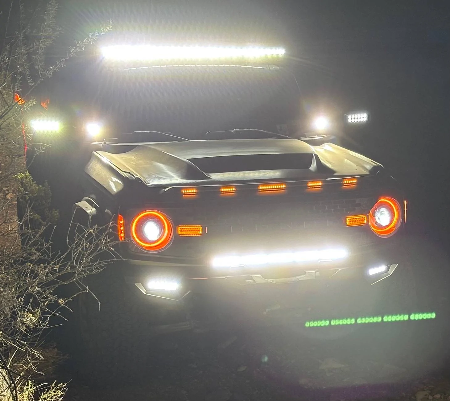

His sounded issue like a low battery SOC issue “sometimes it acts up when I start driving, but by the time I get to my destination, everything is working normally again.”
I’ve had mine since they were released, no problems, and plenty bright and headlights, I’m not impressed with the bright effectiveness on the highway but I have driving lights to supplement when needed.
Ford Bronco Passenger-Side Oracle Oculus Headlight Acting Up — Intermittent Issues IMG_0506
And their side and front markers certainly add some pop.
