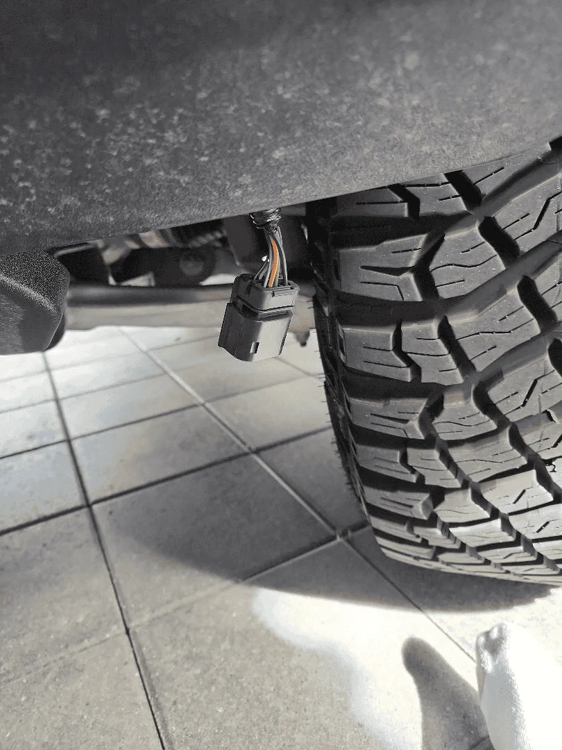

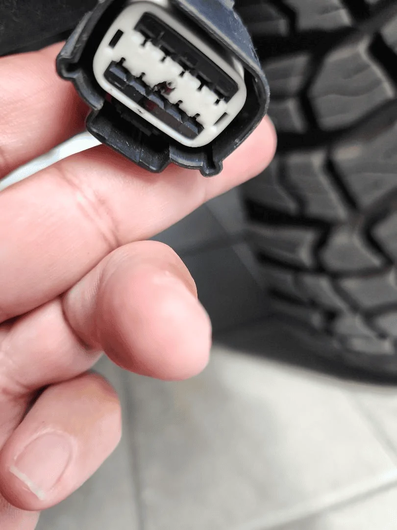

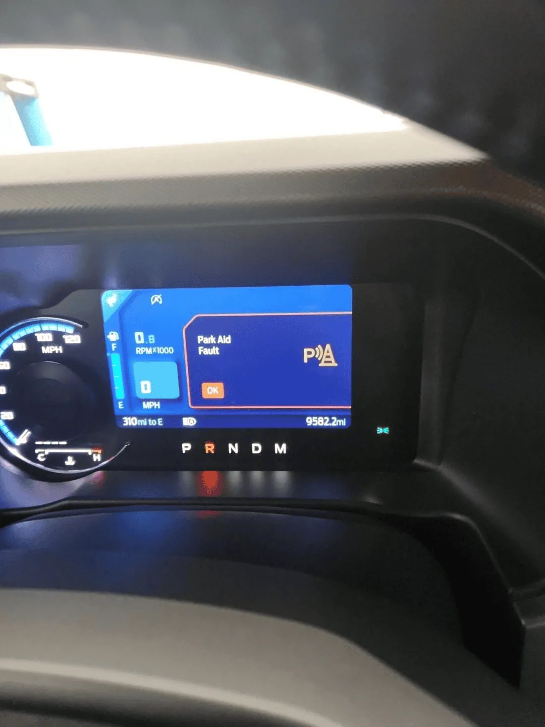

Just had a light pop up on my dash..."Park Aid Fault." Never saw this before. I look under drivers side and there is a plug hanging under the bumper. I have attached pictures to show the plug and error message. I have no idea where this plug needs to go.
Any help is appreciated.

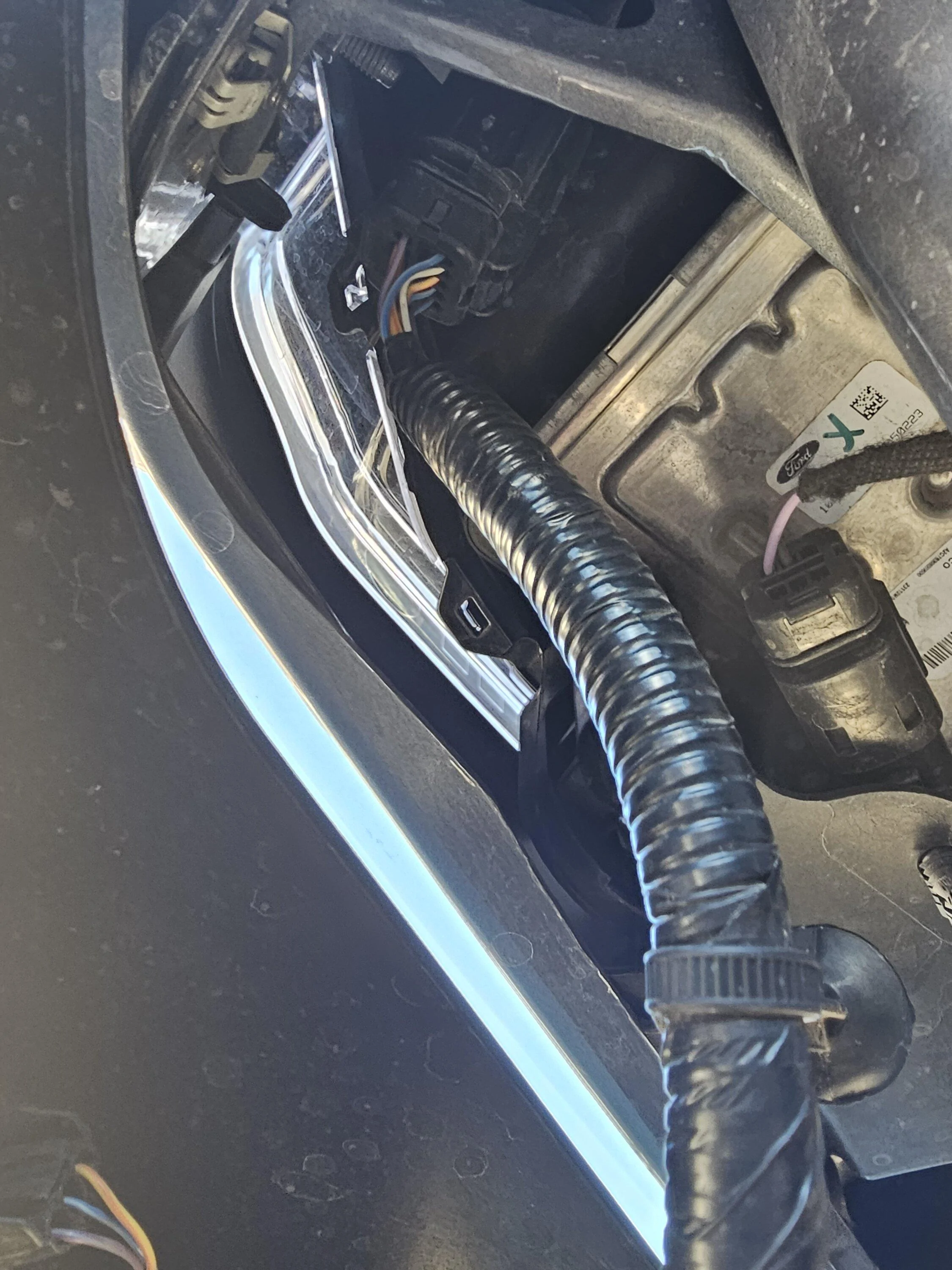

Look up behind the bumper towards the back of the head light, thats he connector for parking sensors , fog lights etc....
