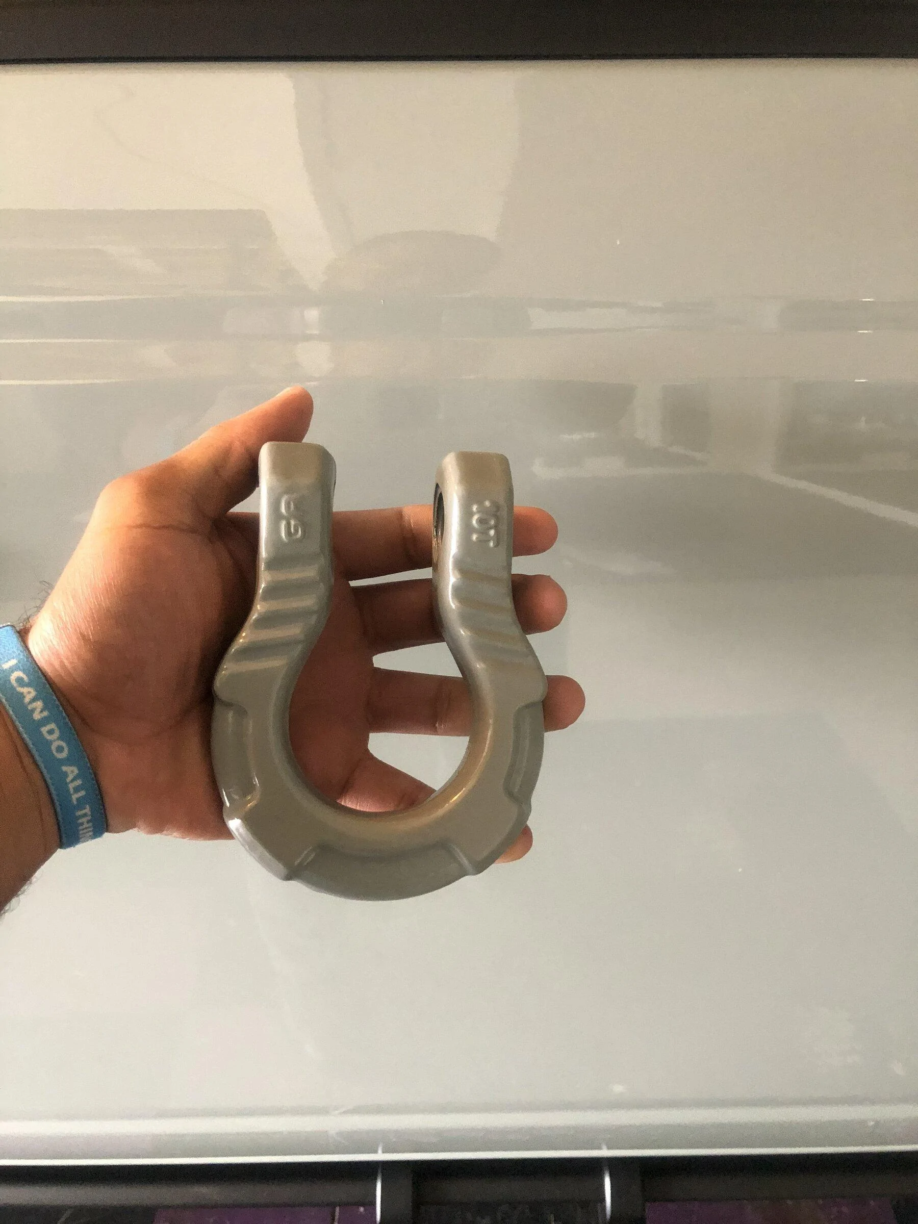

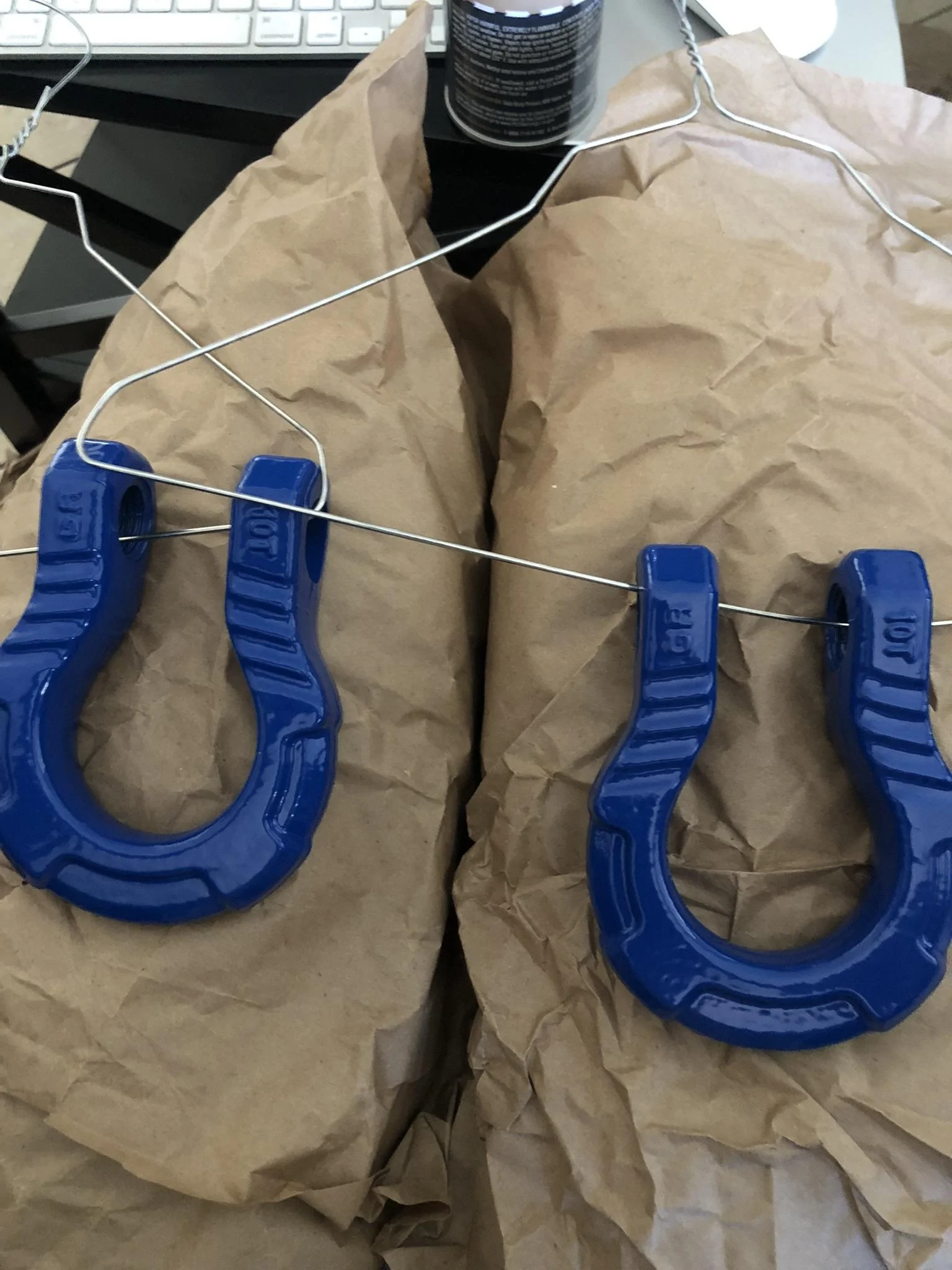

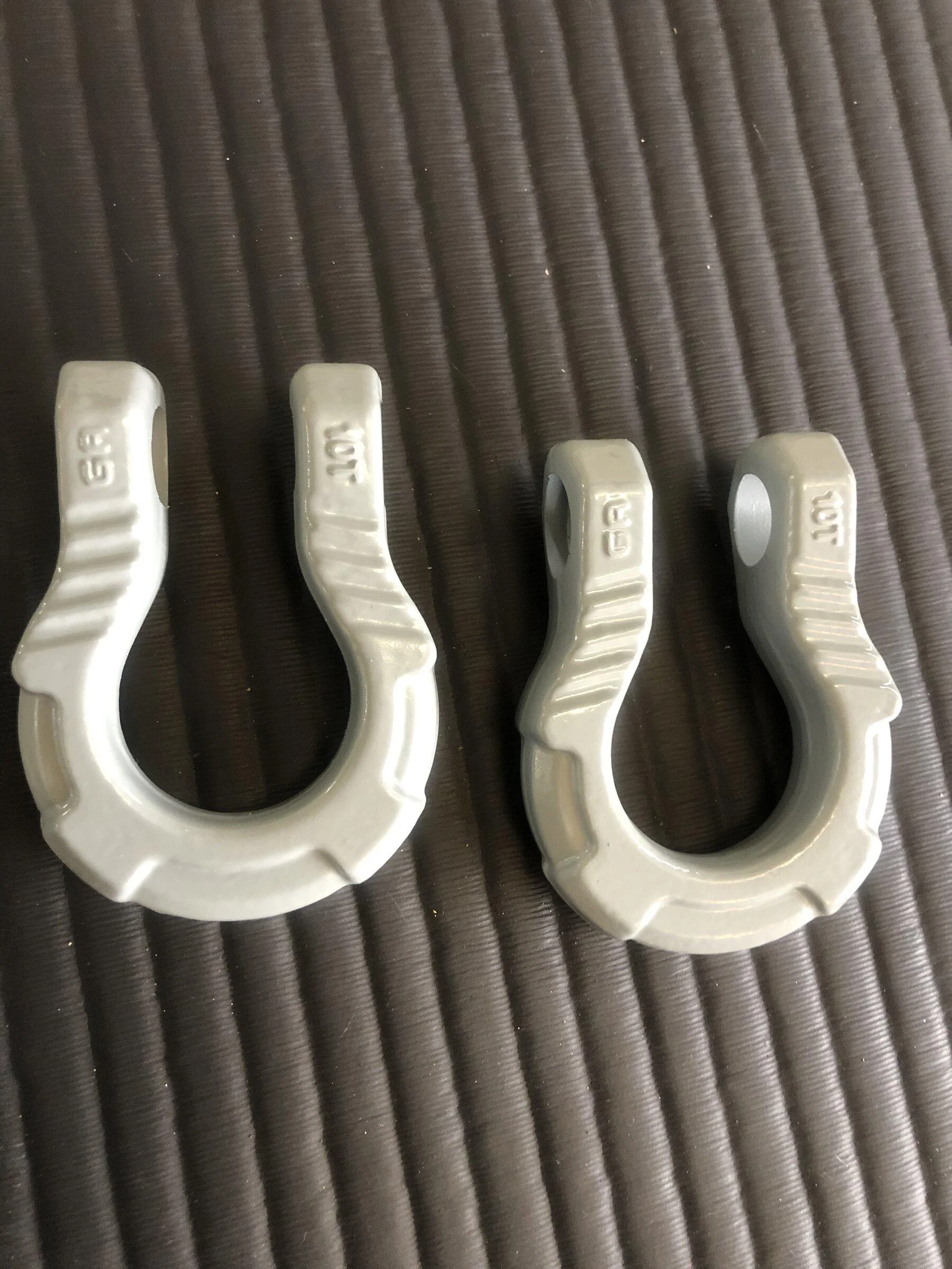

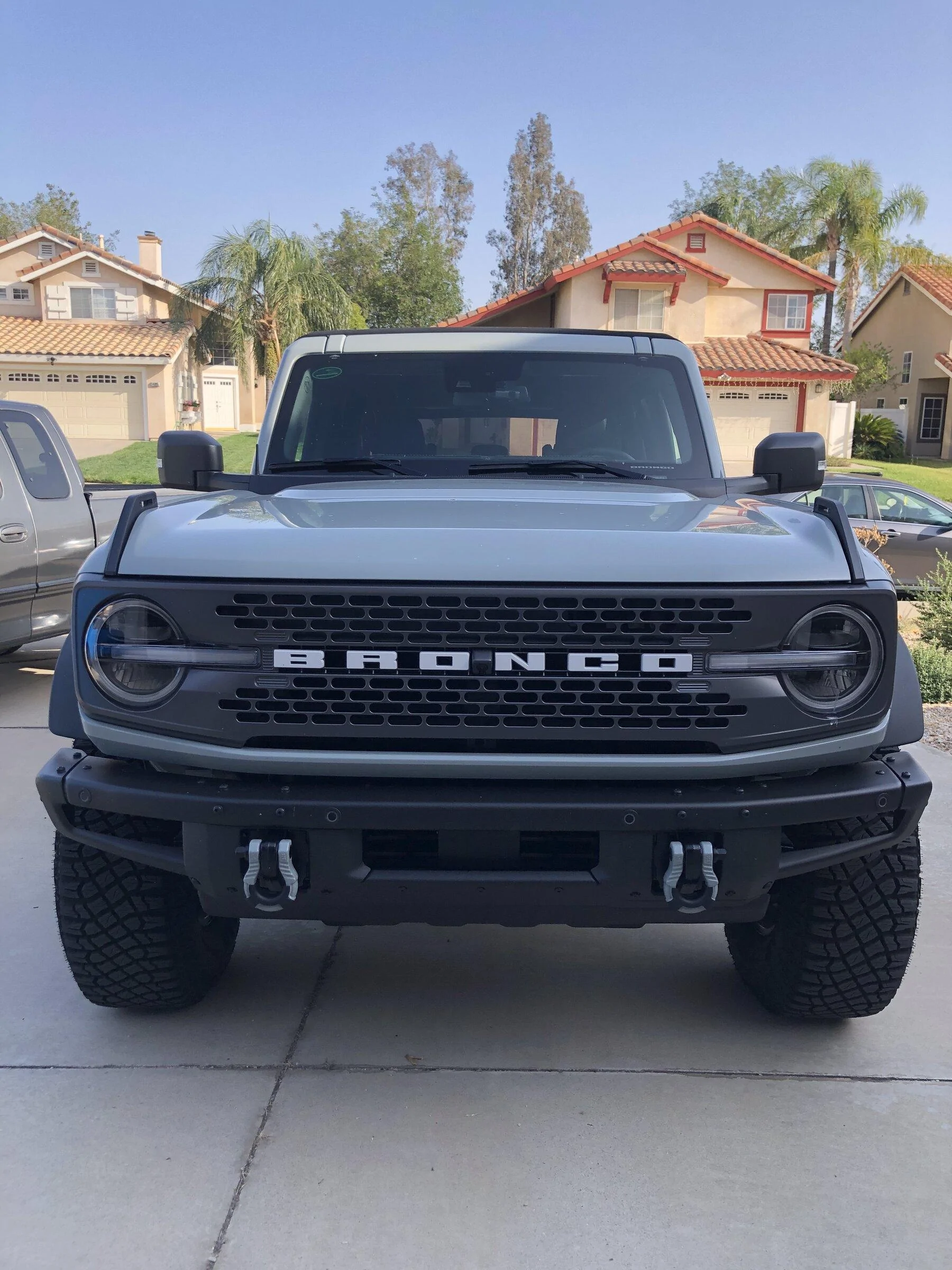

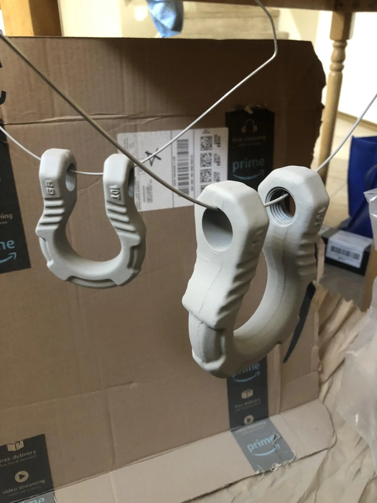

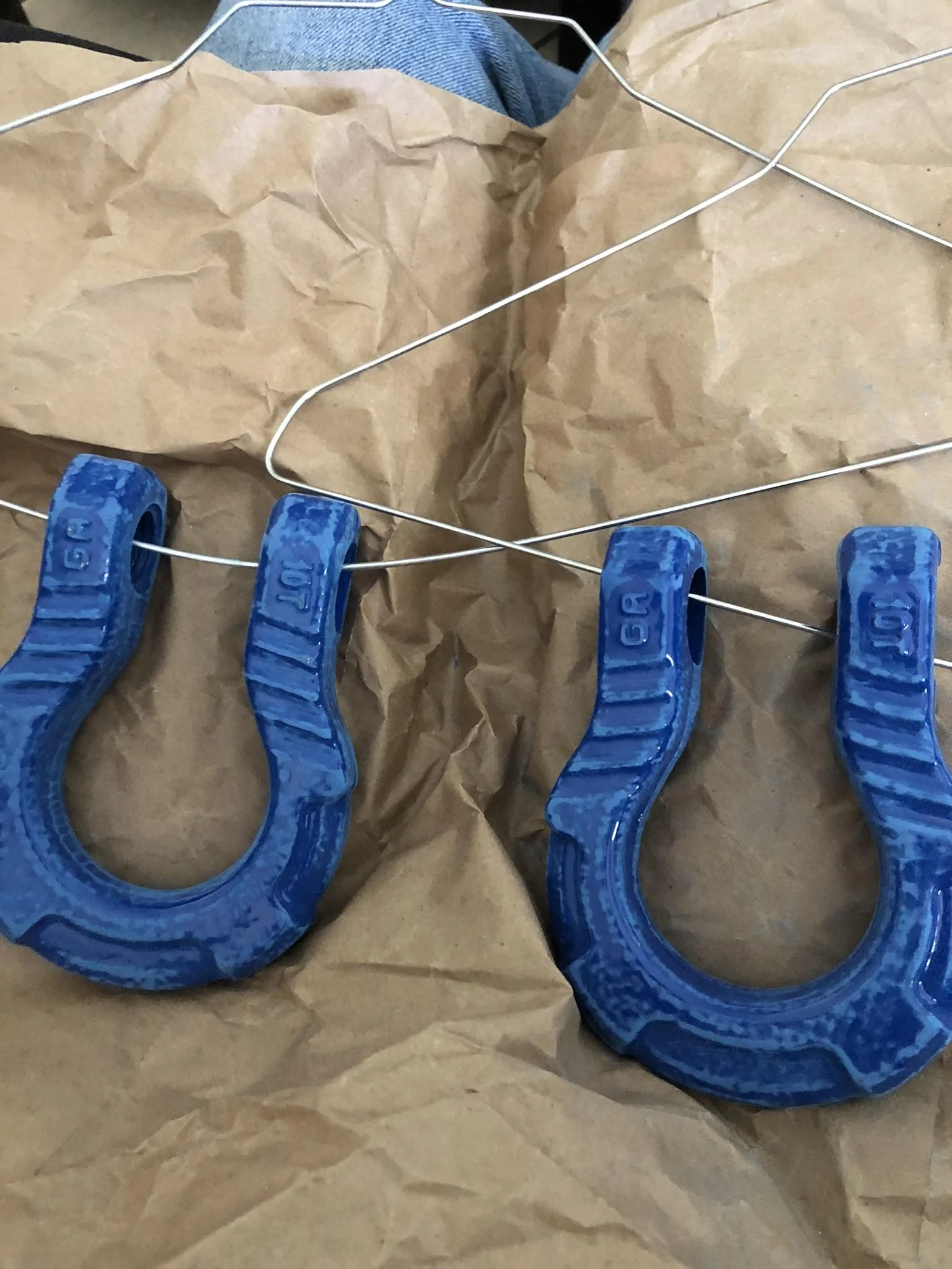

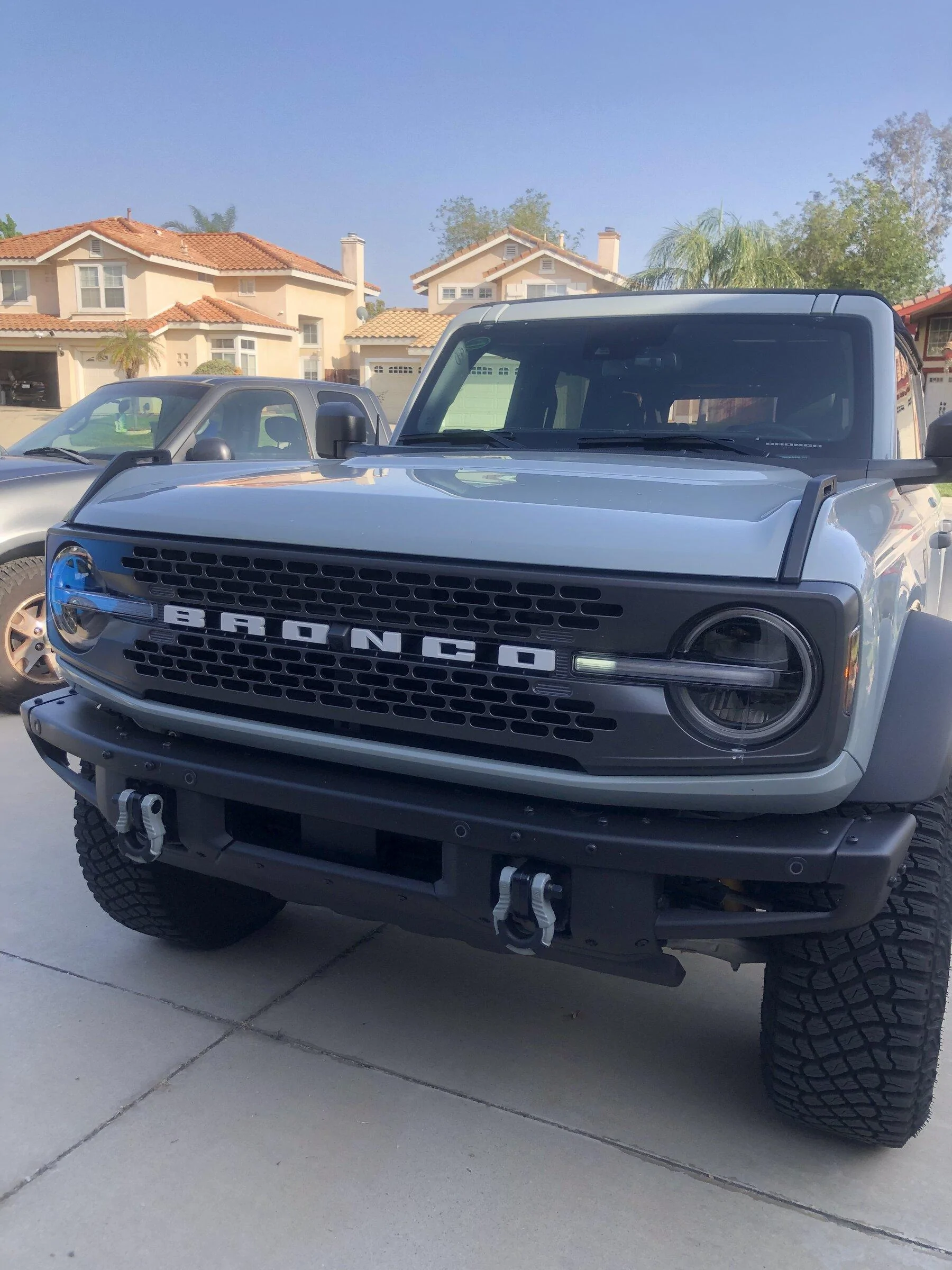

I painted my Uber shackles Body color on Sunday. Just thought I’d share. I’m a first time DIYer when it comes to paint. But this process was simple enough and worked out.
- scuffed with 320 grit sandpaper
- cleaned with soap and water then prep solvent
- primered
- light wet sand with 600 grit
- base coat
- glass coat
- installed
