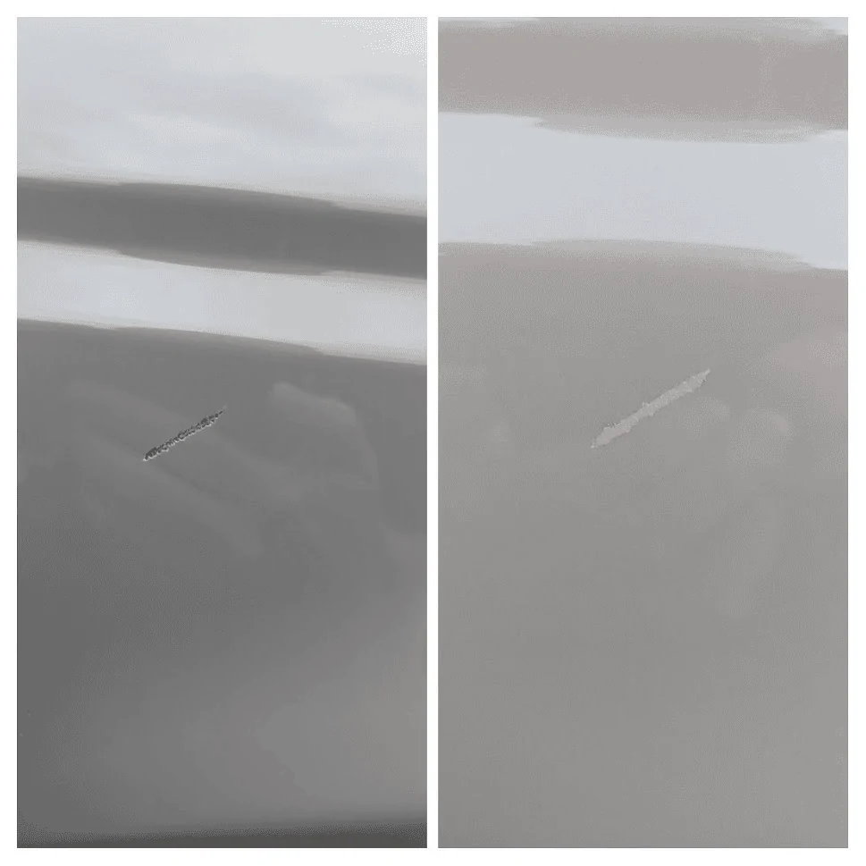

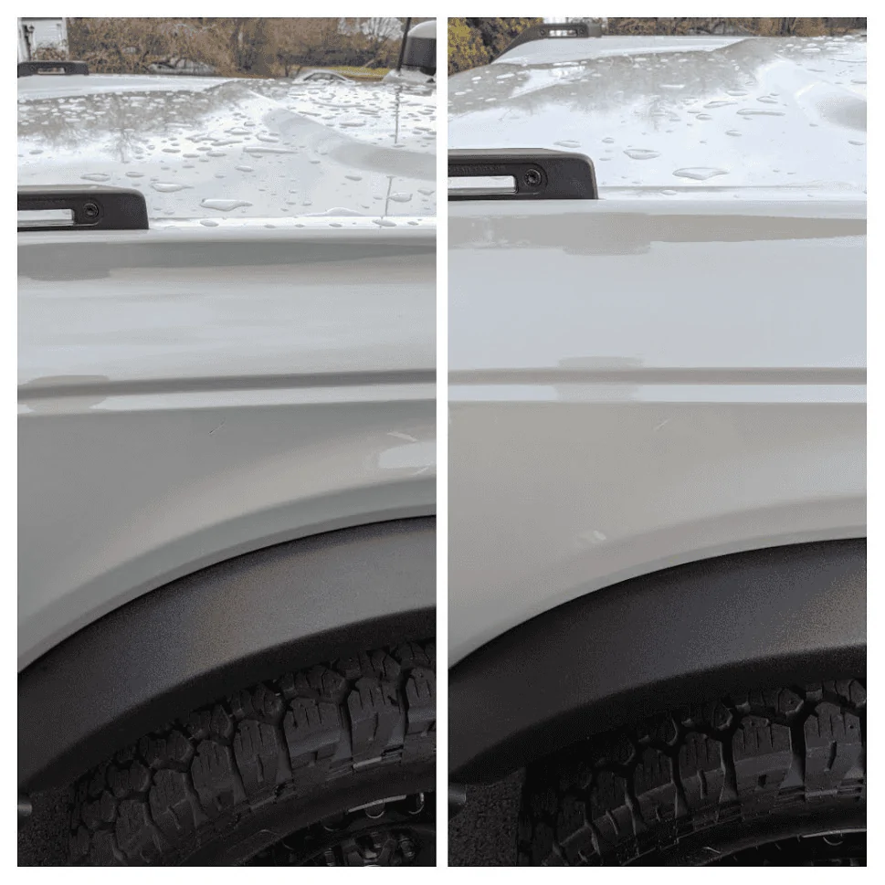

For anyone that cares... here are my results. Not exactly as I had hoped. But at least there isn't bare metal anymore. I went with Dr. Colorchip.

Fwiw, I don't even notice it anymore. Have to actually look for it to see it.
That was with Dr colorchip.
