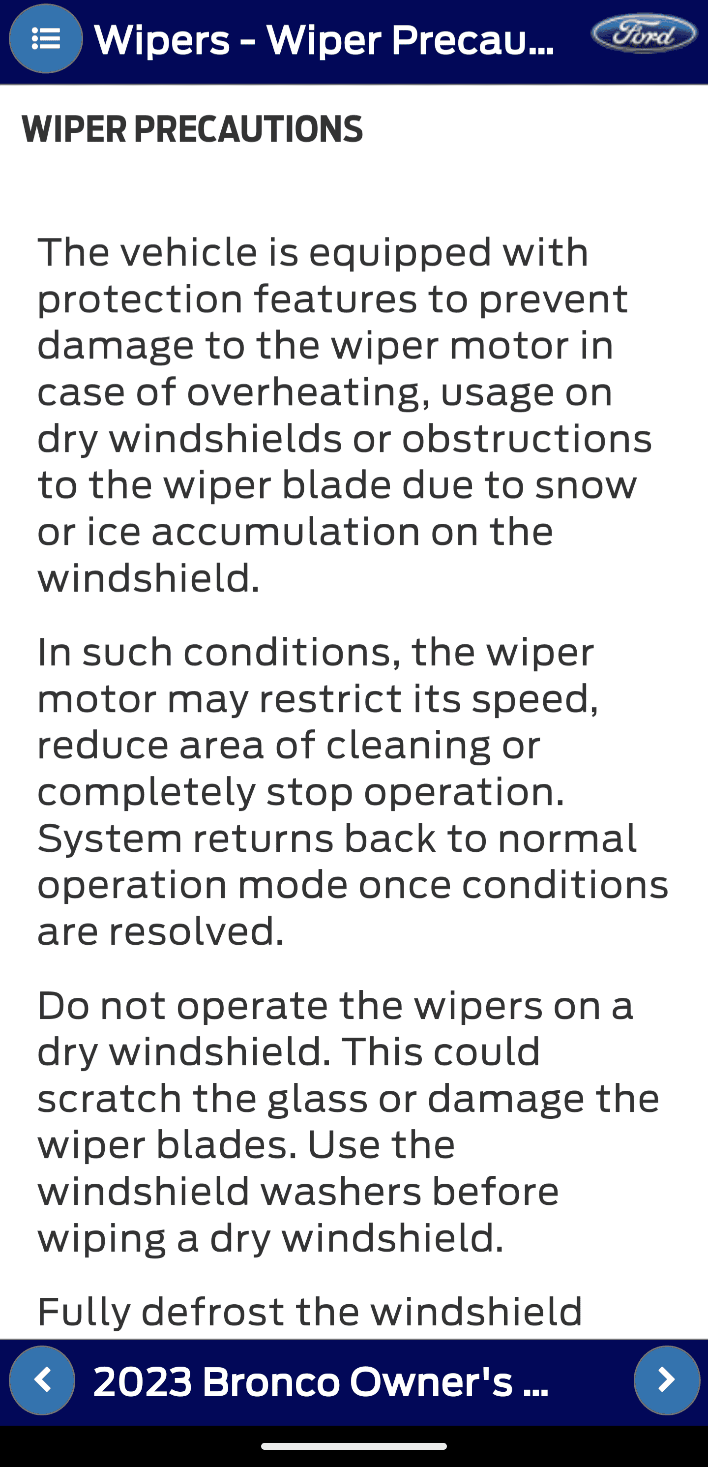

I've never noticed any 'intelligence' to my wipers - they're either on or off. I have a Luxe trim - so I'd think I'd have them.
We all have the stupid Advanced Wipers and I have experienced the issue. When you are in heavy rain with the wipers on high they will just switch to intermittent on their own, which is stupid and dangerous. You have to toggle them off high to get them to work. I am glad that is finally fixed. I just had my software update yesterday, so fingers crossed that it works
