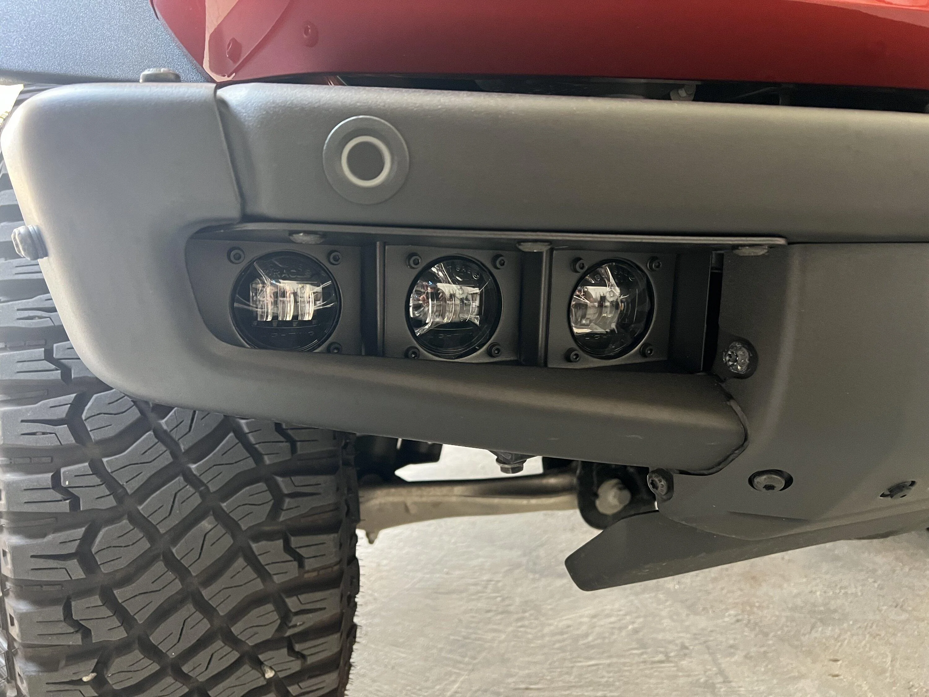

I did mine using the aux switches on my modular bumper:
Ford Bronco Oracle Fog Light kit wiring IMG_6400
