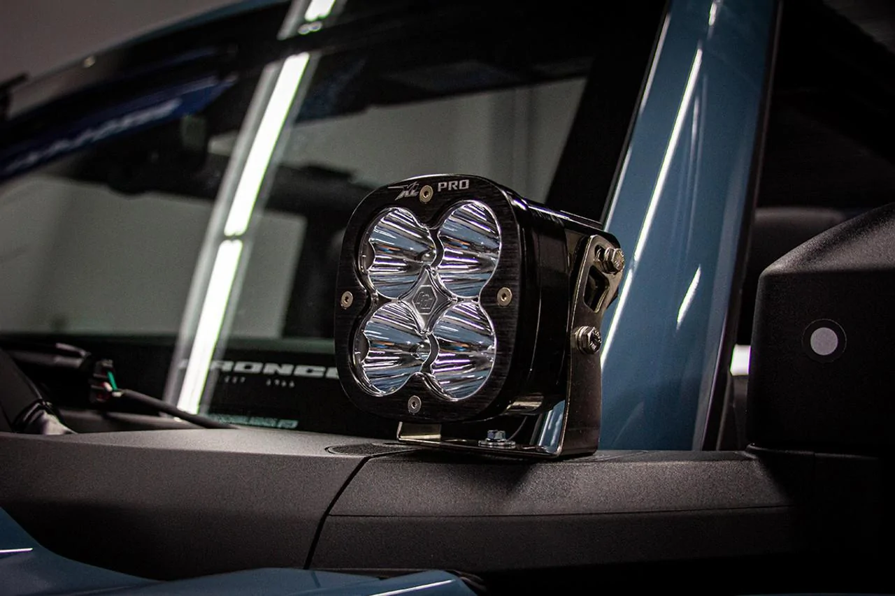

Ford Bronco Baja Designs A Pillar Light Kit 1673296792562
Here are also the Amp rating on the bronco. A single XL pro is 2.9 amps and for a pair 5.8 amps. You can get away with wiring them up to any switch no problem. The Upfitter is referring to the harness that connects to the aux on the vehicle instead of having to run a toggle switch into the cabin.
