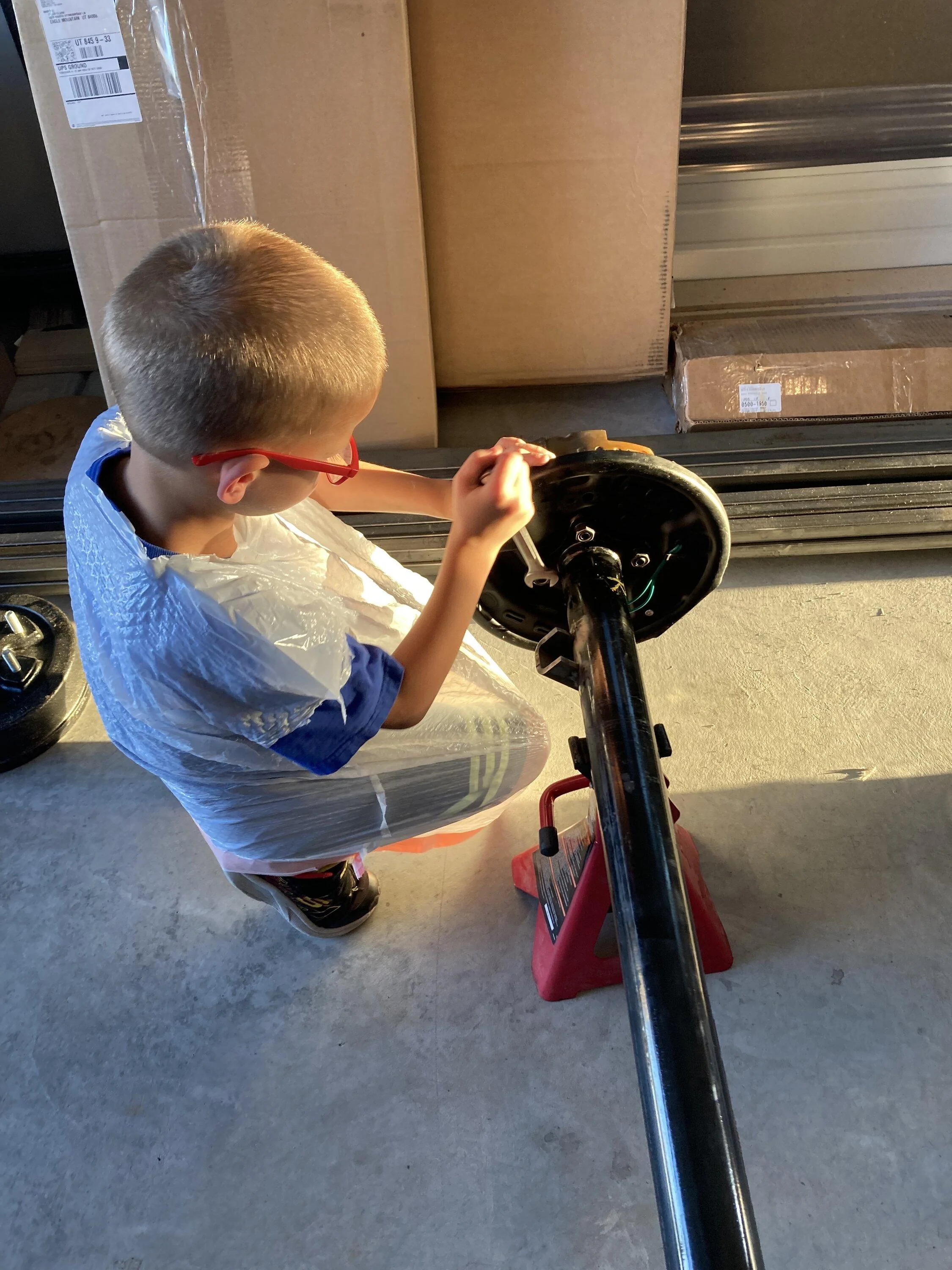

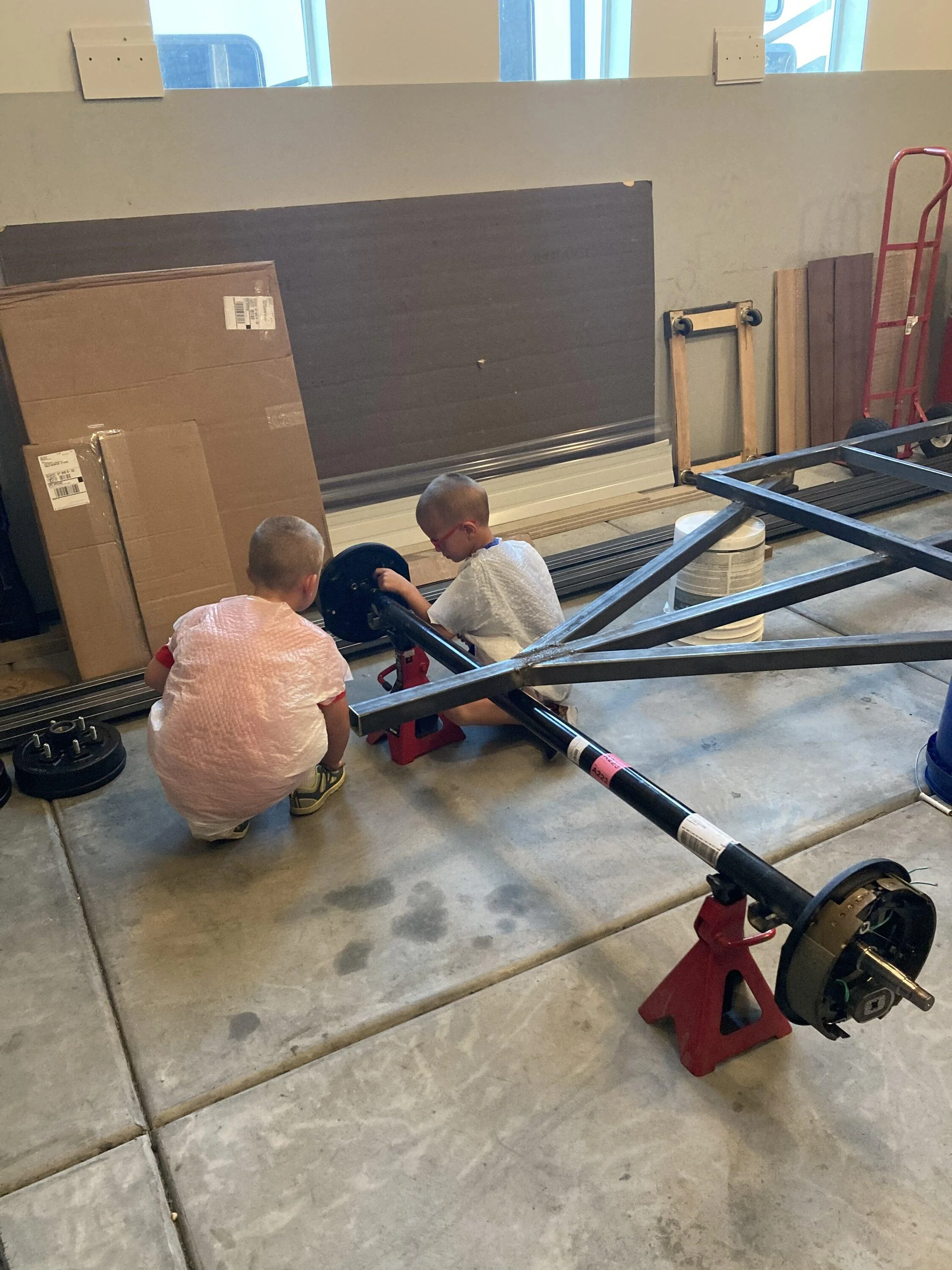

I have a total of five boys. Two of them are twins that are 7 years old. They wanted to help, so I had them help me pack the wheel bearing and put the brakes/hubs on the axle. I didn’t want them to get grease all over their cloths so I put garbage bags on them. It was a hoot having them help.
A list of my least favorite things to do: building fence, packing bearings, drum brakes. I will hire your boys.

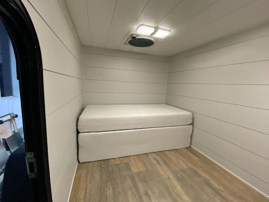

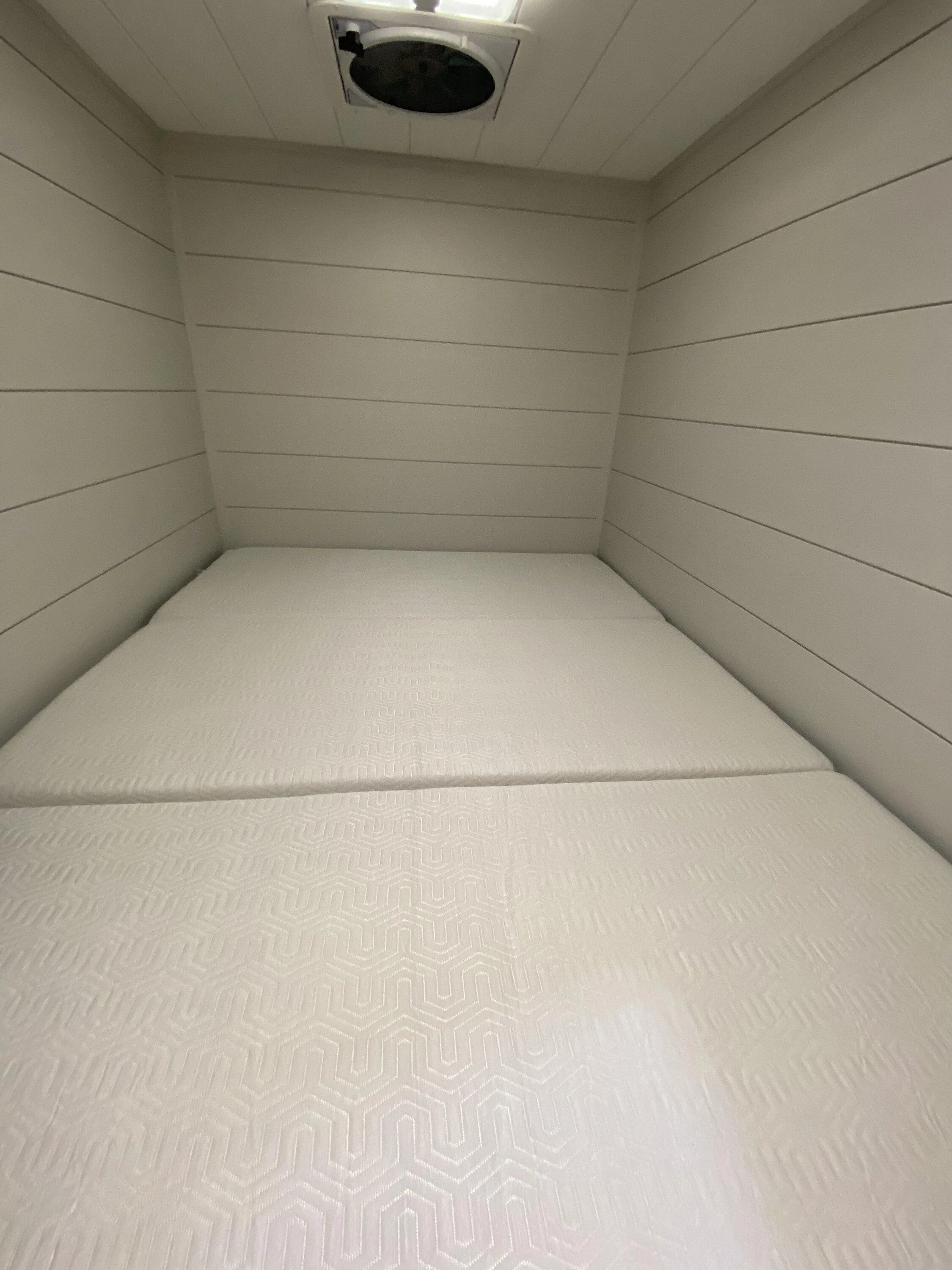

How does the bed work? You can't sleep traversely in a 5' wide trailer . . . Are there other bed pieces? Such nice work, clearly you enjoy building!
Ford Bronco Off-Road Trailer DIY Build Project Complete SmartSelect_20231109_221804_Chrom
EMBronco
EMBronco
Tyler
Oct 11, 2021
248
738
Eagle Mountain, UT
F250
It’s a tri-fold mattress. It can fold up to sit on or just give more room to haul stuff in the trailer. Here’s a pic with it folded out.
