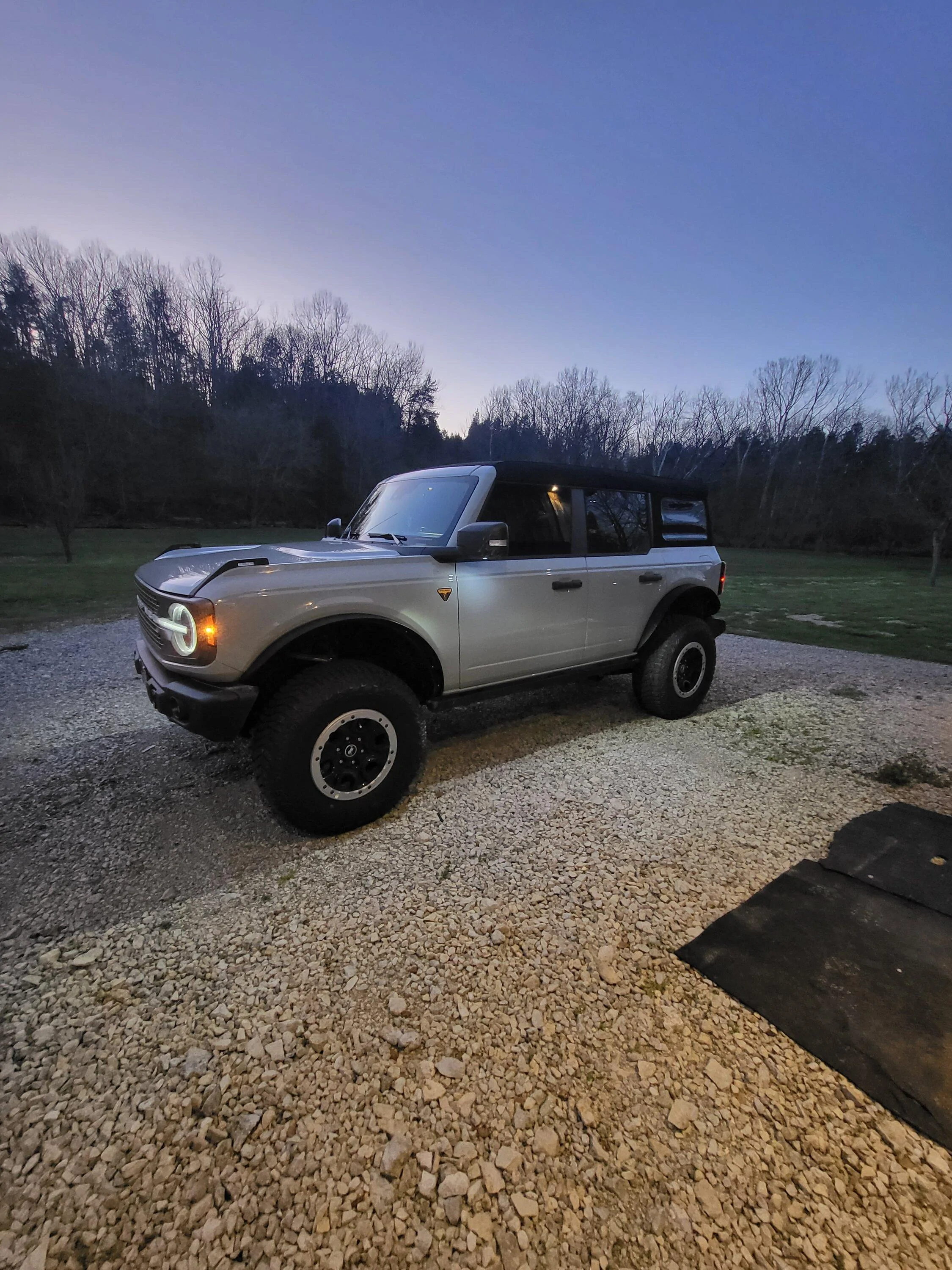

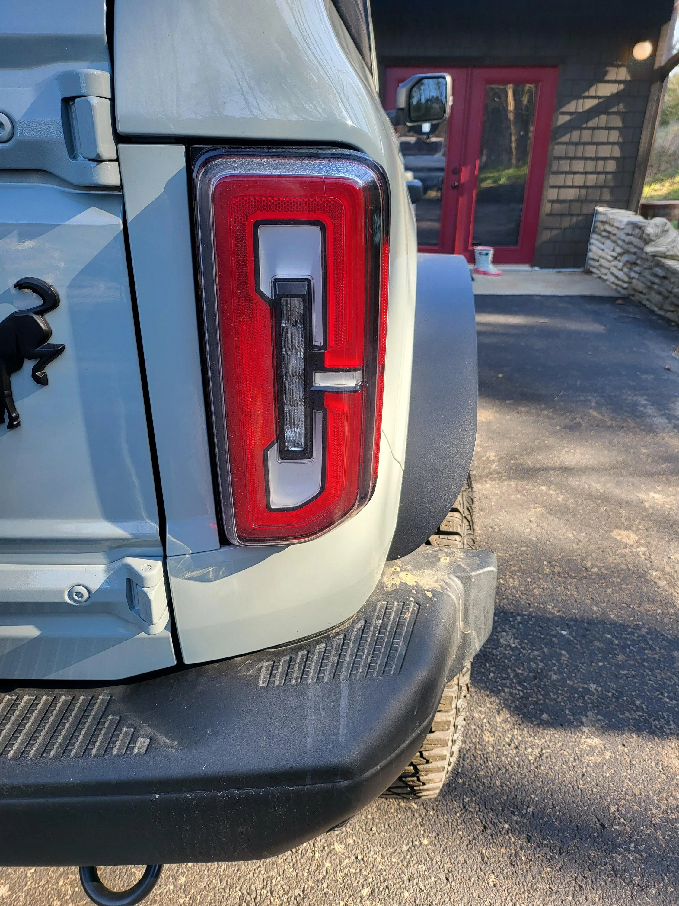

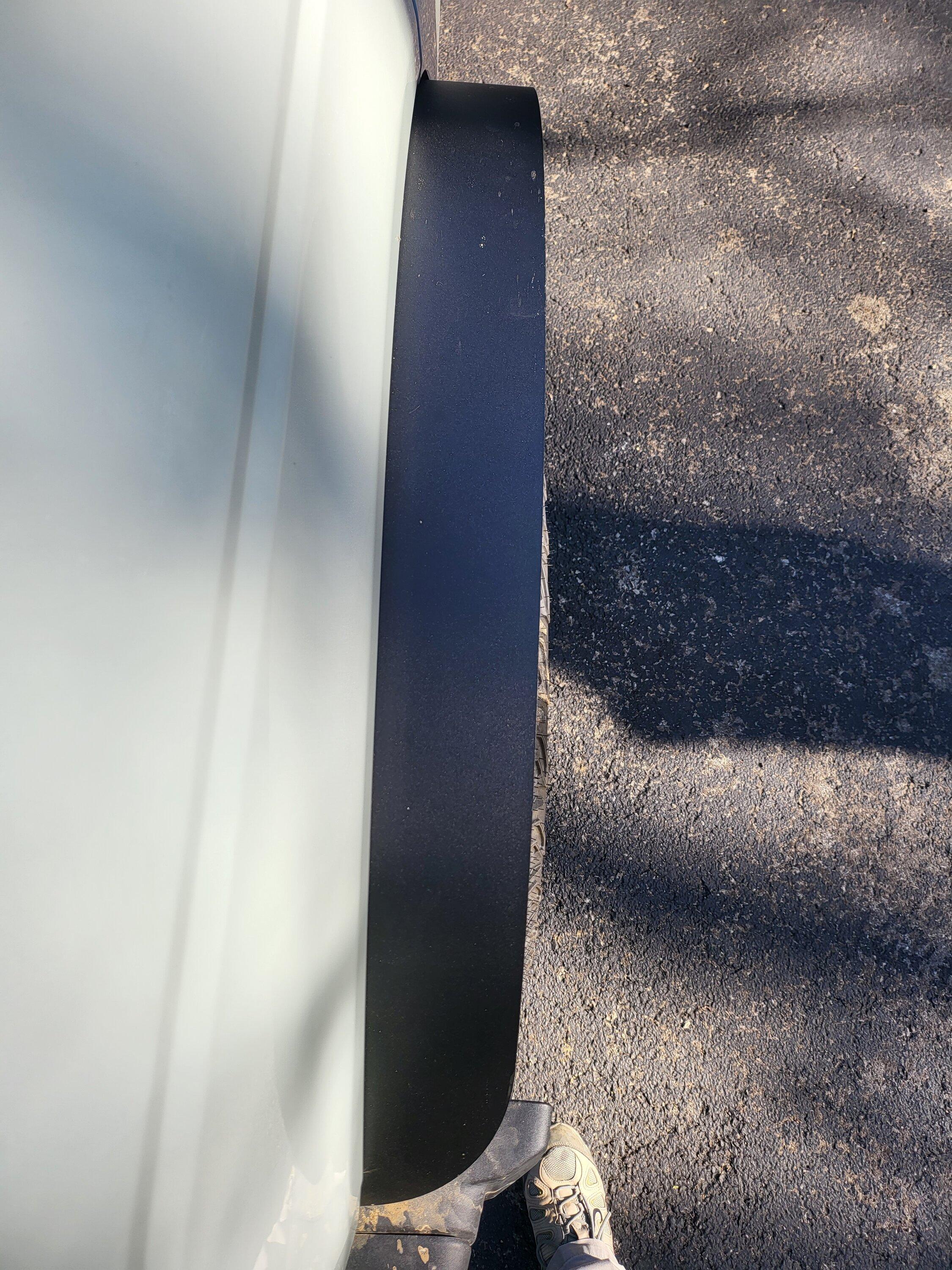

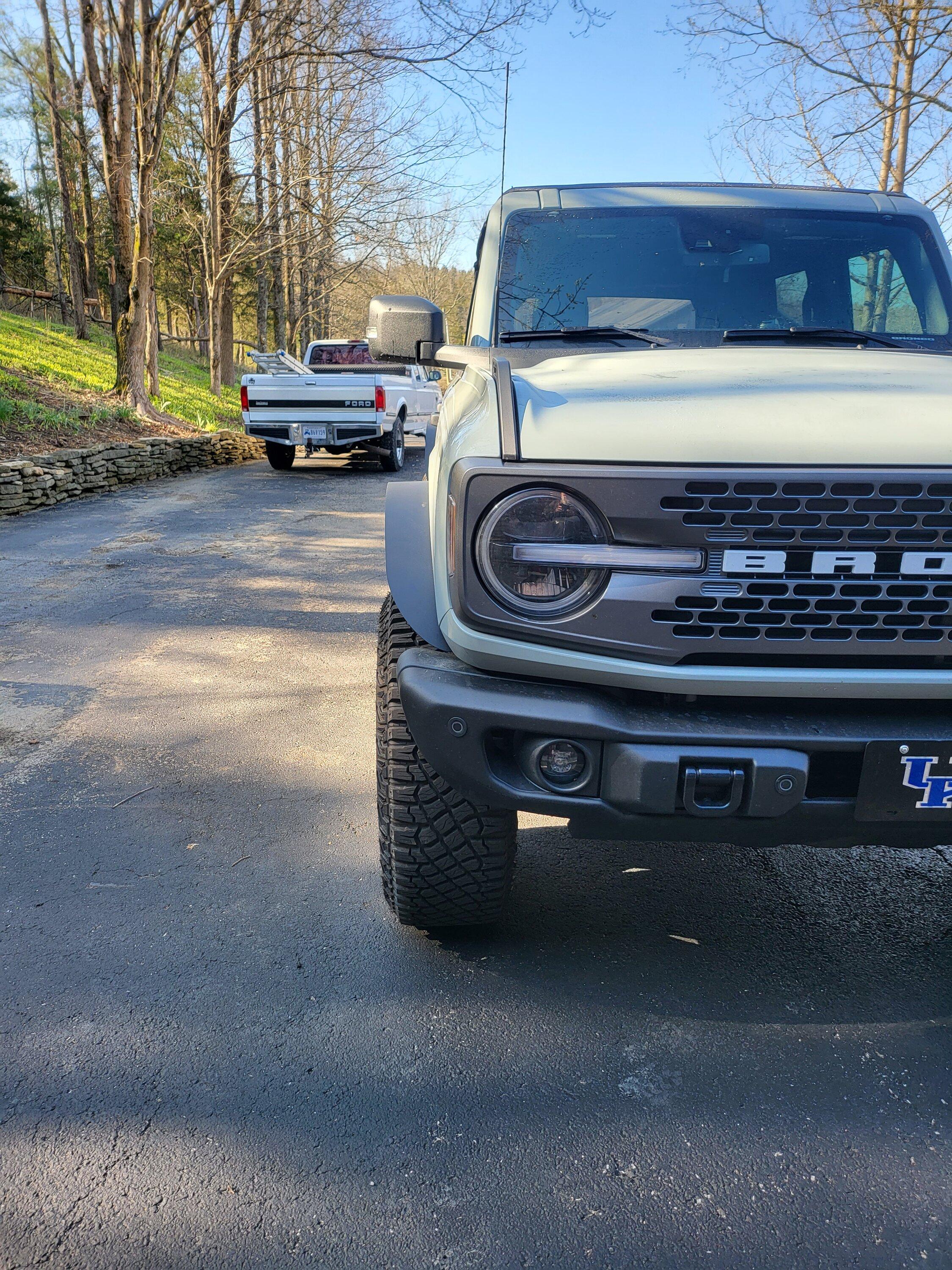

I wanted these, I don't know why - but I'm digging them. $169 worth try. Fit and finish was fine.
No one will steal them I guess and they won't crack - but if they take a real hit, sheetmetal will suffer. But that kind of hit - plastic ones will only serve as an early warning device.

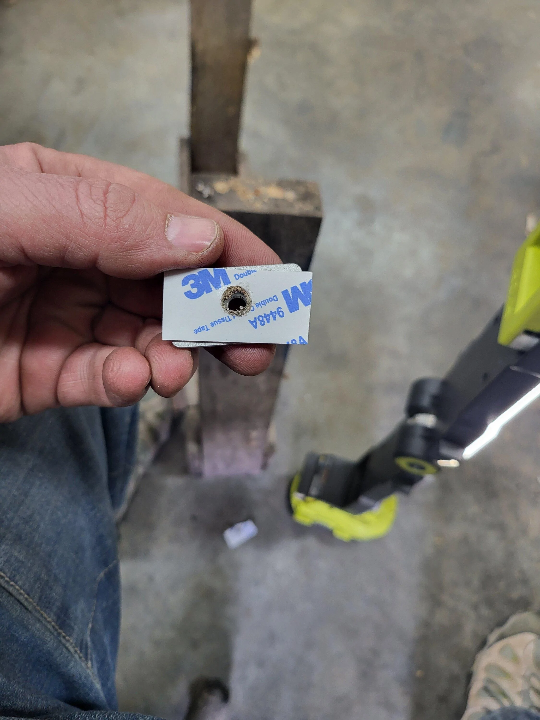

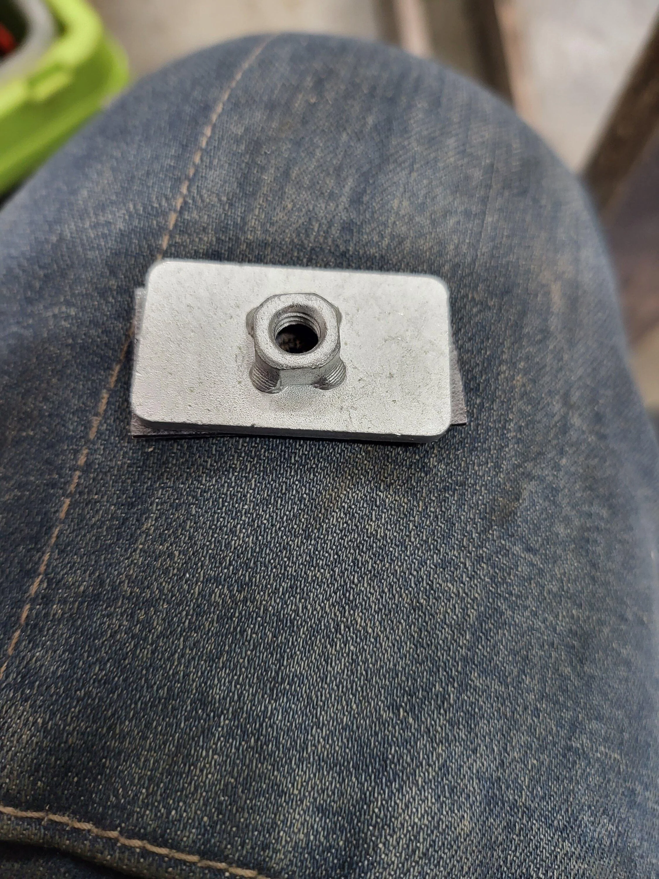

I didn't like that they screw on and the nut plate had to be held (above fender liners) so if you wanted to remove, PITA.
I added 3M adhesive pads behind the plates, we'll see if that works long term. Rear was mostly affixed via factory threaded holes.

Look much better than oem and for $169...but I still see myself using the quick removal feature of oem for wheeling tight rock garden, etc...someday...

Thanks!
Yes, giving up the quick removal was the tough part for sure.

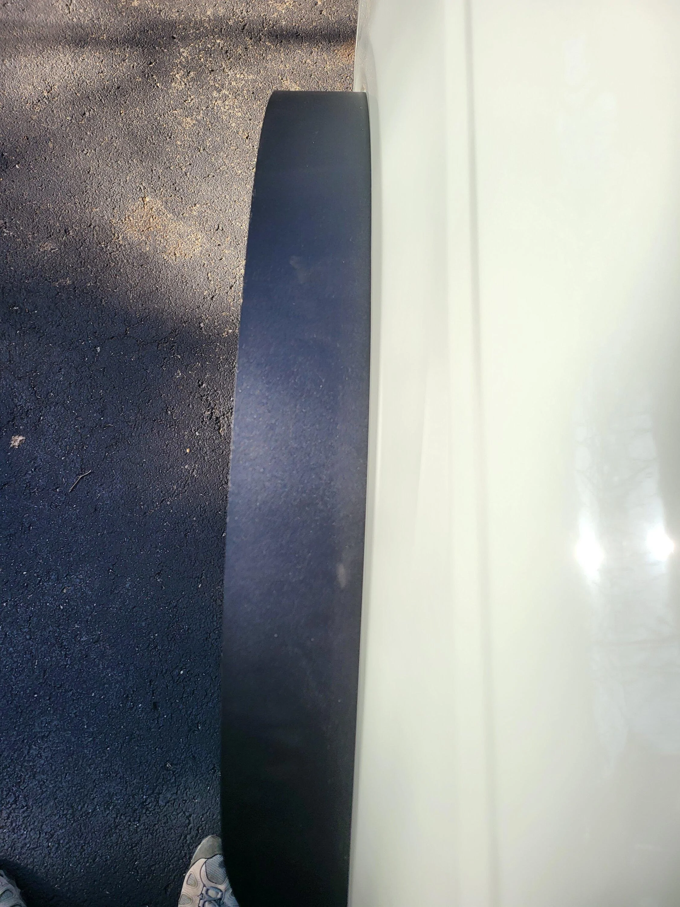

got any more pics...how far do these stick out?

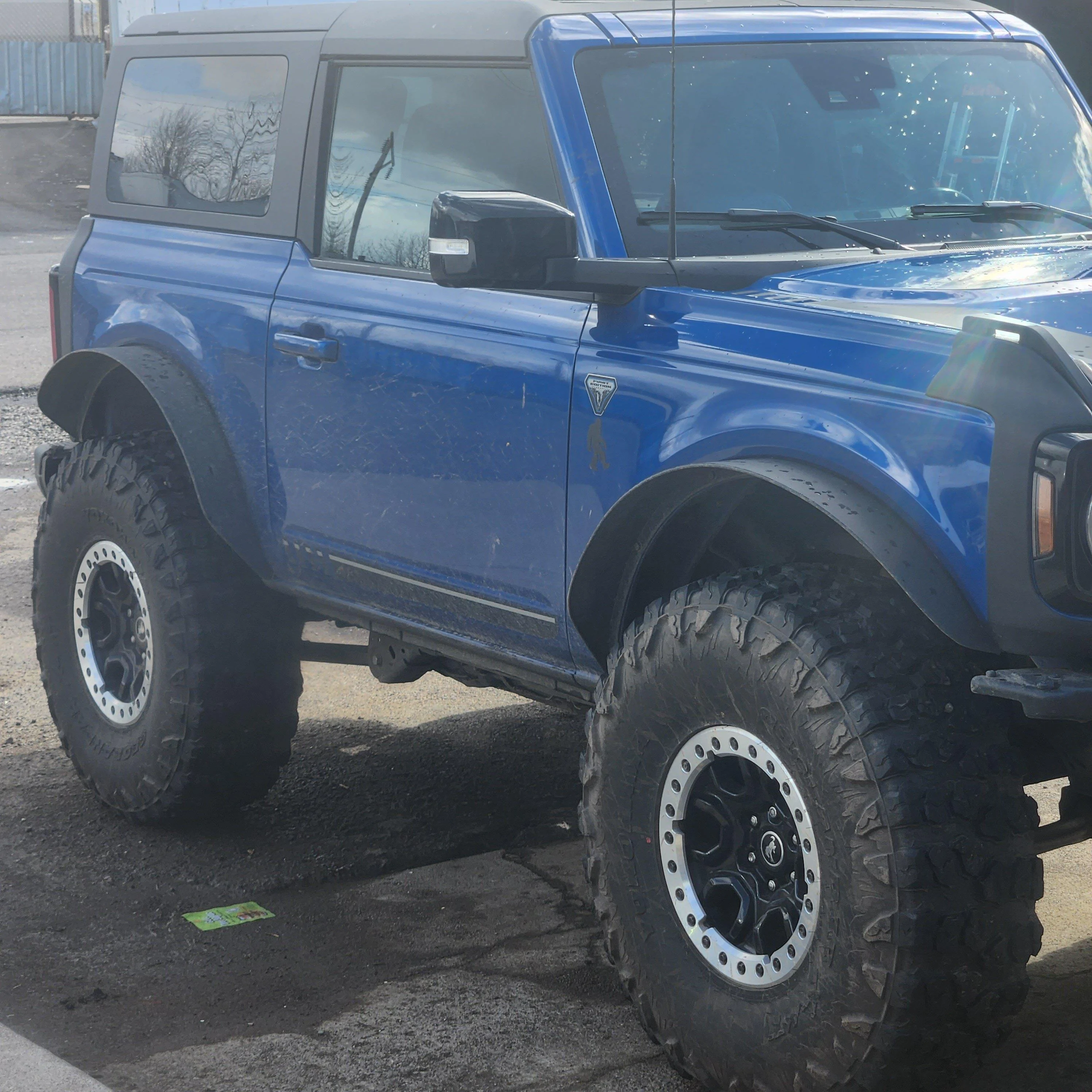

they look identical to the ones I have from Ford parts....but way less money!
