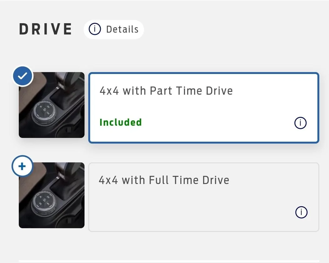

So, is the difference really only the part-time vs full time 4x4 drive?
Ford Bronco OBX E5D0 vs E5B0? Screenshot_20230329_173323_Samsung Internet
Yup.
Did you make 2 identical orders to see which came in first? If so, they ain't identical.

Well, thank you for the clarity. I am interested in the 4.27 gears with the rear locker but didn't care much about the full time 4x4. Most of the Bronco's use will be on pavement. Would I be missing something I am not accounting for by not going with the full time 4x4?

The advanced transfer case has a lower gear ratio, 3.06:1 vs 2.72:1. Not sure of the advantages or disadvantages of the advanced over the std, maybe someone else will comment.
Standard: 4x4 with part-time selectable engagement – two-speed electronic shift-on-the-fly 2.72:1 low ratio
Optional: Advanced 4x4 with automatic on-demand 4H engagement – two-speed electromechanical transfer case 3.06:1 low ratio
Ya, the fact that it's the more durable transfer case.
