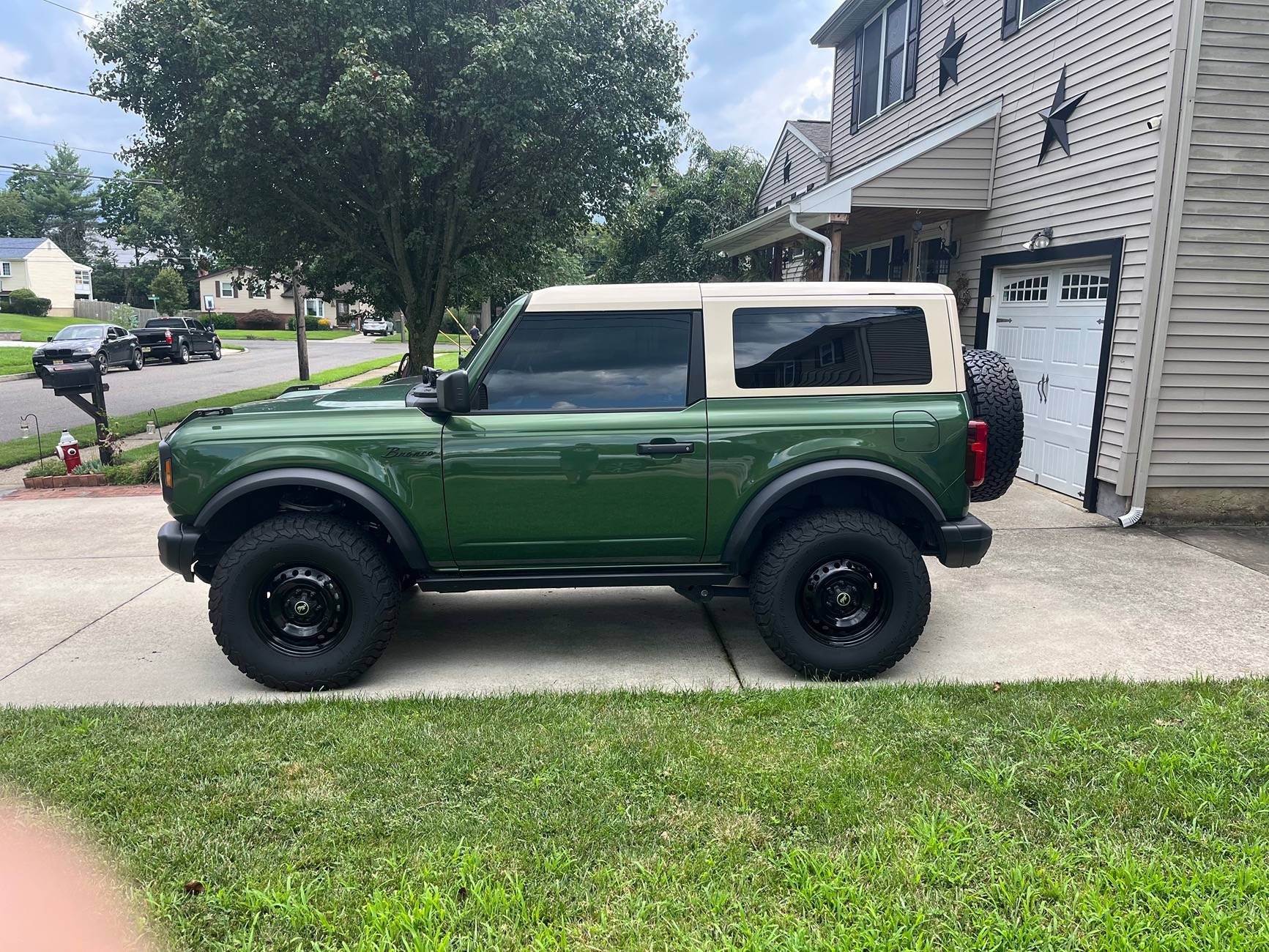

I purchased a 2022 non-sasquatch black diamond with the 2.7 engine. Absolutely love it. As most of us on here I wanted a little lift and larger tires. So on went the SVC 2” perch collars and BGG 285/75R17 on the stock rims. First observation with the collars was no more brake dive in the front end. Also noticed a stiffer ride. The added height from the lift and tires put me where I wanted to be.
As the miles added up and more off-road equipment was added I noticed the rear looks lower. About 1/2” -3/4” lover than the front ( measured from top to tire to flare and also ground to flare). I realized that the E rated BFG’s are stiffer so I lowered my tire pressure to 34 psi. Still seems stiff and speed bumps feel like the tire is “pushed” down as you ride over them.

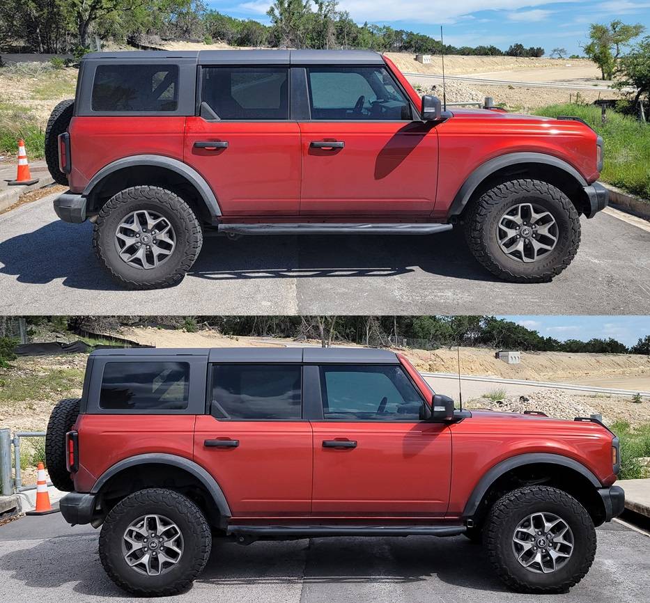

The problem is the E load tires, not the collars.
Regarding sag, did you install the big collar and the thin collar up front?
I only used the four thick collars.

SVC collars were all the same. After install it was perfect. Has now settled to a slight sag

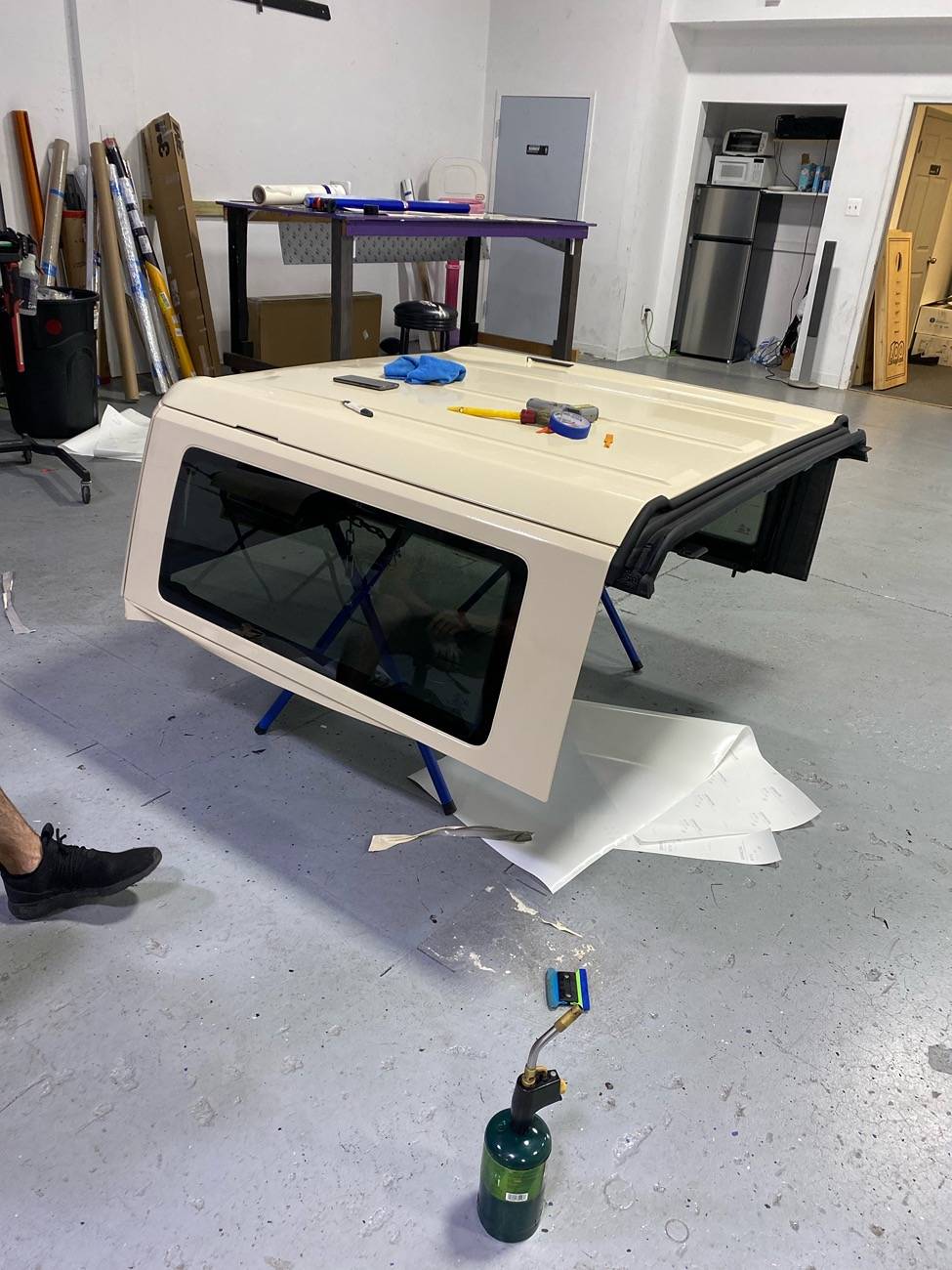

3m vinyl wrap. InstalledJune 2022. Holding up well so far
Interesting. Did you ever do a thread on it? Lots of folks think the top won't work with vinyl longer than a few months. I suspect once people get out of the 36m warranty and develop cracks/whatnot, applying vinyl might be the go to. Plus the people who want an alternate color.

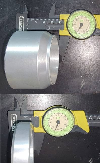

I see. At some point they started shipping 6 pieces to adjust for added weight on either end.

Rumbloki, thanks
that is correct. I spoke with them regarding my issue and they sent the add in spacer. However as I discovered and they confirmed those add ons were sasquatch only. I’m a non-sas so they were no help. They also indicated they do not make them nor are they planning to.
