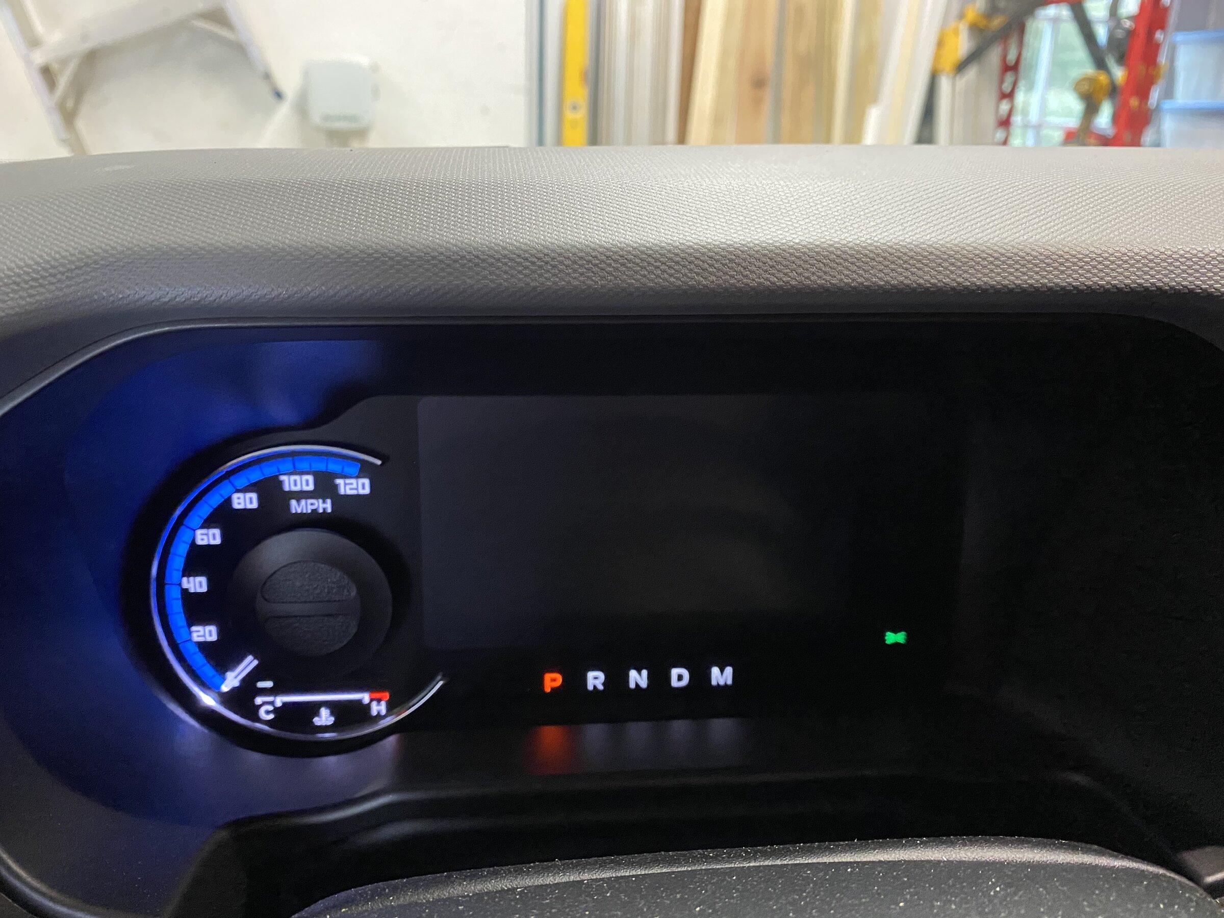

Just happened to me with my 2021 OBX. Drove it cross country this past weekend with no issues, and now - blank! Help!

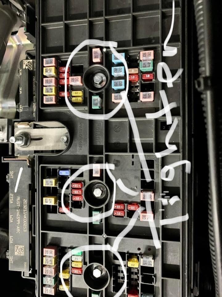

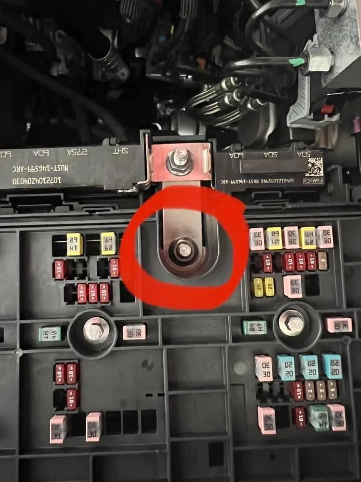

Just had this happen last night. Read the threads this morning and heard it reset as I loosened the negative cable. Tightened it down and all is well. Hope that’s not a harbinger of a progressive issue.
