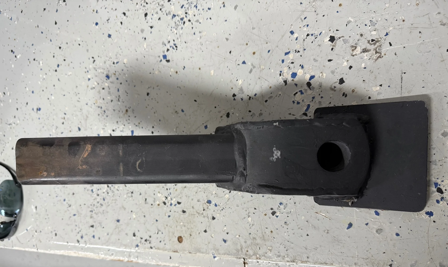

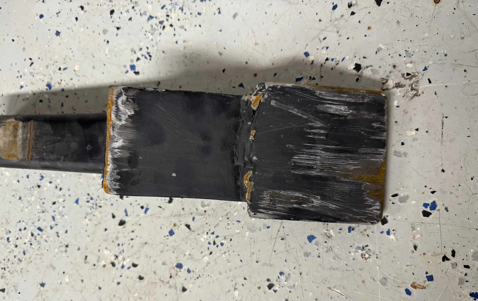

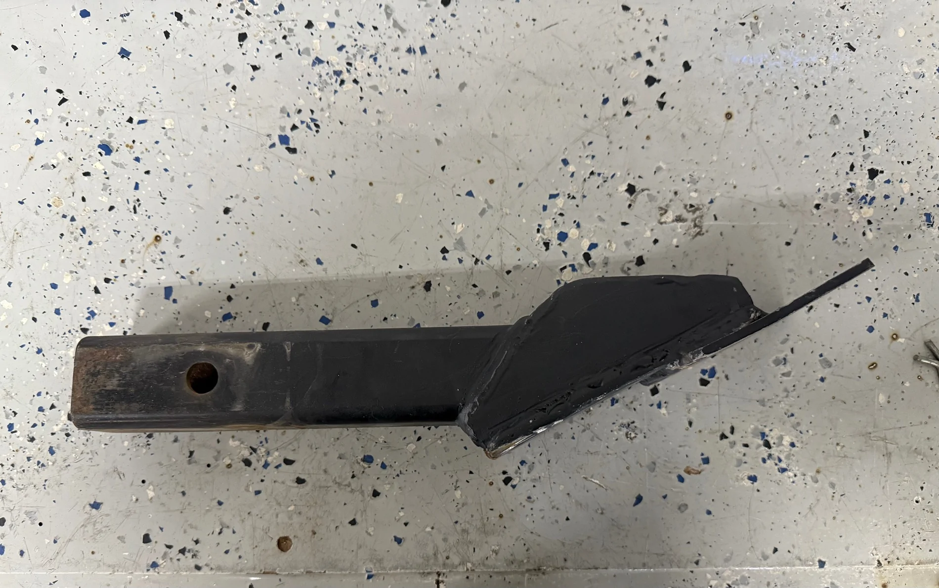

Good eyes. That’s exactly what it’s for. I’ve seen enough videos of Jeeps and Broncos damaging tailgates or in severe cases breaking the rear window. I don’t like to run without a spare so I needed to do something to protect the spare from strikes. Being well aware of the structural limitations of the factory hitch, I took a standard drop hitch, cut some 1/8” steel and went to work. My driving style is tortoise slow, so the hits are generally easy and not harsh.. It sticks out every so slightly past the spare. Served its purpose well. Just a few scrapes. No hard hits.
Thank you, you should patent that, very smart idea and saves your ass, I mean rear when you least expect it to! Well done sir 🍻

That's a great idea, surprised i haven't seen them sold before. On another note, I really miss Moab and watching these videos brings me back. Can't wait to make the trip out there again.

I'd be in for one!

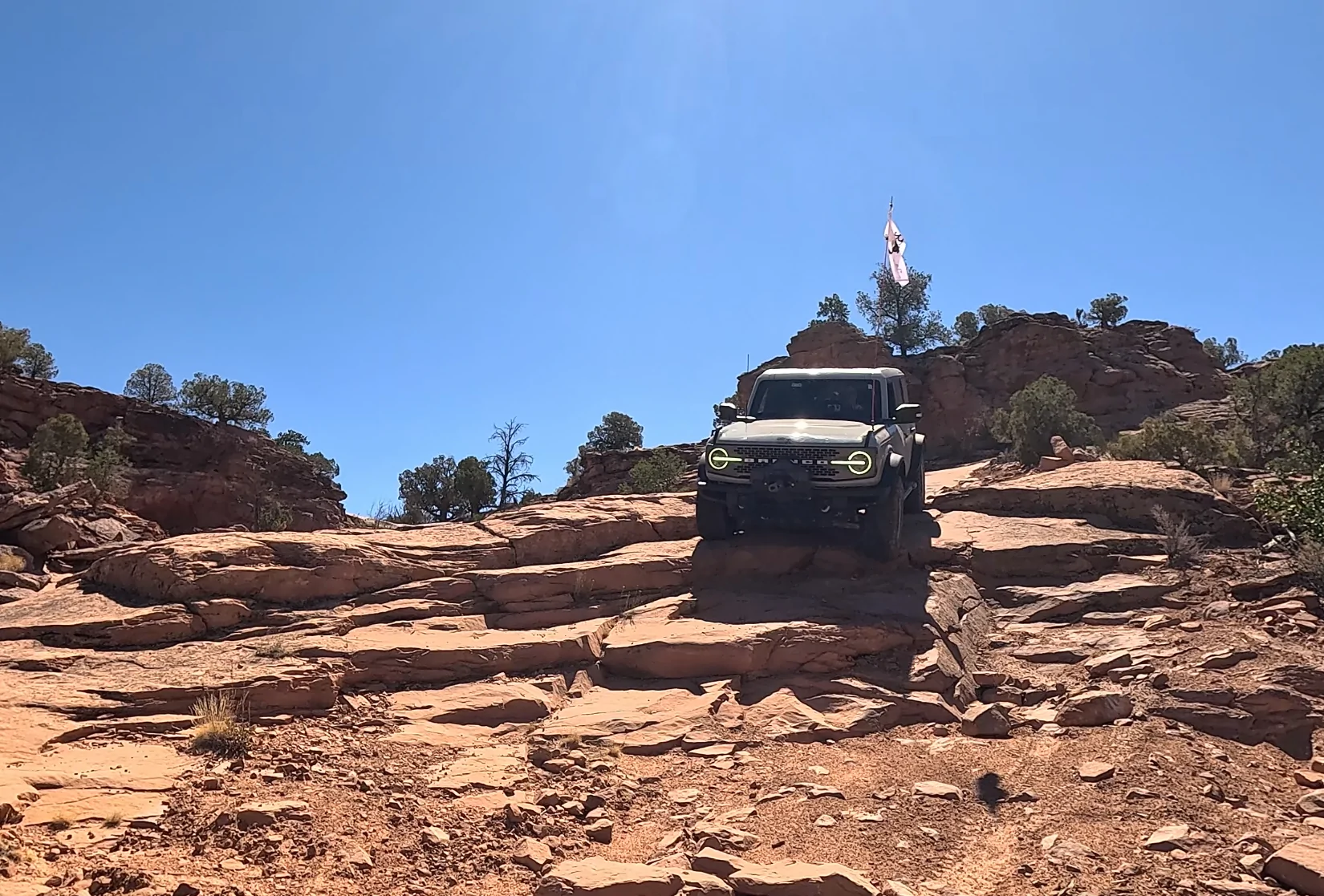

At the top I went left and climbed the buggy trail on Flat Iron Masa.
