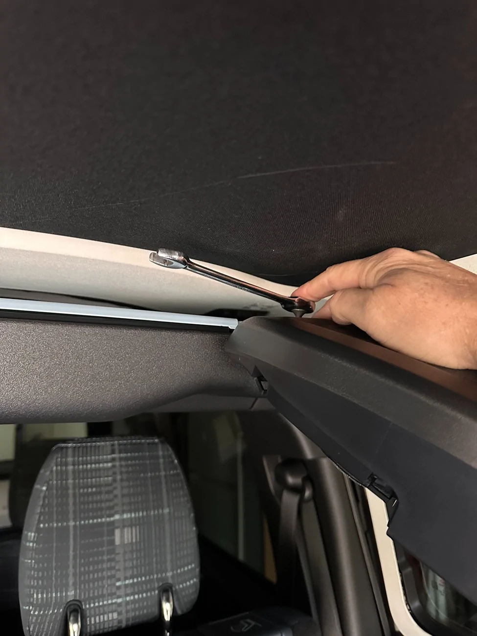

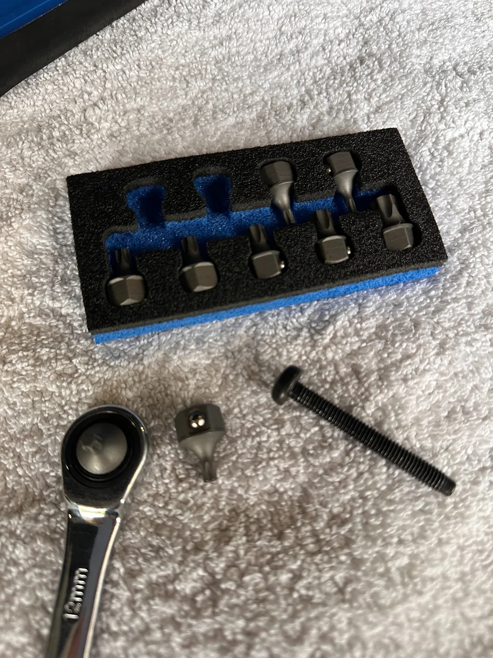

I purchased a set of stubby Torx bits on Amazon. They fit into a 12mmm ratchet and make hard-to-reach Torx extraction easy.
https://www.amazon.com/dp/B082LN5TXN?ref_=ppx_hzsearch_conn_dt_b_fed_asin_title_1

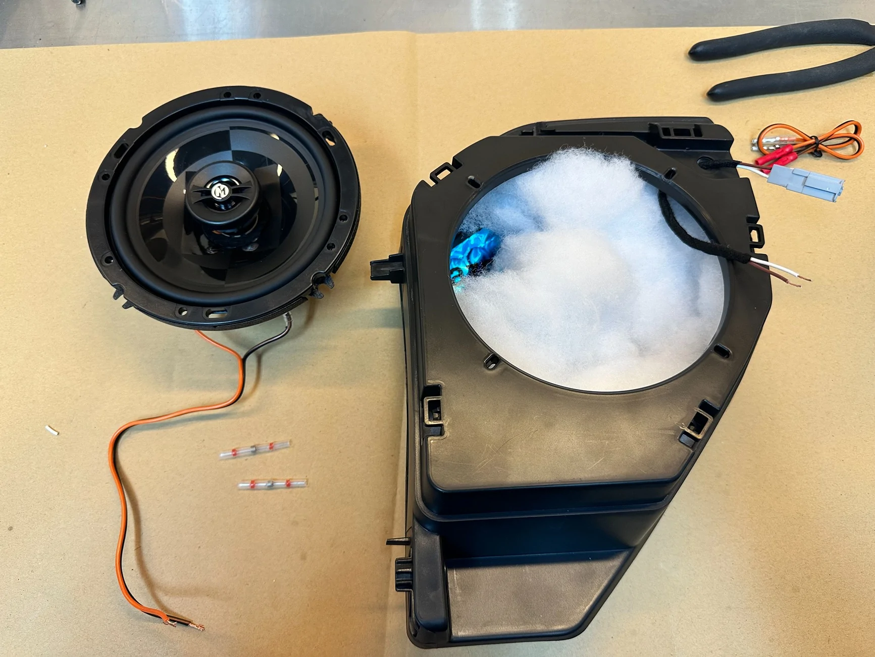

I chose these Memphis coaxial speakers for the back, and even without Forscan they already sound better
https://www.amazon.com/dp/B0BLYMPH1R?ref_=ppx_hzsearch_conn_dt_b_fed_asin_title_1
I chose the Mabett enclosures, mainly on price. They look and fit fine. I added butyl sound deadener (also Amazon) and polyfill to cut down on vibration and resonance.
It turns out that installing the bottom bolt all the way, along with the clip, helped with the installation. The top screws are blind so it's a bit of a struggle, but the whole assembly only took about 30 minutes.
Here's the link to the sound deadening mat:
https://www.amazon.com/dp/B07XMF3KK5?ref_=ppx_hzsearch_conn_dt_b_fed_asin_title_1&th=1
Last, I used solder shrink to make the wiring connection. My parts weren't from Amazon, but here's a link. There are multiple sizes for the different sizes of wiring, and as long as they're not in an environment where they move or are put in strain, they are my "go to".
https://www.amazon.com/dp/B09BJ7FY8X?ref_=ppx_hzsearch_conn_dt_b_fed_asin_title_2&th=1
Hope this was helpful. ;)

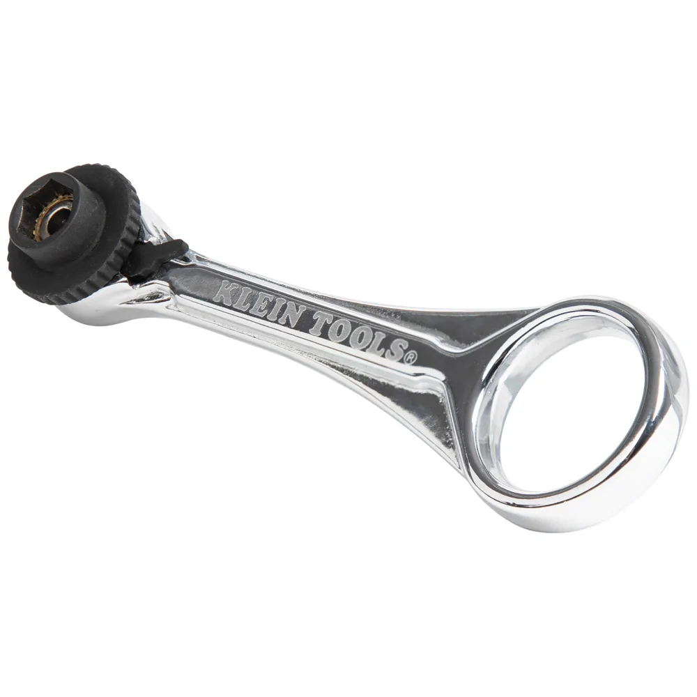

Something like this below is a little more low profile and cheaper at only $10. I had purchased one for something else and remembered I had it in the tool box when I was tucking the rear dash cam wire. I took the rear pod out to tuck its wire since it was sticking out (wouldn't have been seen unless you stuck your face in there, but I am OCD and was already in the area anyway, haha).
https://www.amazon.com/screwdriver-...a3c-9368-26386d18fd1e&pd_rd_i=B0CRQ9JRT5&th=1
