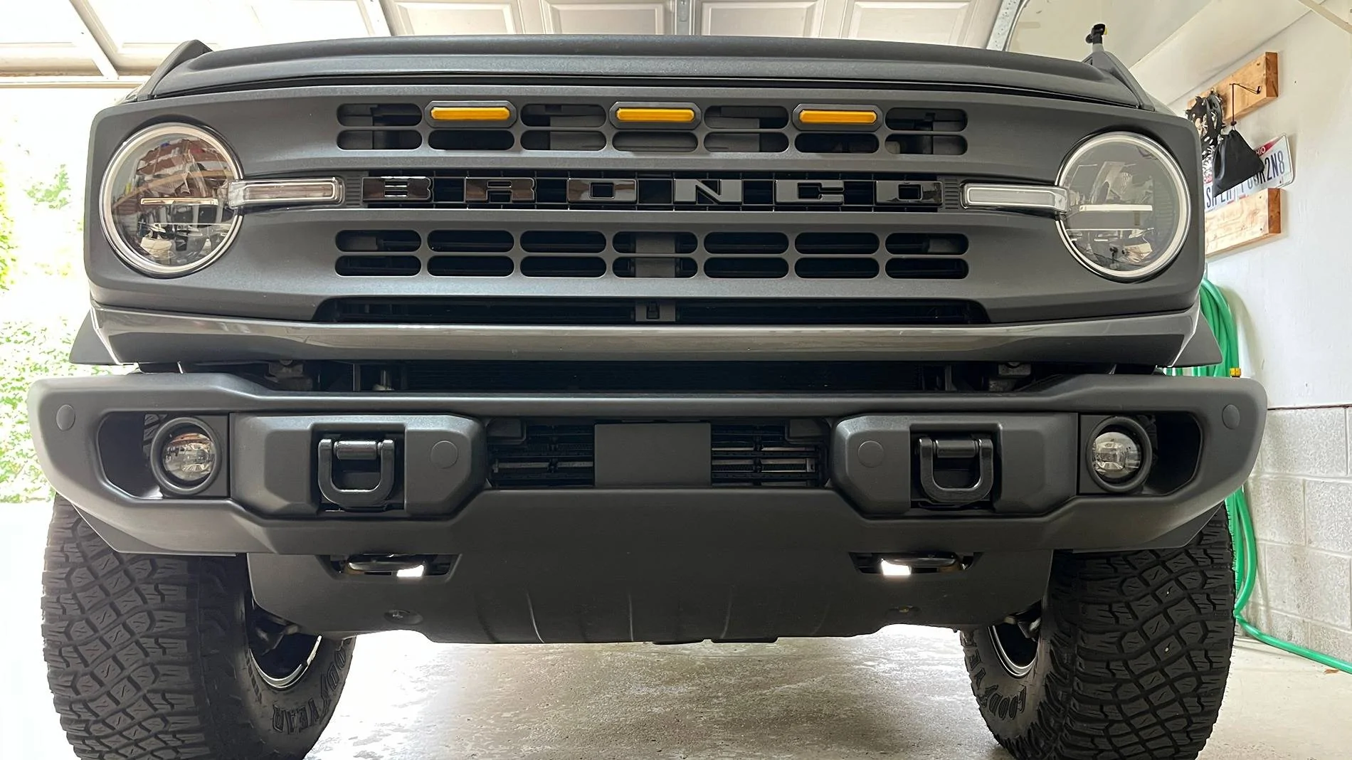

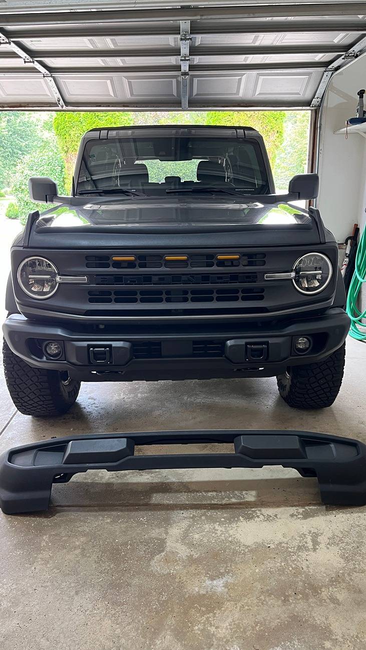

I can't speak for the aftermarket steel bumpers, but as you can see below, the Ford capable steel bumper can be installed without cutting off the tow rings. I would imagine the same to be true for the capable bumper but I can't say for sure. However, you will have to trim the front edge of the plastic bash plate to get it to fit with the capable bumper (and probably the modular one as well). It's pretty easy and allows it to tuck up behind the bumper so the trimmed edge is not visible. The tow rings will still poke out through the slots in the plastic bash plates. See my pics below.
However, if you decide to go with a steel bash plate, as I did after my original install in the pics below, you will have to cut off the tow rings (or buy the replacement intercooler mounts that do not have the tow loops welded to them. This is because the steel bash plate won't have the slots for the tow rings to go through.
Also, I didn't have sensors in my plastic bumper, but the capable bumper I found did. Don't let that stop you, you can just buy plugs on Amazon for a few bucks. You can see this in the pics below as well, they match the color and texture perfectly.

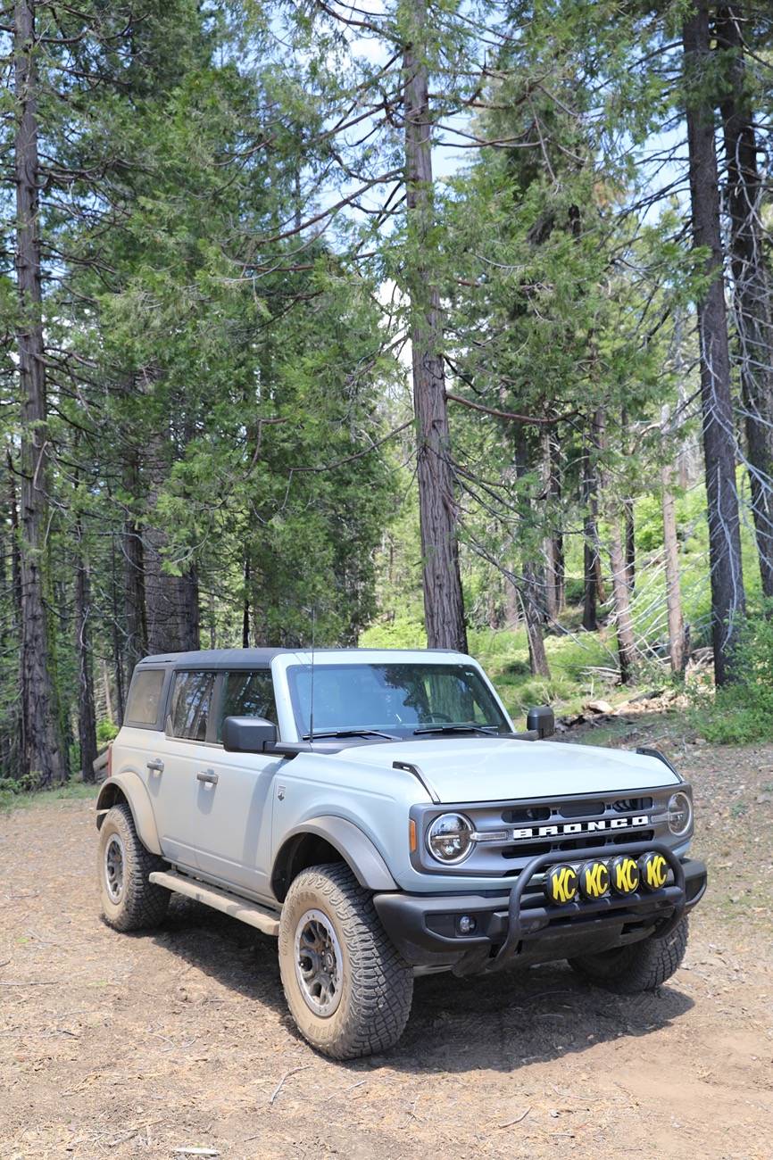

If you are just looking for a way to mount lights you can do something like this. Rough Country bar and 6” KCs. Nothing gets cut off.
Yeah, that's something I was considering as well. Looks good! I assume to install that, you have to take off the plastic skid plate or does install around it somehow?
