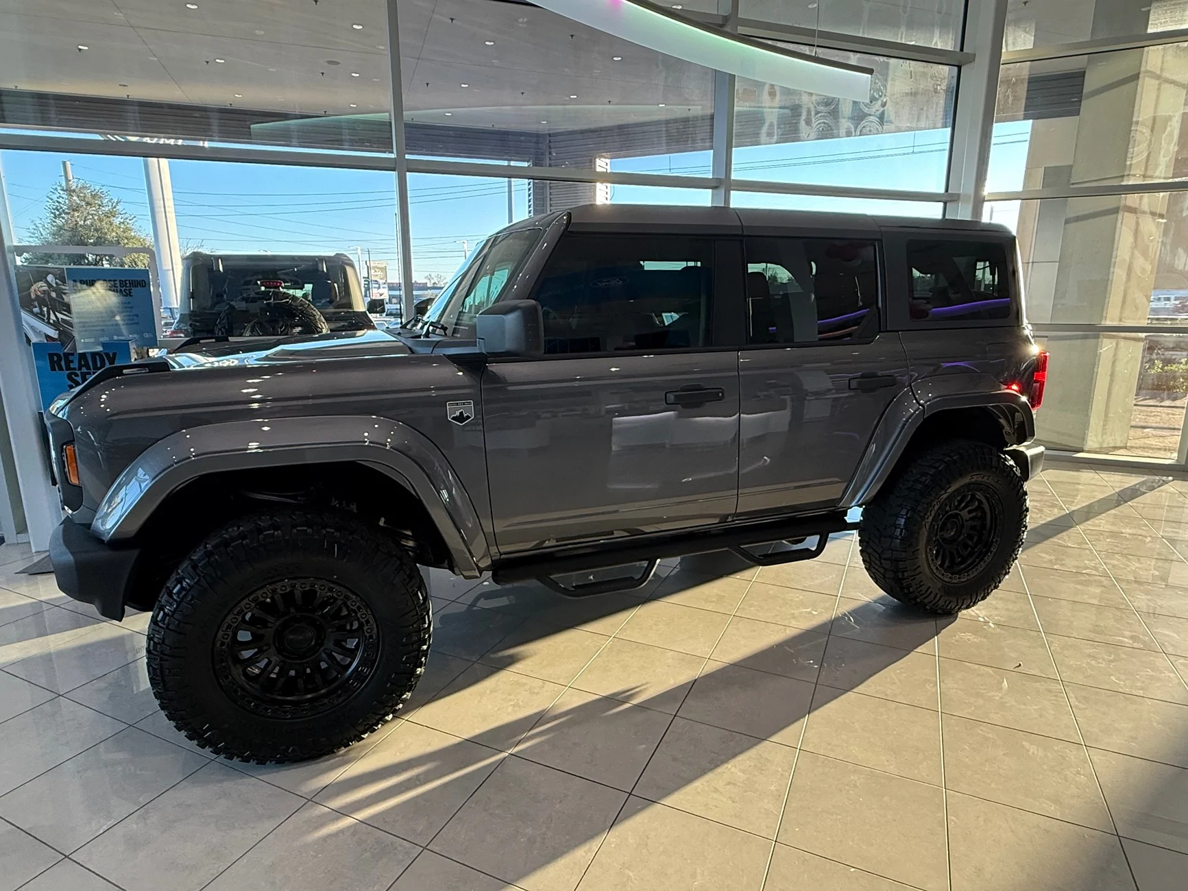

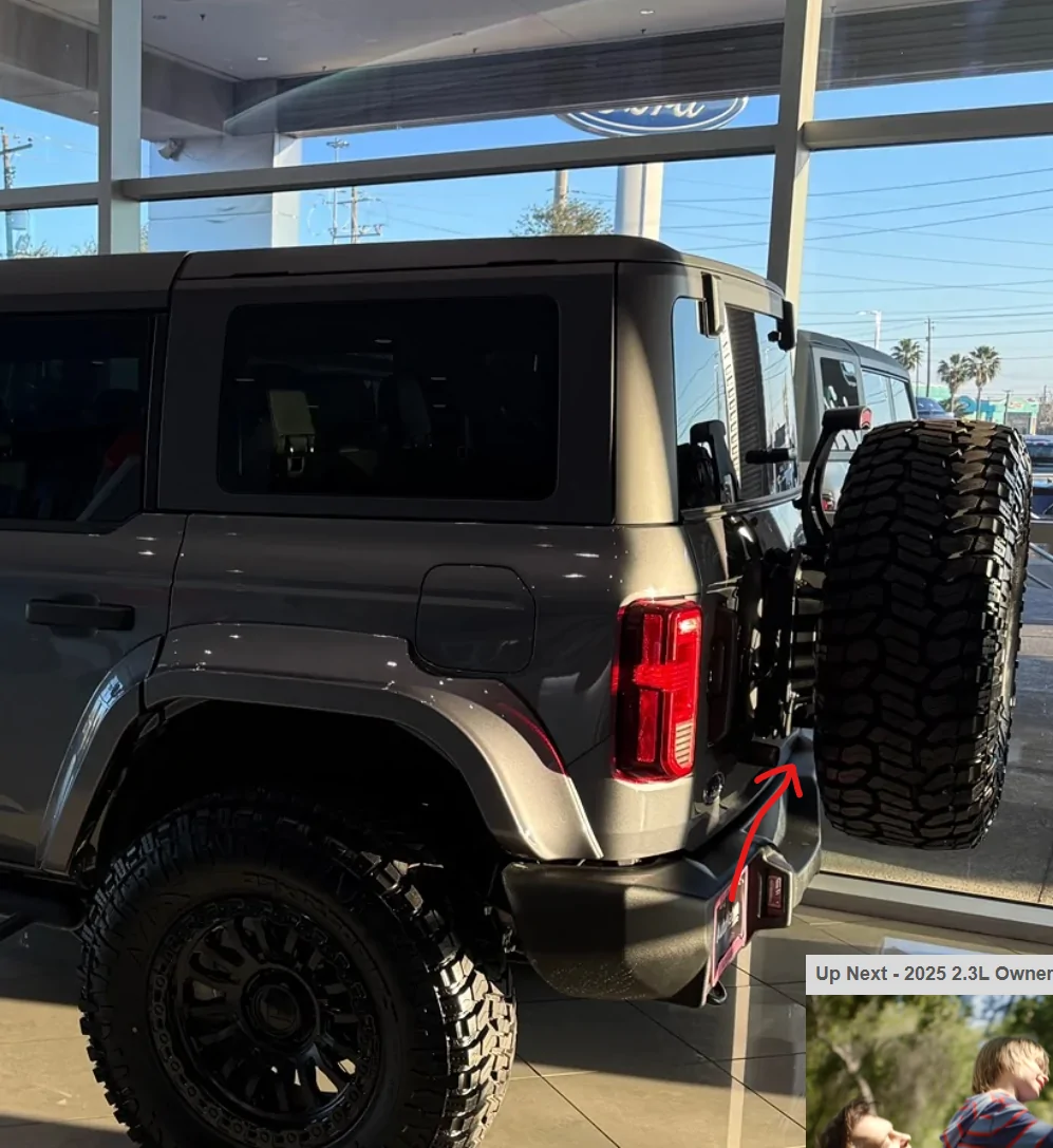

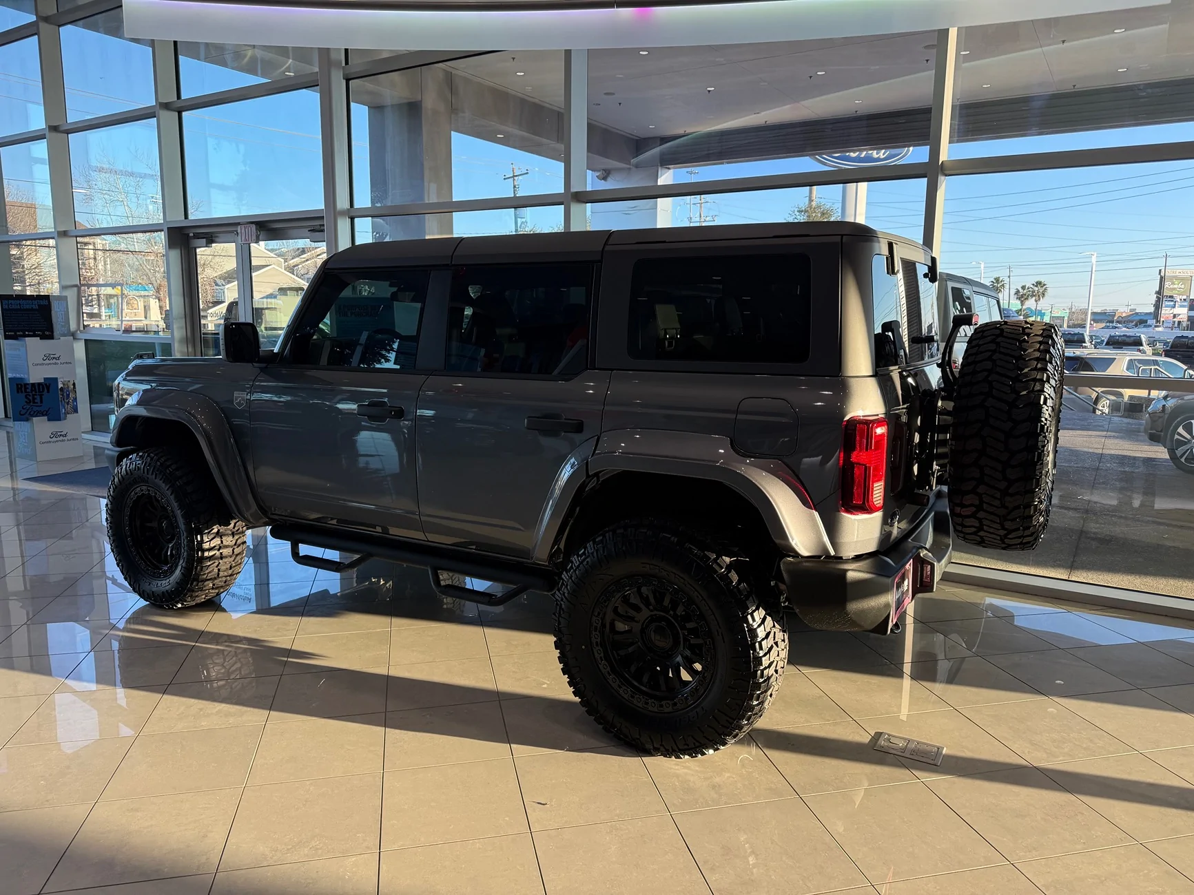

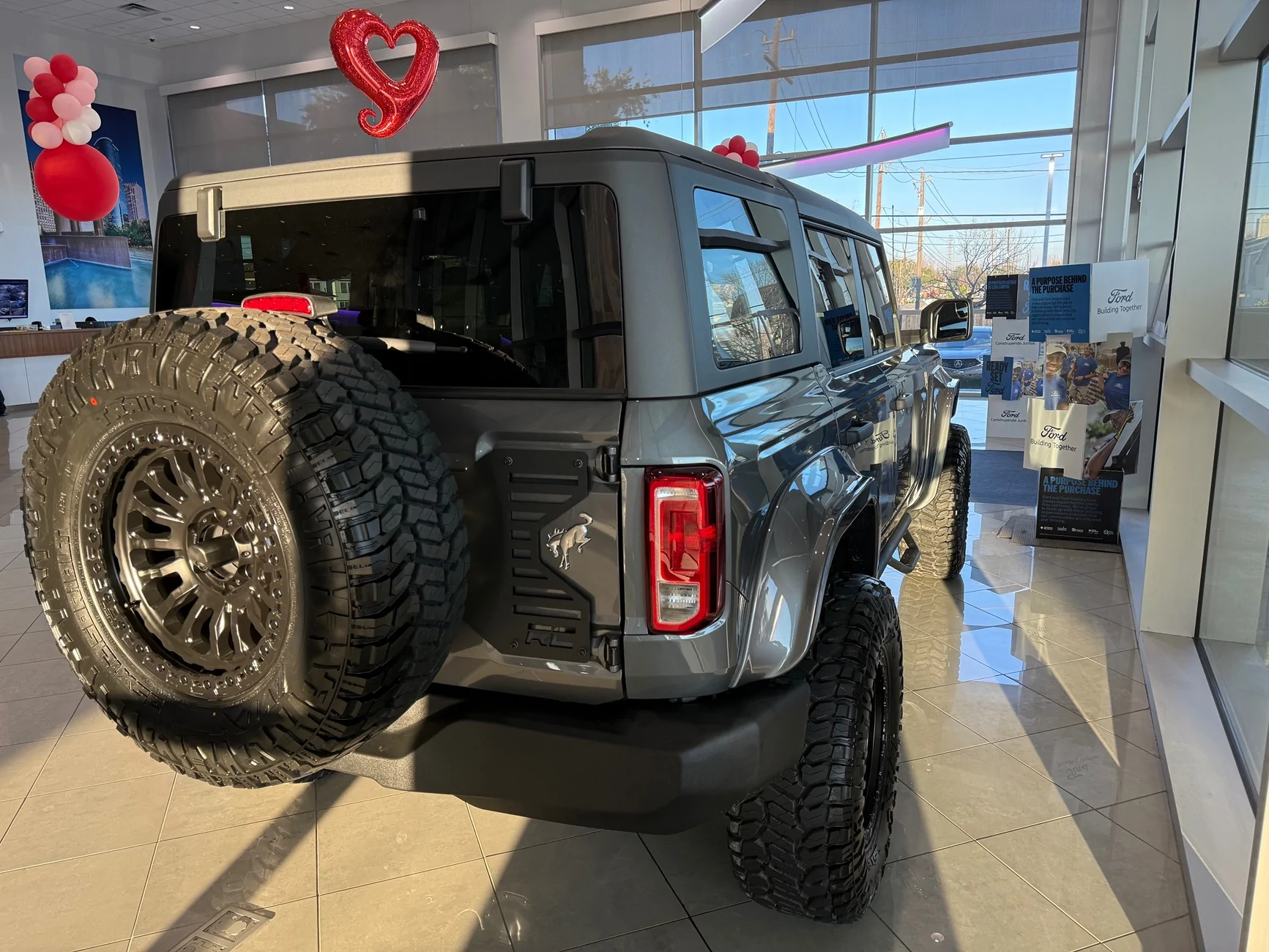

Yeah, that carrier is not OEM. Might be OEM with some spacers to accommodate the wheel offset - which is a terrible setup. But these "Dealer Builds" are more geared towards the "look" than practicality. If I was to guess this was a stripper Big Bend with open rear diff. The dealer staff gets to work and presents a "built" Bronco for a premium.
I do think the painted flares are a nice touch compared to what BesTop sells. Dealer did nice work on them. The RC stuff - It's not for me. It's not going to rust right away so the owner shouldn't have to get rid of it. But it will rust as sure as the sun rises.
Thanks, yes, bought it as dealer build. I've had and tinkered with sports cars before, this is my first 4X4 rig like this. I will keep an eye out on the RC stuff for rust and quality. Going to see what i can do to get that spare a bit closer to the tailgate. Thanks so much for the insight.

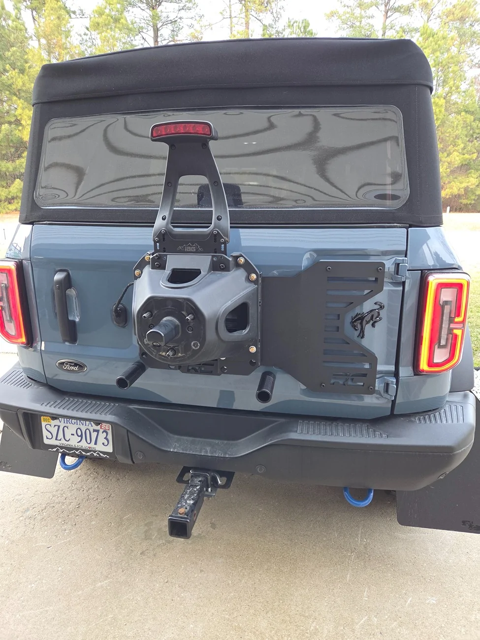

The spare tire carrier works in conjunction with the spare tire rubber bumpers to support the weight of the spare tire. When someone opts for aftermarket wheels with a different offset from the OEM wheels, you will end up with a gap. Right now, the weight of your spare is supported by the carrier only. The tailgate is aluminum. When you traverse over bumps (can be just speed bumps at the mall), the weight of the spare will cause the carrier to flex potentially causing dents even stress fractures in the carrier. Your tailgate reinforcement bracket from Rough Country isn't really doing that much. It helps some. But if you are new to offroad aftermarket vendors, you will quickly learn why they have earned the moniker of Rust Country. If it was my Bronco, I would jettison that piece.
In the meantime, the cheapest option is to wedge a racquetball between the current spare tire rubber bumpers and the spare tire itself. But that might seem a little janky (if it works, it works). But the best way is to buy trim-to-fit spare tire rubber bumpers.
I added the Barnes spare tire bumpers. Rough country have come a long way in the past decade. Parts are well made and haven't had issues personally. The RC tire relocation and support made a pretty big difference.
Ford Bronco New here! 20260227_170105
Thanks I just ordered the Barnes bumpers you got, looks great!
