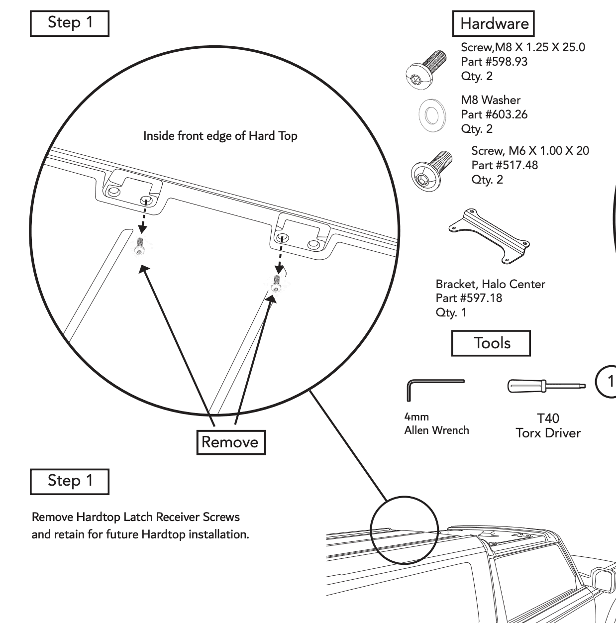

Hi, the dealer installed my Bestop Sunrider but failed to give me the two Latch Receiver Screws that I need to reinstall the hardtop panels. These screws are located at the "inside front edge of the hardtop" (the hardtop over the back seats). The parts catalog isn't clear on the size of the screws. Can anyone provide me with the part number or the dimensions of the screws? Thanks so much! 2022 Bronco Big Bend 2 door.

You have the spec. Go to local hardware store. It will be 1/4 cost through Ford.
Better yet demand the dealer that lost them replace them

My opinion?? The outside screws (the ones you did not remove) are the same length as the inside screws, so you have samples you can use. Take out one of the screws and go to the hardware store for substantially cheaper replacements.
It's going to be an M6 x 1.00 but I don't know what the length is. My complete guess is they are M6 x 1.00 x 16. But you shouldn't trust my guess.

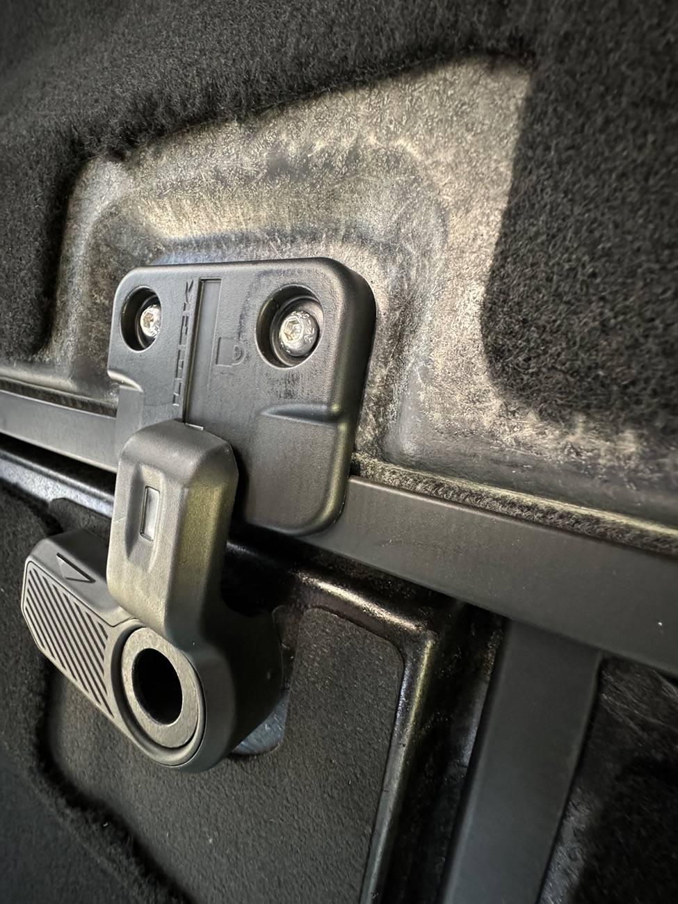

I can confirm these are M6 x 1.00 x 16, I just purchased some from the local hardware store. I had misplaced the 2 screws the OP didn’t get back from their dealership when I installed my sunrider and it was time to put the hard top back on, so switched out all those screws to stainless steel.
