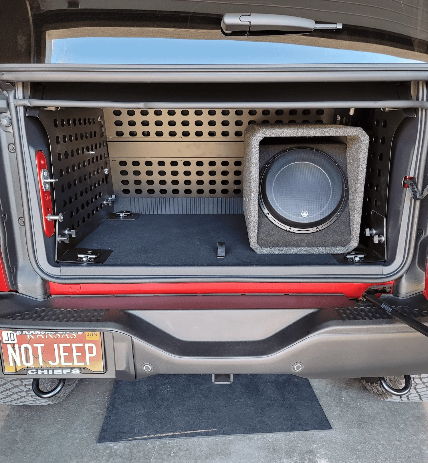

I checked out both the powered and the HO and ultimately went with the HO due to availability of air space in the box for the sub. The powered one didn't have a much air space and ultimately couldn't hit a hard. It's more about preference as I listen to mine at high volumes most of the time and really enjoy feeling it. Can't go wrong with either box though. I would make sure you have a security enclosure if you take your top off. Just a little more peace of mind. The HO box also takes up a little more space.

I appreciate the advice! I like to listen at higher volumes and feel the bass as well. I do have the same raised lid cargo enclose as you (I knew I’d eventually get a sun installed back there and wanted it out of sight and locked up). Too bad you’re not closer, I’d love to hear you system. Thanks again!

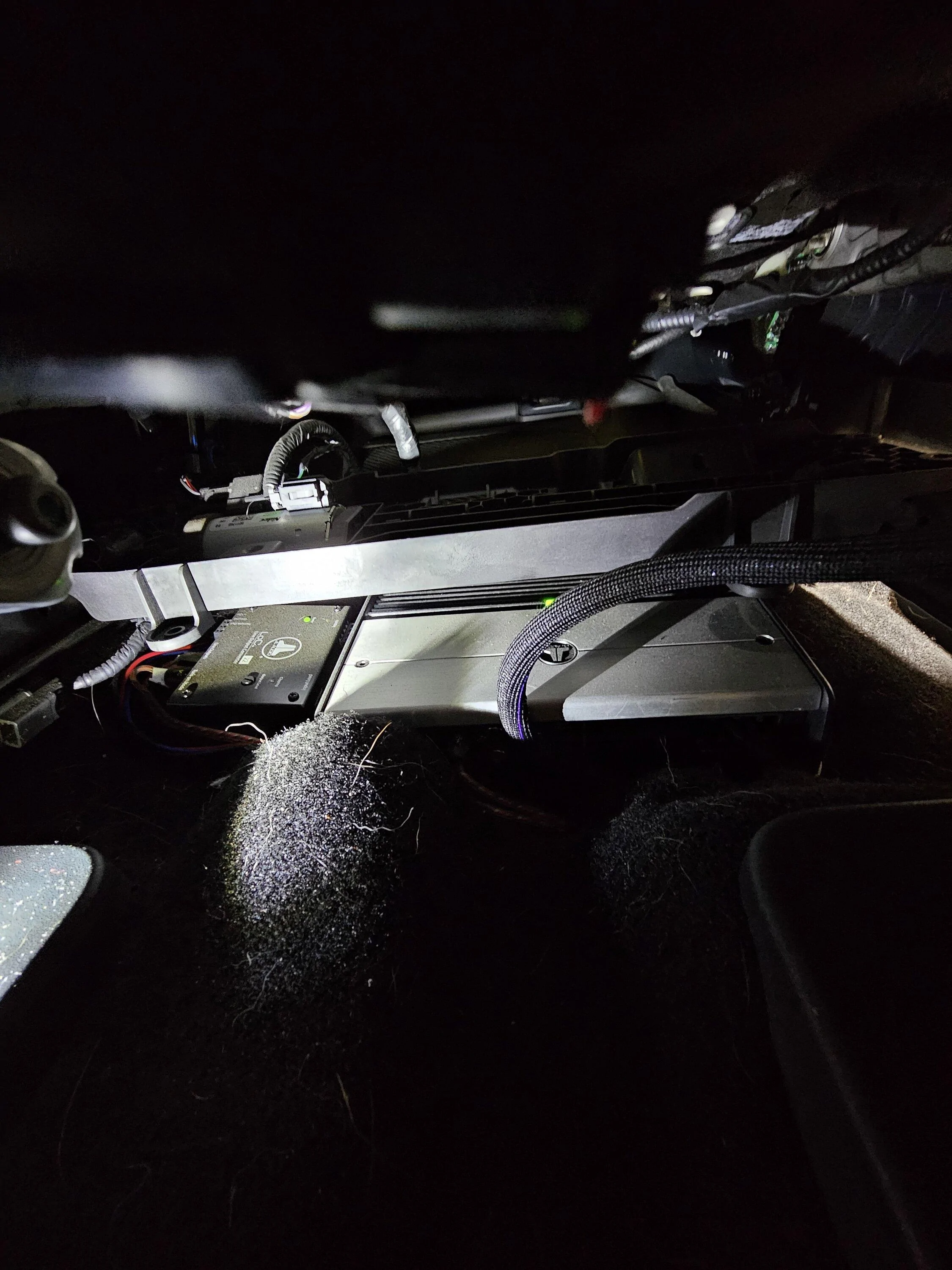

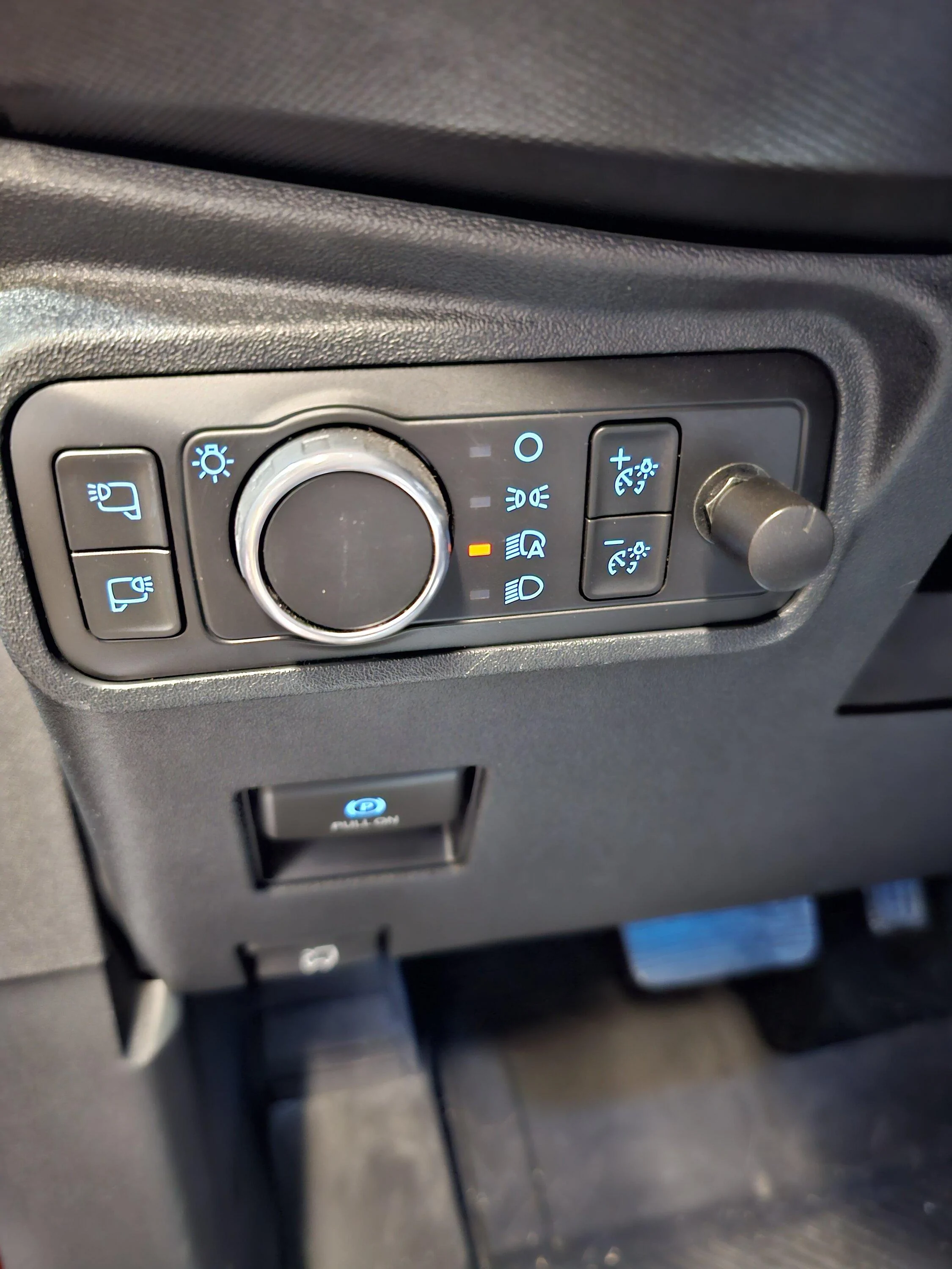

Here's where I've placed everything. Bass knob, Amp, line out converter, and sub.
