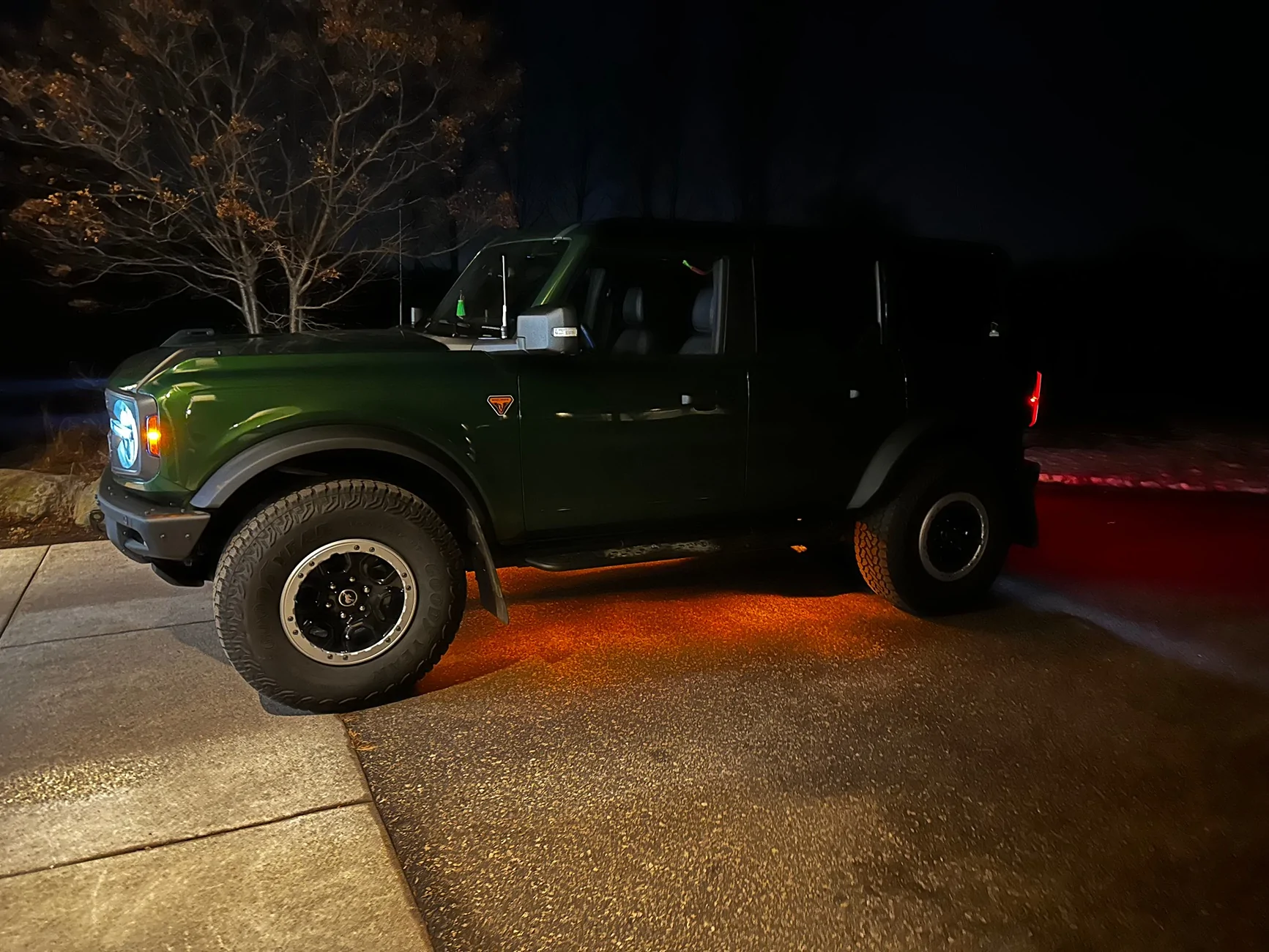

I sold the 100 series but kept the lights. So I asked myself what I could do with them. Well the answer was - ROCK LIGHTS!

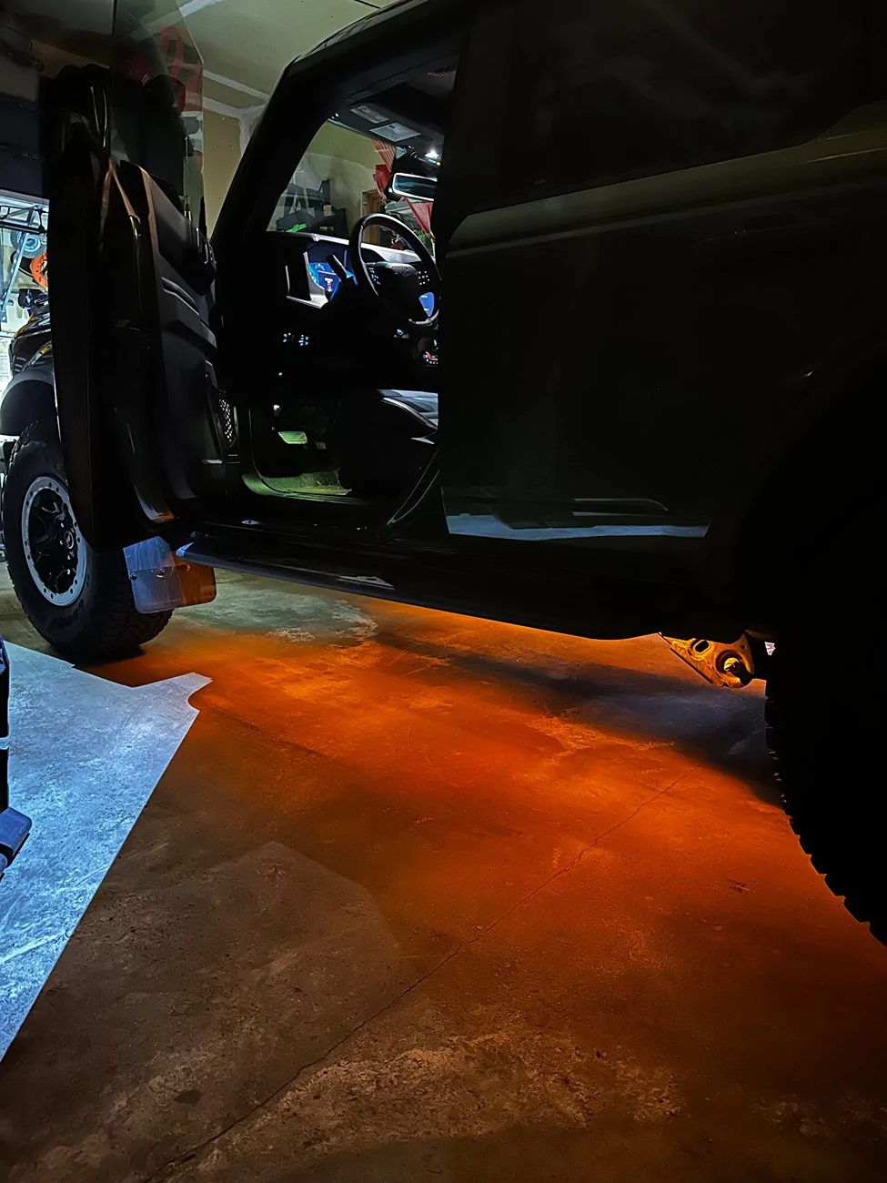

Ford Bronco Nacho Nanos as Rock Lights IMG_5571
Ford Bronco Nacho Nanos as Rock Lights IMG_5572

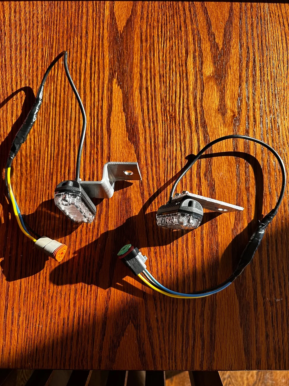

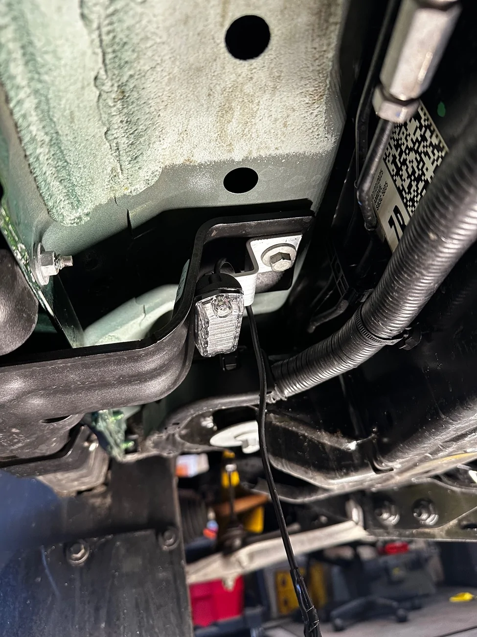

So I made some aluminum brackets out of scrap. Wired them into Duetsch connectors - Ground, Amber, Full White
Ford Bronco Nacho Nanos as Rock Lights IMG_5562

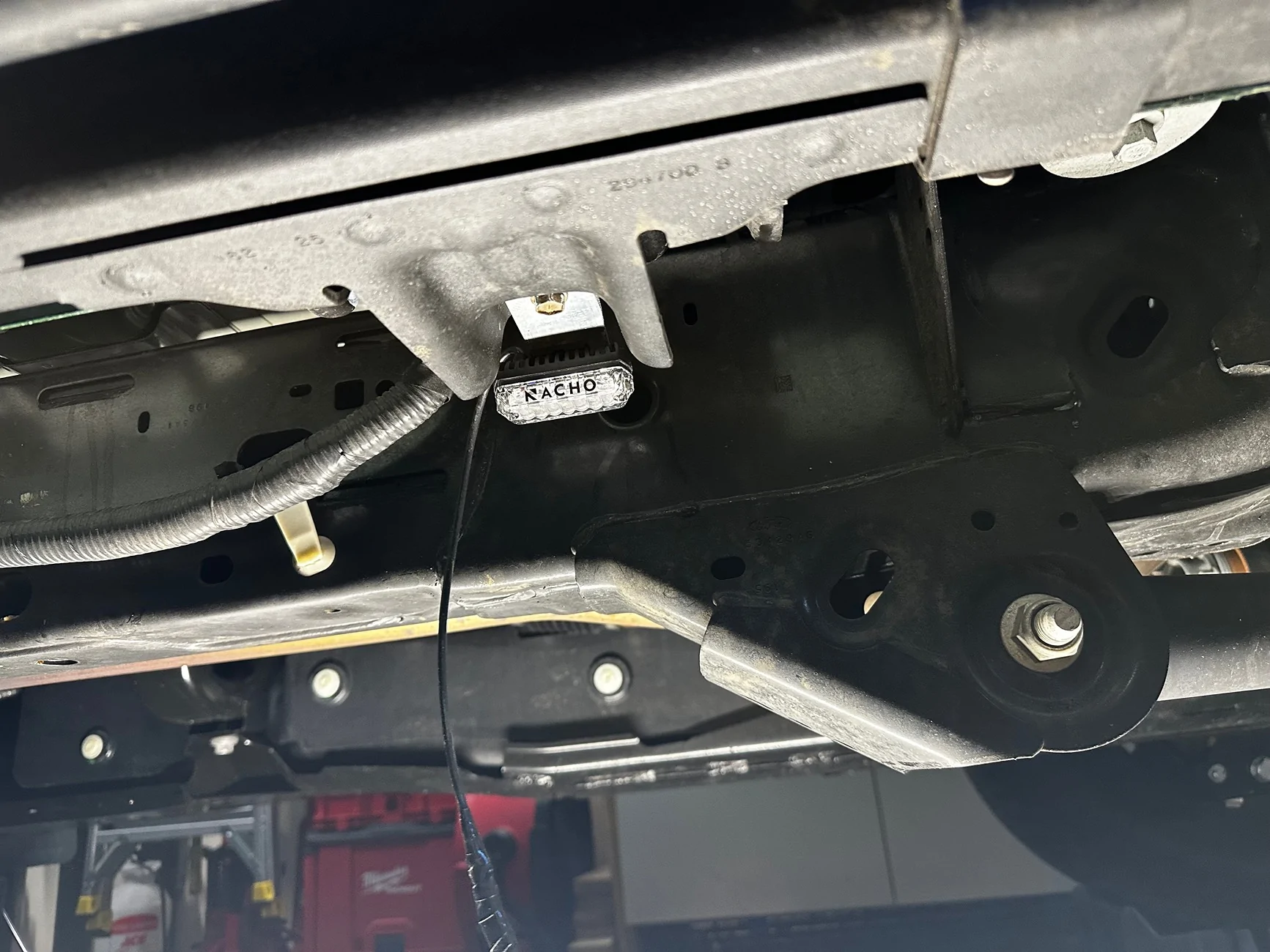

Put them on the Rock Rail Brackets 100% out of the way.
Ford Bronco Nacho Nanos as Rock Lights IMG_5569
Ford Bronco Nacho Nanos as Rock Lights IMG_5568
Wired them into Aux 5&6 and off to the races!

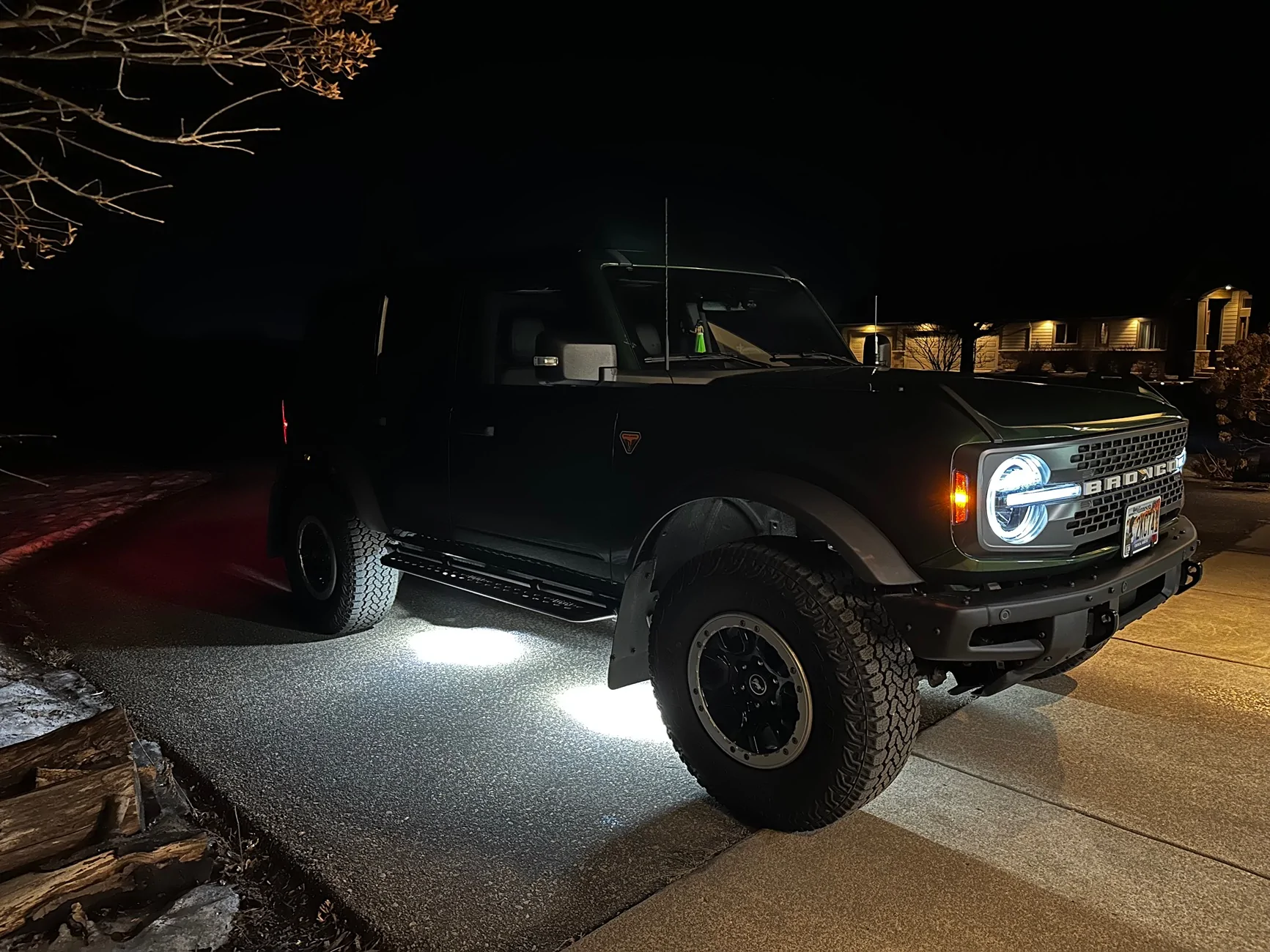

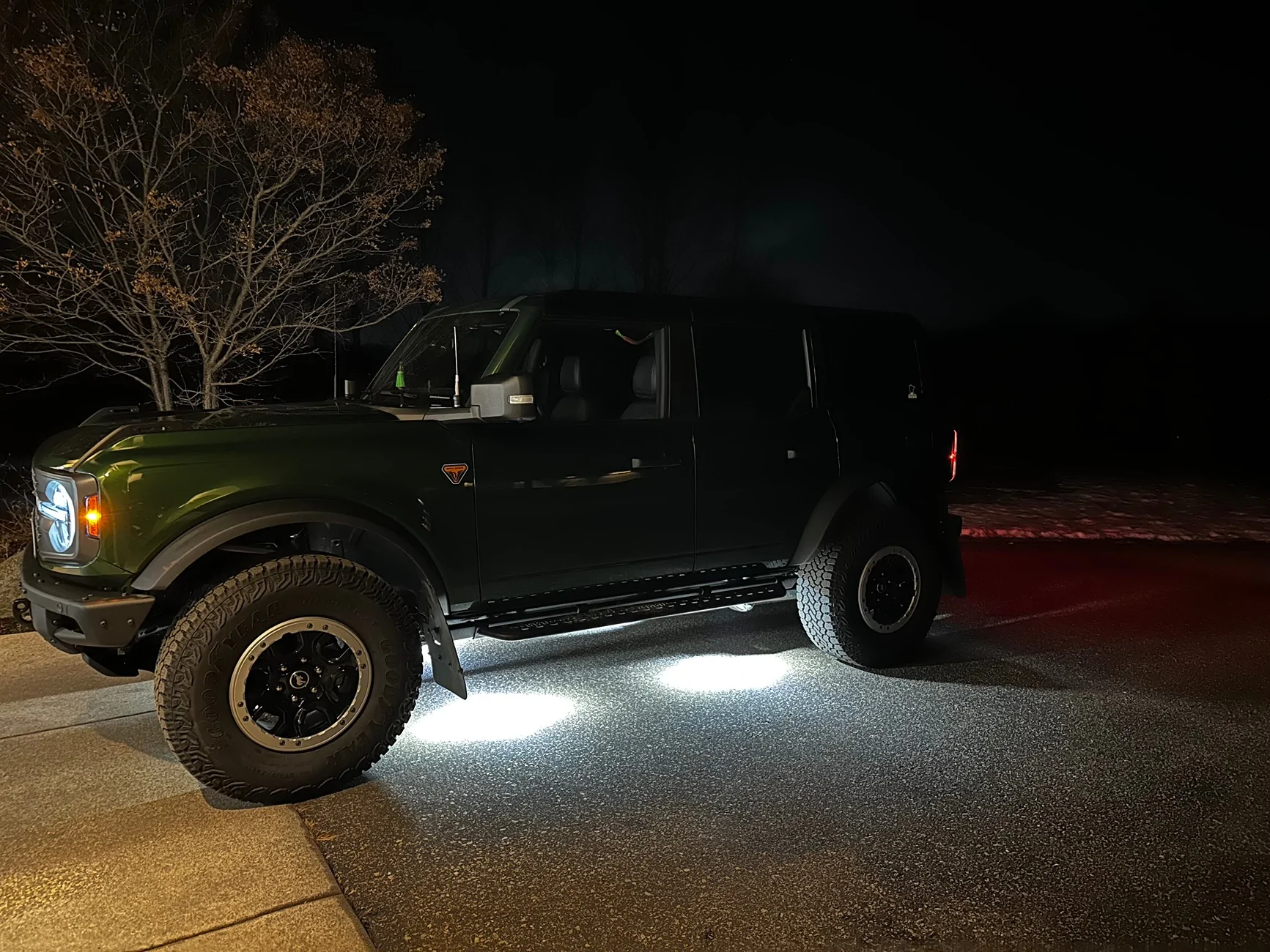

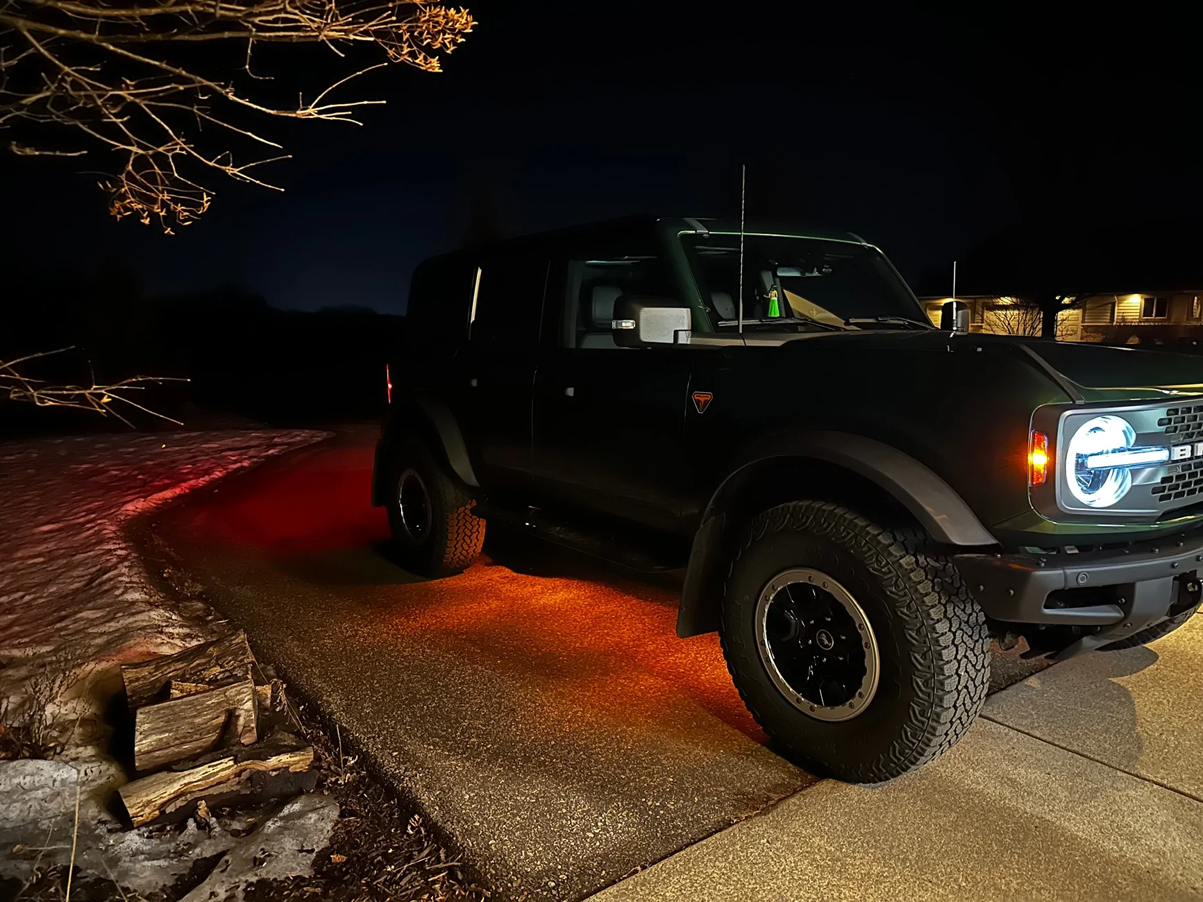

Ford Bronco Nacho Nanos as Rock Lights IMG_5570
Ford Bronco Nacho Nanos as Rock Lights IMG_5573
Ford Bronco Nacho Nanos as Rock Lights IMG_5574
