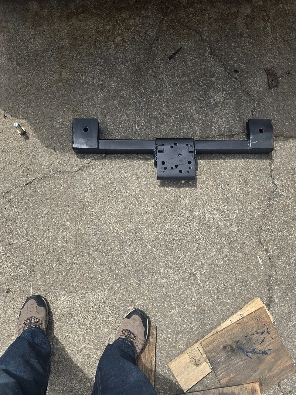

Sorry, not making this for anyone other than myself! Too much liability. I know it's over built, but still. If anyone wants some specs I can tell you exactly what I used, but ymmv!

Good job! I’m still in the hunt for a front 2” receiver winch mount, since I’ve already got the cradle and winch from my previous rig.
Anyone found a commercially-produced one made for the modular bumper setup?
A single 2" receiver isn't strong enough for a bigger winch. Especially if side pulls are done.
A better setup would be a receiver on either end of the winch.

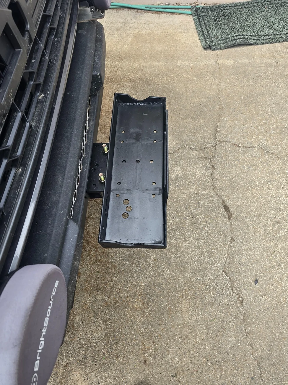

Pics. of my diy removable winch mount
If they are the only thing holding the winch plate to the mount those two bolts are not strong enough for a serious pull. Just need a tug should be fine but get really stuck and they will shear.
What size and grade? A 1/2-inch SAE Grade 8 bolt has an approximate shear strength of 14,000psi. That's with threads. There are 2 installed, so double that. Cut that by 50% for safety.... Back to 14,000 psi.
Steve_In_29
Jul 6, 2025
716
1,076
St Johns, Arizona
2024 Heritage Limited, 2 Door, 1973 Bronco, 1999 Ranger, 2007 F350
Would you suspend the Bronco over your head supported by JUST those two bolts?
There's a reason Ford mounted the tow points with three bolts each
The winch bumper on my F350 (Warn 16.5K) is mounted with 8 large bolts.
Bolts are designed to clamp and don't do as well in sheer situations.

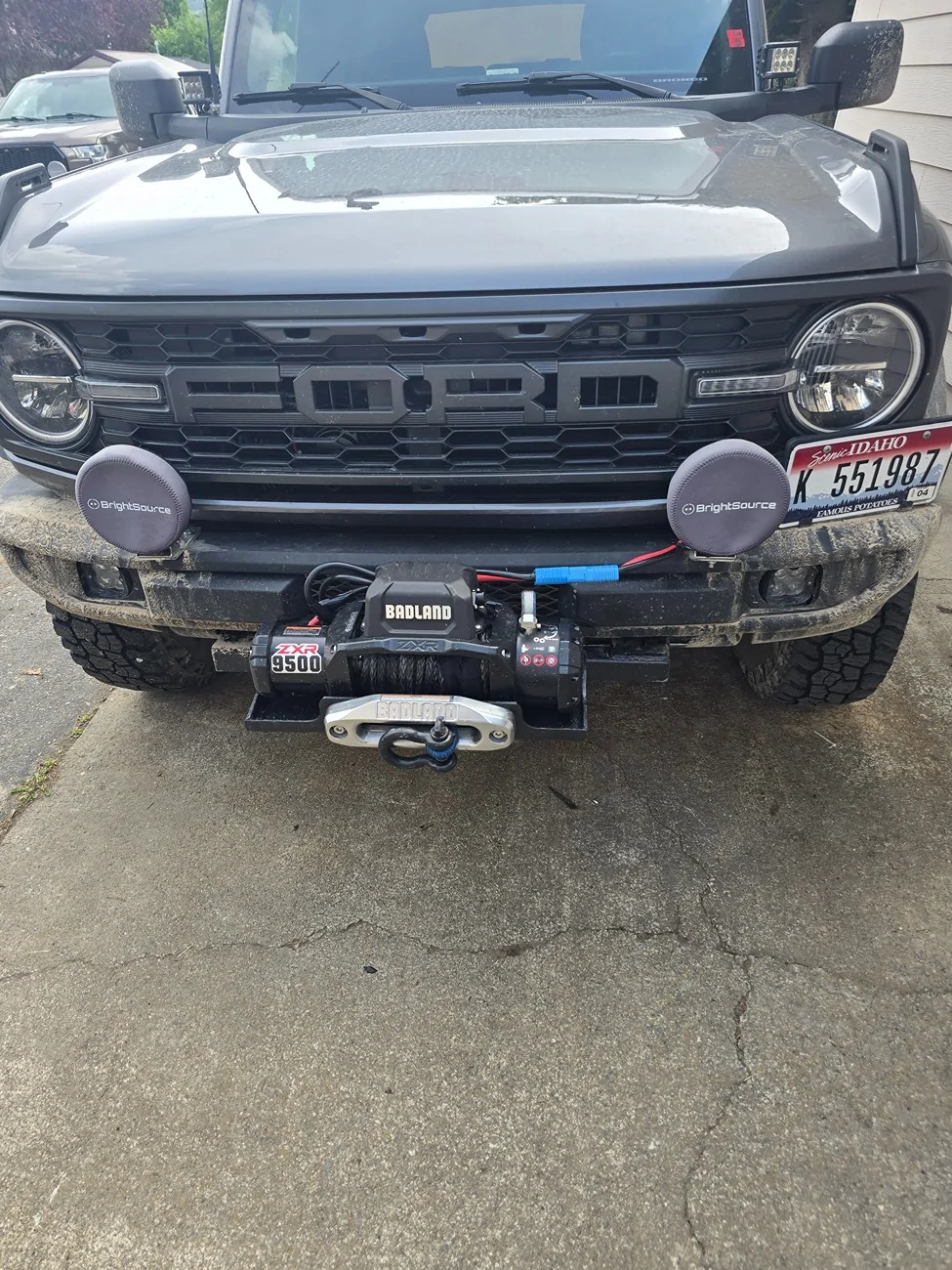

joes bronco
Gordon
Feb 14, 2024
95
218
post falls Idaho
2021 bronco 2017 f150
Those 2 bolts are 3/4" grade 8, not concerned about them braking or shearing off at all.
Hang my bronco with only those 2 bolts holding it?? Yep, no concerns at all but wouldn't try it, afraid those 4
small bolts which are not grade 8 holding the winch on the mounting plate might break but again I
doubt they would though. To me they are a safety point I want them to break first
