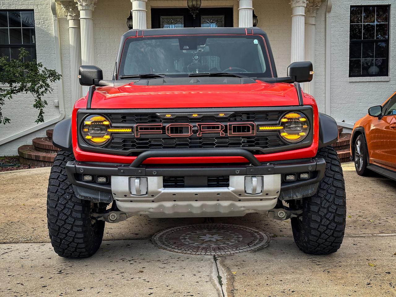

Been running them for a while. No visible warnings in the cabin. Work great. I wouldn't tell anyone to get them if they're not your style, but I would say get something. Output of the stockers is poor versus these and many other vehicles.
On our Badlands, I tend to drive around with fogs whenever I drive it at night. Not so much on the Braptor.
