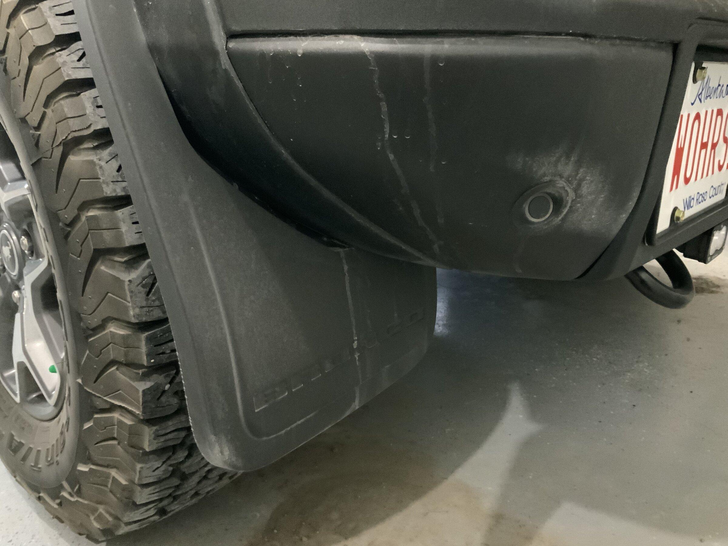

The front ones are way more useful, if I could only have front or rear, it would be front for sure. I had to mod mine, but so glad to have them on.
Ford Bronco More OEM Splash Guard installed details IMG_9342
Yeah they really do look great and I'm sure the protection they offer is huge. Its unfortunate that the front guards don't fit with the Bronco side step.

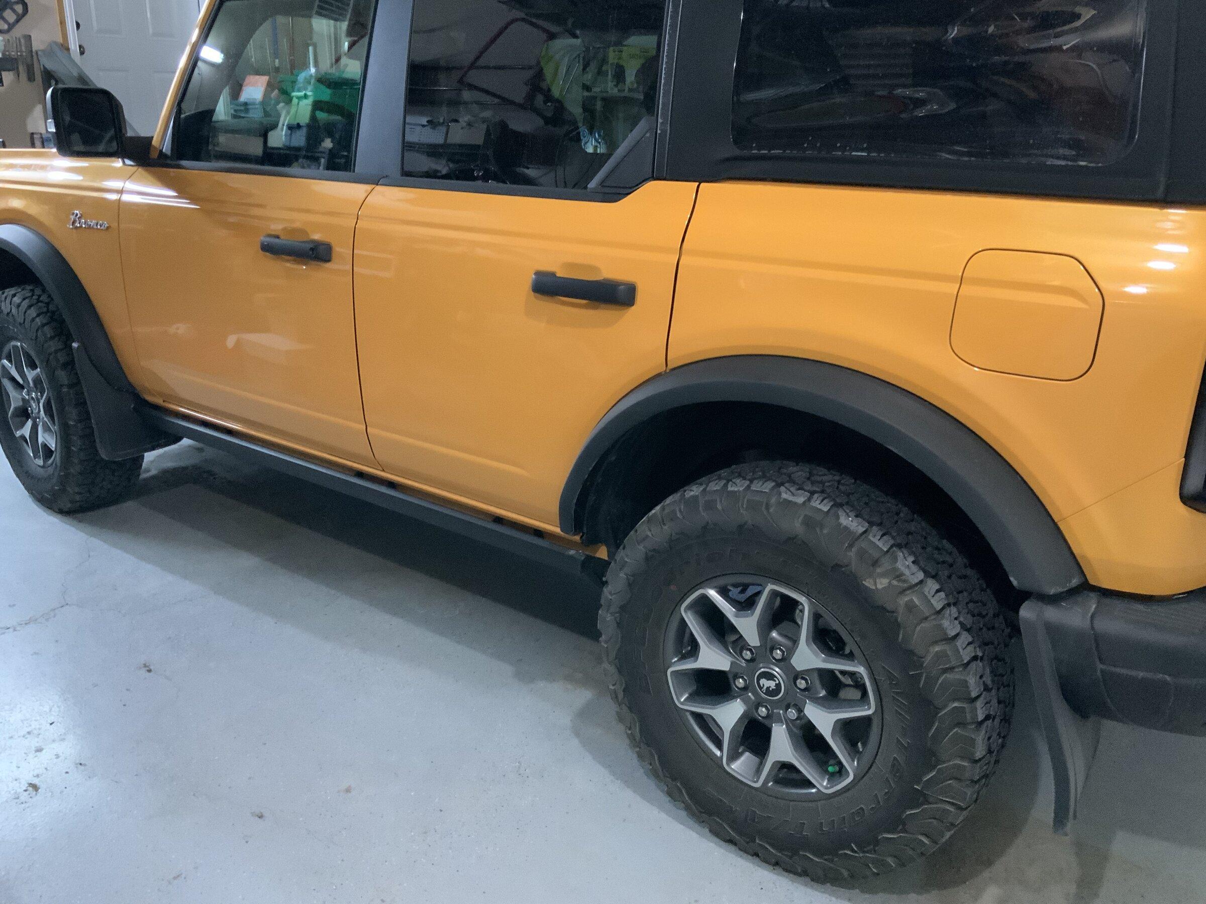

Here’s what it looks like:
Ford Bronco More OEM Splash Guard installed details 70075DDF-D540-4793-9200-3D3EB7AD8946
Ford Bronco More OEM Splash Guard installed details DE26D39D-F864-4B3E-9AEA-0C4A833AC17E

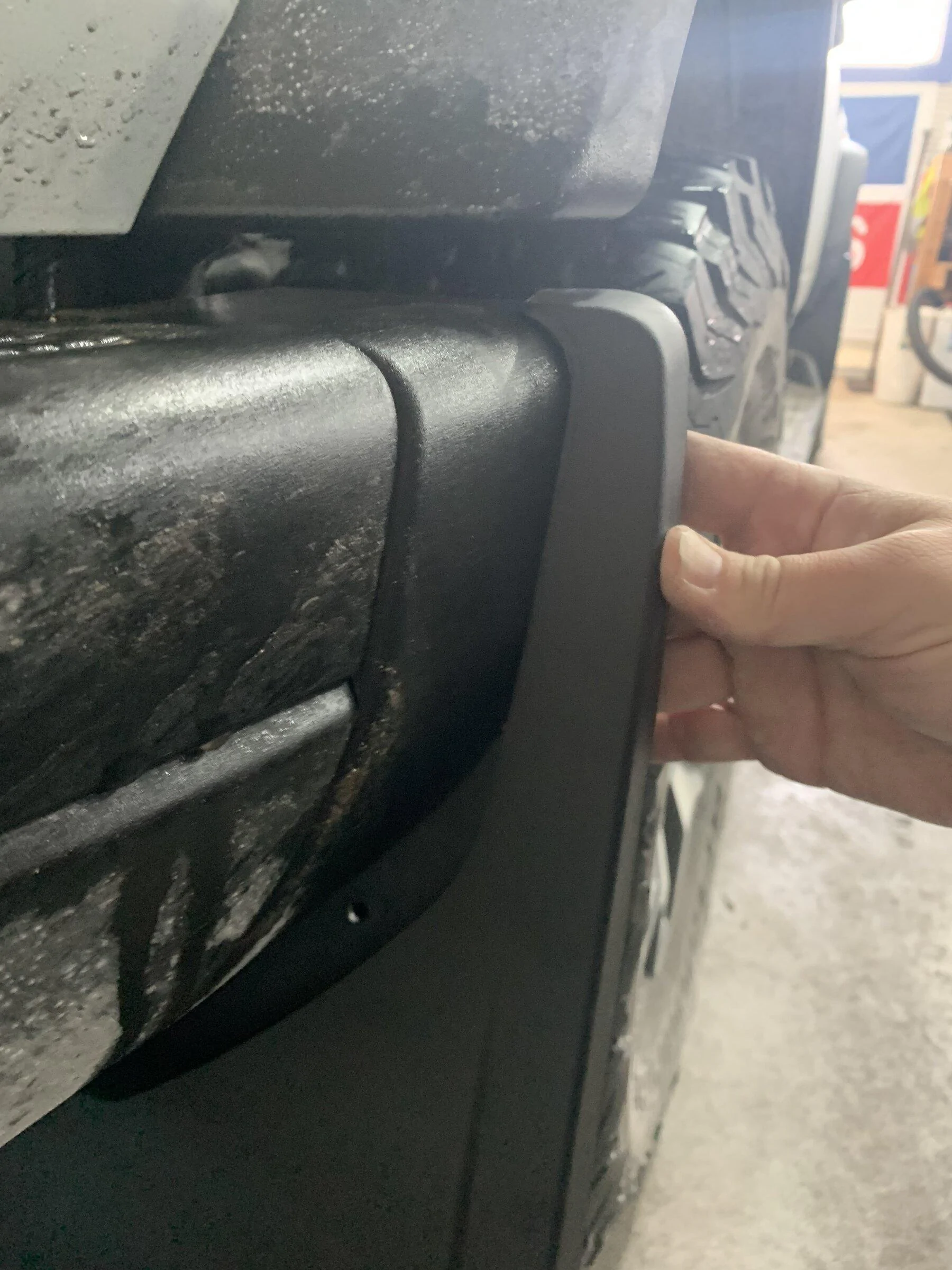

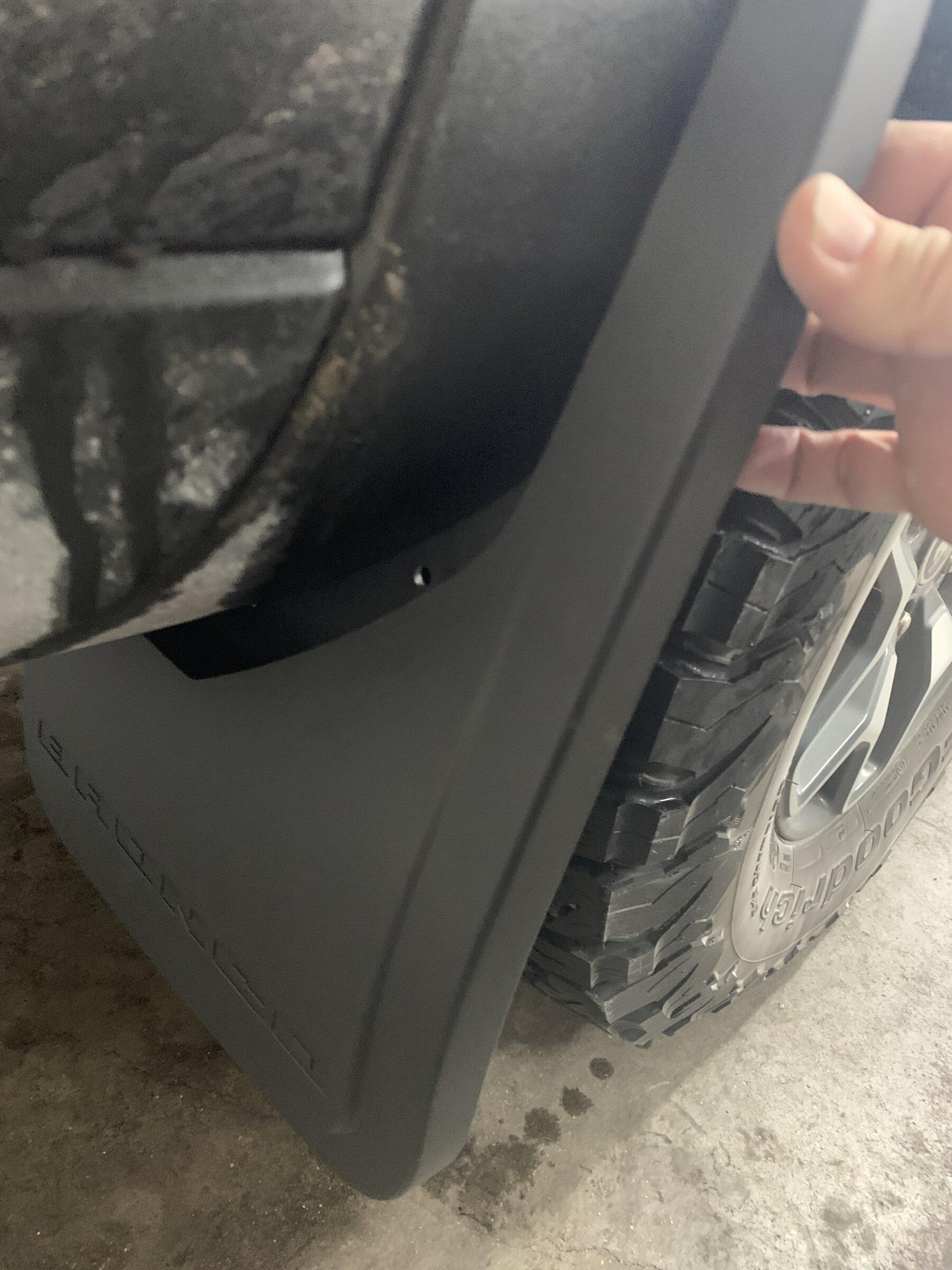

I just put the fronts on (Badlands) because the rears look like this….
Ford Bronco More OEM Splash Guard installed details 7402ECDB-2212-4A76-BB92-4BC359D65AAC
Ford Bronco More OEM Splash Guard installed details E968939C-1B2E-42A2-A4C0-EEC5D52663C6
I wish Ford would specify what trims the mud flaps will and will not fit. It seems a lot of us wasted money on the rears because Ford doesn't mention the fact they will only fit the plastic bumper. FAIL FORD.
