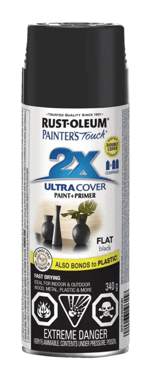

@SnowBronco - I assume this is the one you use (in flat black)?
Ford Bronco Modular Bumper Rock Chips Screenshot 2022-11-24 at 8.20.40 PM
I'd just go to Cambodian Tire and pick out a good satin black rust paint. Doesn't have to be in the auto department! I wouldn't use flat black, the wrinkle black powder on the bumpers is a satin color if my eyes don't do me wrong. Haha
