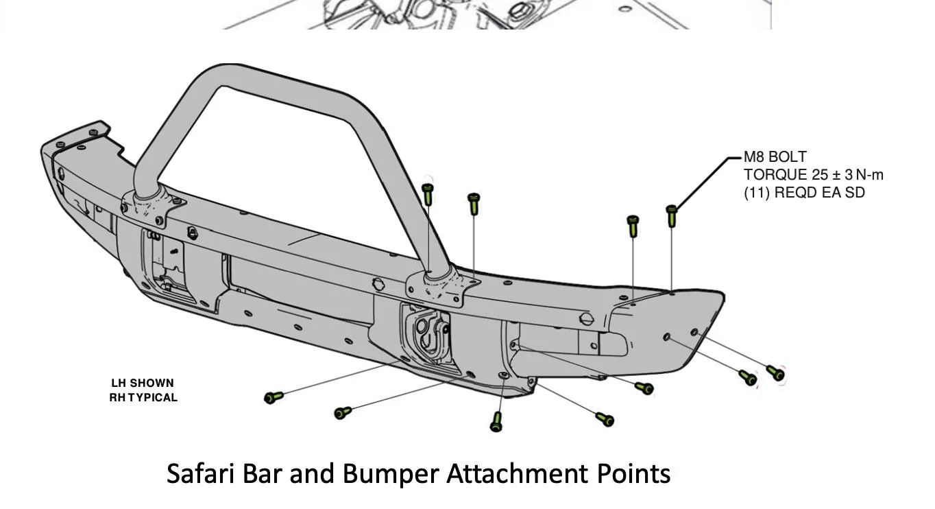

Installing light bar on my Mod bumper. Does anyone know the torque specs for the T40+ bolts on the bumper.
Roger123
Roger
1,825
4,323
VA Beach, VA
Ford Bronco Mod Bumper Torque Specs F47E5B53-55E7-49D9-A27A-3409A3823EA7
