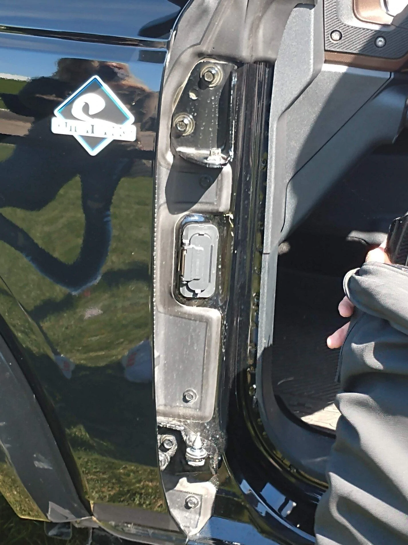

This is normal and we've been getting pictures of it since the dealer roadshow days. It doesn't really bother me, but if it starts to I'll tape it off and spray with some matching touchup paint. Obviously removing the hinges would be better but I don't want to deal with the alignment on reinstall.

Trick/hint for anyone doing this:
IF you don't suffer an anxiety attack doing so, you can take a small (like really small, not a 1/4" one) drill bit and pop a hole between those 2 bolts, through both the hinge/bracket and the body (but do NOT bury the bit and hit wiring, all ya need to do is penetrate the metal behind the hinge).
Use that hole and that bit as a line-up pin when reinstalling.
For something where you aren't painting the body behind it, you can also take a grease pencil and trace the outline of the bracket, wipe off afterwards. Sharpie does not wipe off, FYI.

Tri-coats are drastically more susceptible to there being paint variations in areas of the car that aren't exterior and receive direct attention from the robot painters which have assumed the souls of mortals, so any of the Rapid Red or Cyber Orange Broncos will have more of this than the other colors.
Also: this is the standard reality of mass-manufactured cars (did you think your Bronco was going to be custom coachwork?) which go through painting booths. None of this is a concern. The metal underneath has been treated before fully primed.
This is as much of an "issue" as rust on brake rotors after just a few miles of use. Complete non-issue.

I don't want to sound like the d-bag here but chances of getting Ford to pay for this is miniscule. Most dealer are on a "digital imaging" program and have to take pics. and send to Ford for approval. Just spoke with my b/s mgr. and am 50/50 on Ford covering it. Next concern is do you want your new vehicle painted on and how close with they get the color match.
Catch it during PDI and bitch after that your sol. It doesn’t even have to be the best to paint jobs just make sure it’s the right color and it’ll look fine.
