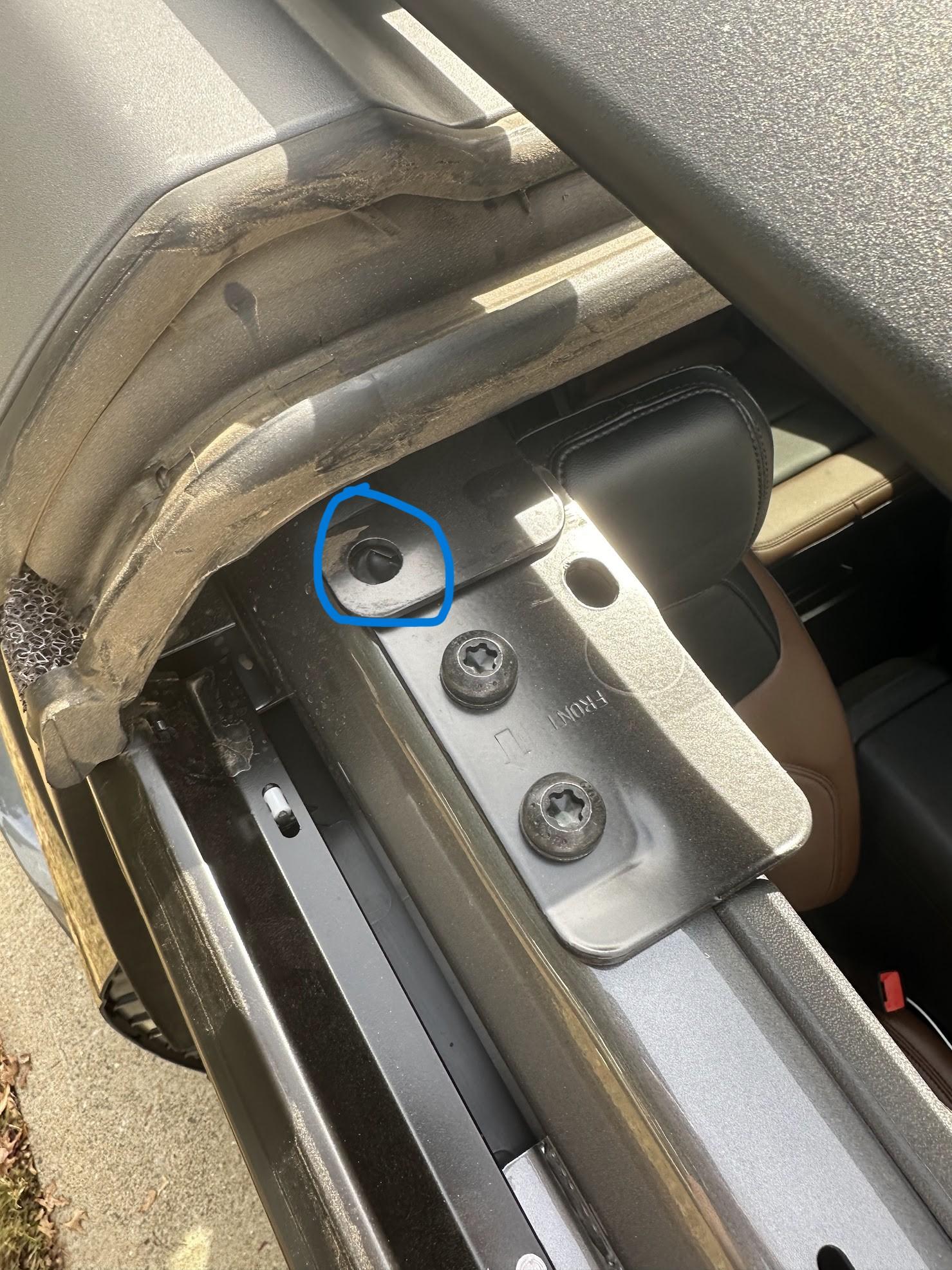

So on Saturday I had the front panels off of my two door. That metal piece, especially on the passenger side was banging around like crazy driving 50-80 mph. There is almost like paint or plastic that I poked through to reveal what looks like threads. It is hard to tell.
Now in the hardtop removal instructions, you do not remove any bolts there, so I feel like the answer is no, there are not supposed to be bolts there. But ok... what about the bracket banging around like crazy?
Does anyone else have this issue with that bracket/ the top buffeting like crazy in the wind?
My 2023 2-door has a bolt there, securing the metal bracket down. It does have some black plastic or whatever as you saw, but the bolt was poked through it and threaded down. The bolt is same as the bolts holding down the lower hardtop flange to the body, but maybe 1/4 inch or so longer.
Is it on both sides or just the passenger?

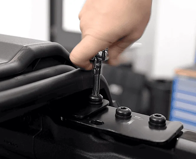

Both sides - driver and passenger side each have one bolt. It helps hold down the rear clamshell, by securing that metal bracket to the roll cage. Without those bolts, yeah I could see that metal bracket banging. I feel like the factory made a mistake and did not include those for you.

Here's a video showing a 2-door hardtop removal, at the point where the guy is removing that bolt:
Ford Bronco Missing Bolts for my Hardtop? 1698100032612
Weird. I watched a video on Bronco Nation that did not have the bolt.
I wonder if this was a production change, or a more common issue.
Mine is a June 2023 build though….
