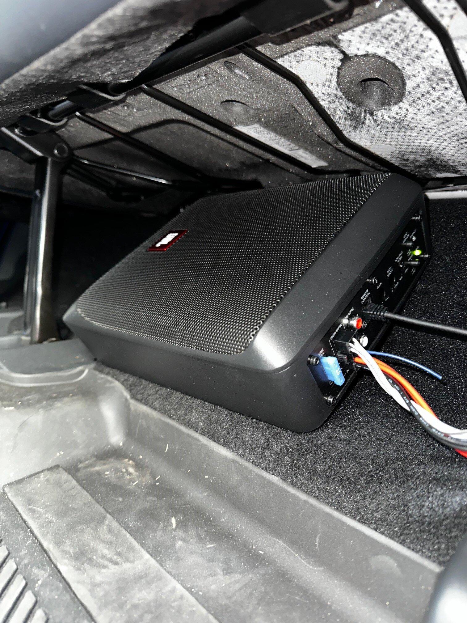

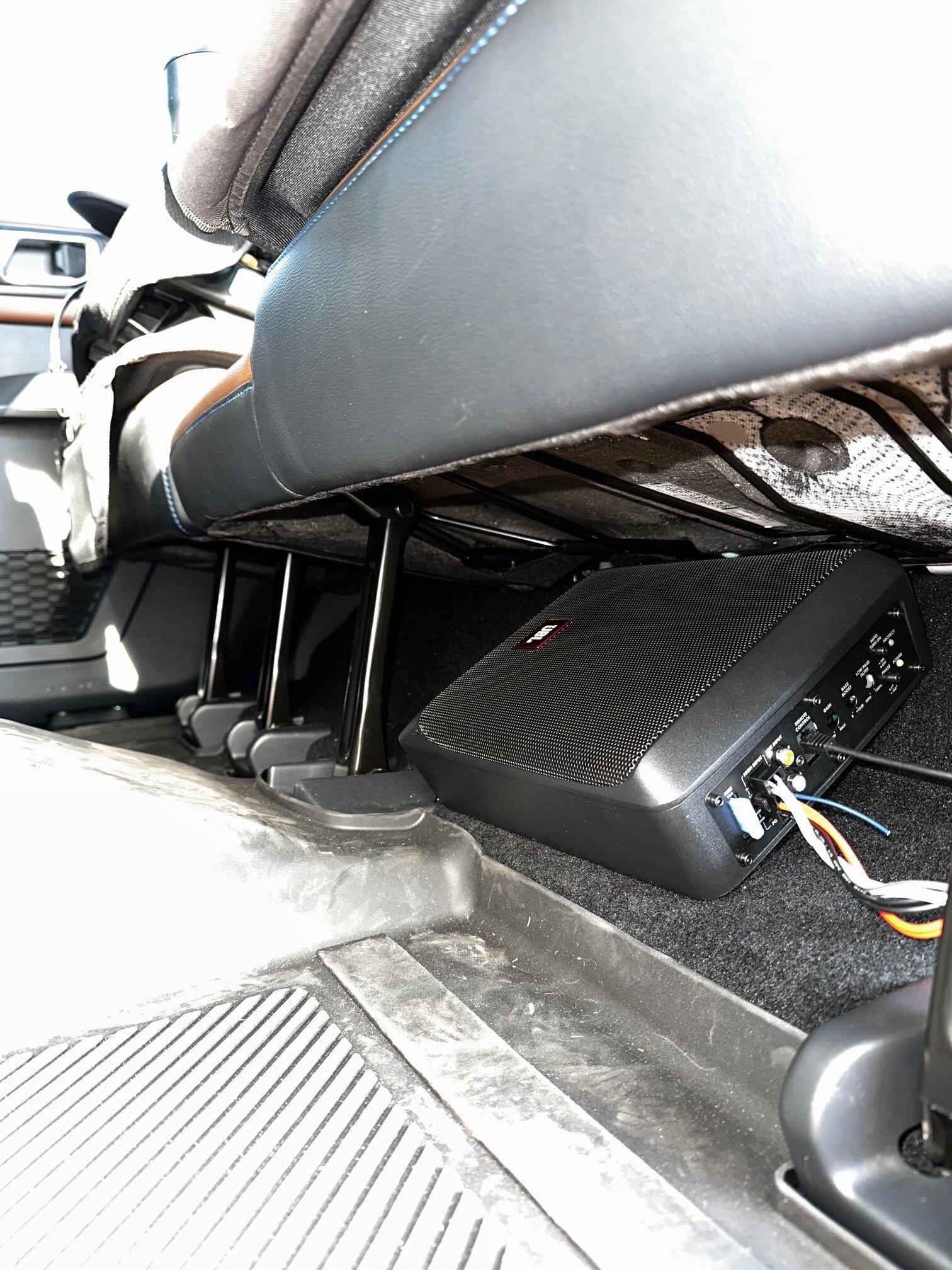

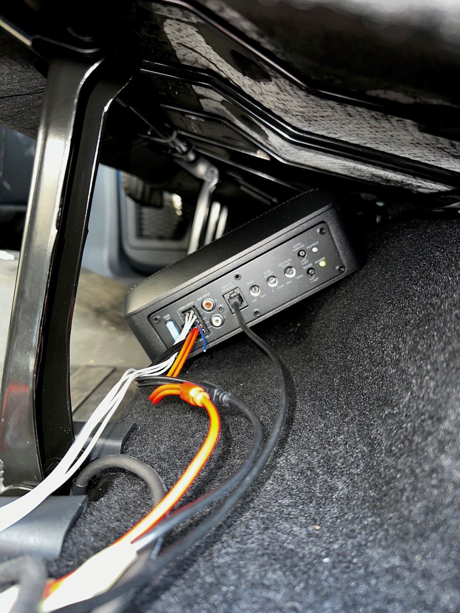

I got my JBL BassPro Nano installed. I was actually able to fit it under the backseat (4-Door OBX High Package). It fits really good actually, with some caveats. I had to install it at an angle due to the hump in the carpeted floor, but works & sounds great and I guess at an angle like this actually provides some extra ventilation, lol. I used some heavy duty velcro strips from Home Depot to secure it to the floorboard carpet. I lined the underside of the long ends of the sub with the velcro strips, and although they are not getting full contact with the carpet due to the angle, since they are heavy duty velcro they are providing plenty of grip. It's not going anywhere. There is also just enough room to clear the metal braces under the seat, so there is no metal on metal vibration. And if I ever want to remove it to fold the seats down, I can just unplug it and pull it up. Removing mine to fold the seats down will rarely happen, as I have kids in car seats back there and it's already a PIA to remove the car seats to put the seats down anyway. See photos (sorry, didn't take any before I stuck the velcro down).
I ended up getting the add-on powered sub wiring kit from PNP for the high level input, and just added it into my PNP harness I already had installed. In hindsight, you're better off just buying the full amp + powered sub PNP kit from the get go. I ended up doing double work, and ran into some slight problems, but overall I was able to overcome them and happy I'm tied in properly up at the head-unit. All I have left to do is clean up my cabling at the sub (cable management).

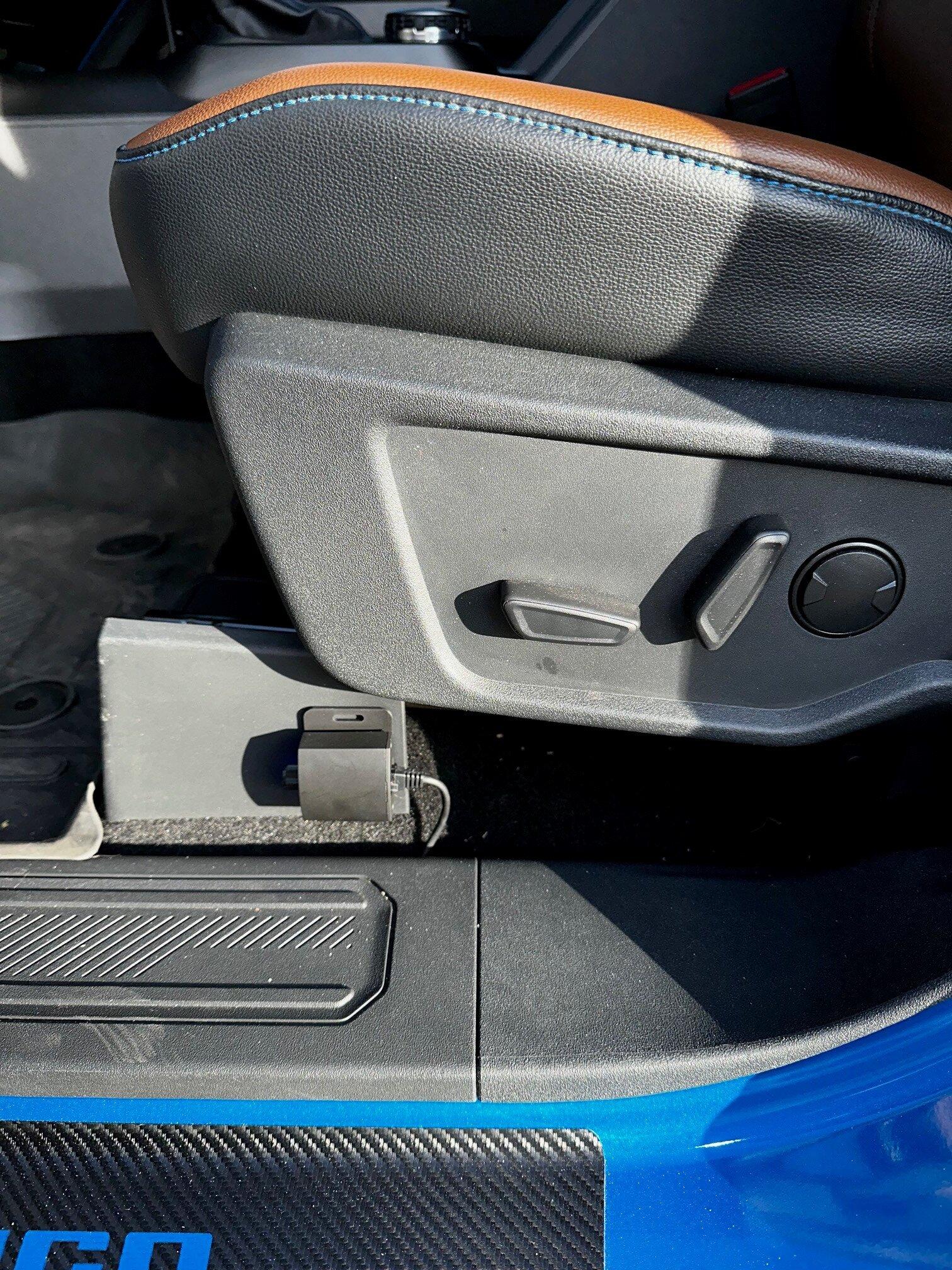

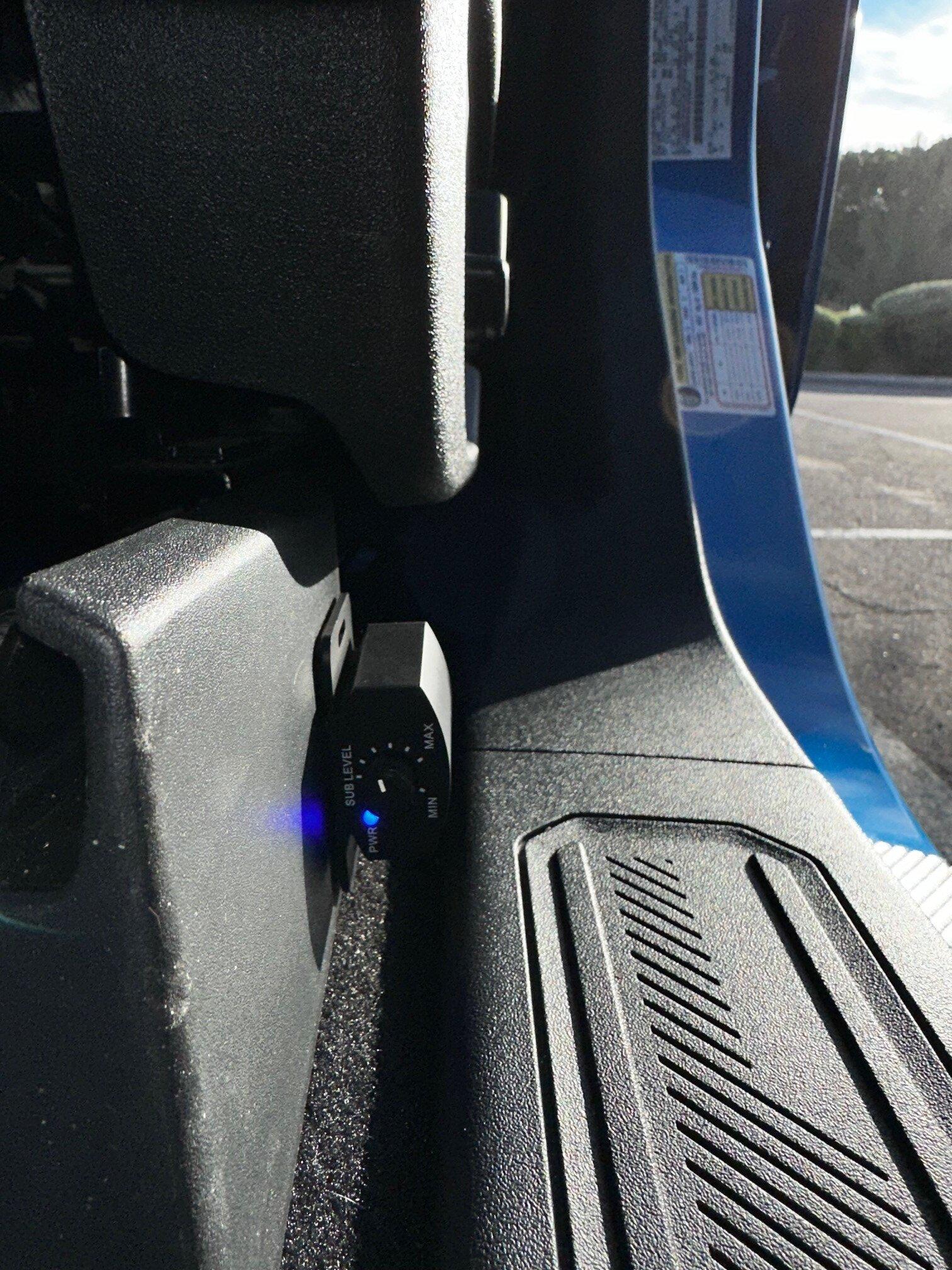

I must say, this sub kicks ass! It really puts out some bass for how small it is. Very impressive and makes the system sound so good. I almost feel like adding a sub should be the first step, even ahead of the Kicker Key and new speakers. I've never had a sub in any of my cars before, and can't believe what I've been missing out on. It's great because inside the Bronco this thing thumps, but outside you can't even hear there's a subwoofer installed. It's quiet from the outside.....no boom boom stoplight rattling. I also installed the remote bass control that came with it on the side of my driver's seat (see photos). I just used some double-sided tape.

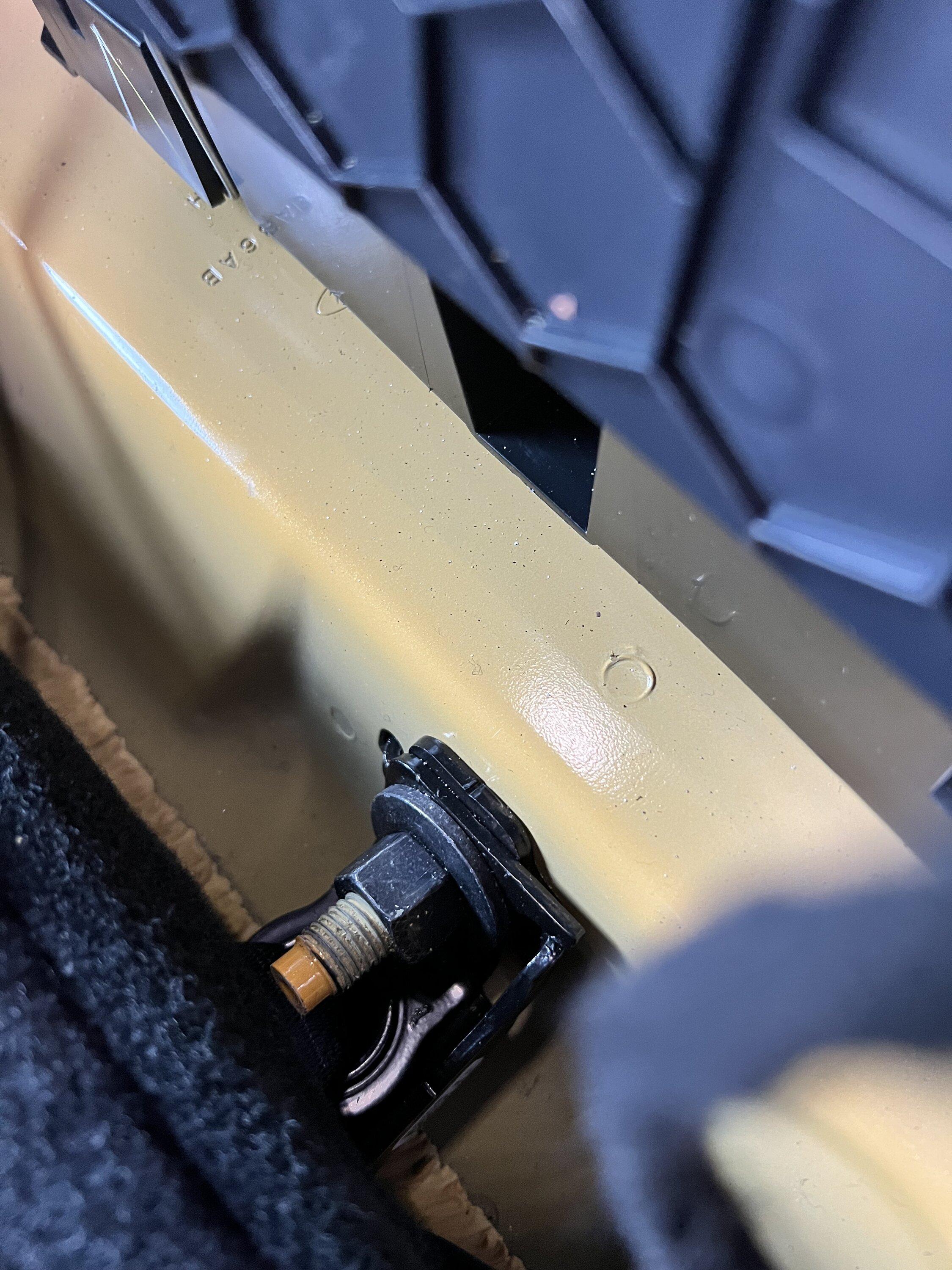

I am in the middle of the installation process and I wonder where did you put the ground? I see a few bolts from seats, but I am not sure... This:
Ford Bronco Mini Sub Install IMG_3699
