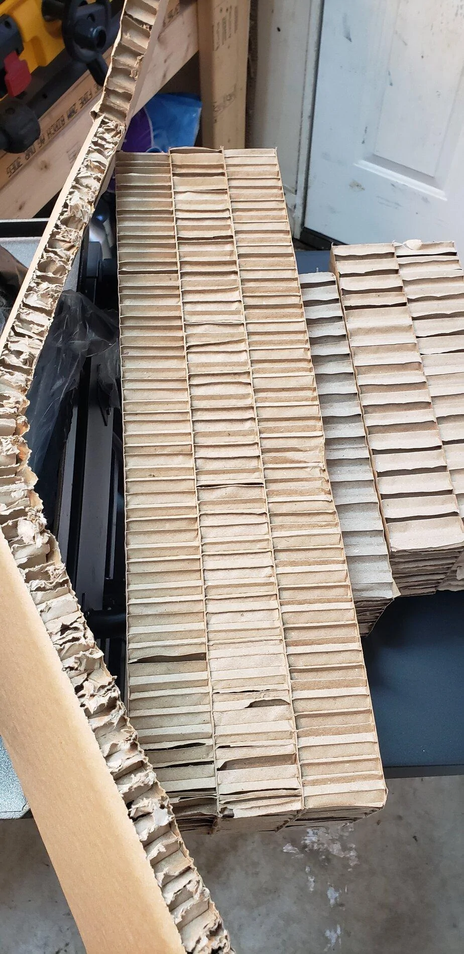

I bought a new blackstone griddle. This was in it, figured I'd keep it on hand in case I need to repair my roof when it gets here.
Ford Bronco MIC Top 1.0 inside construction & material (cross section) - pics 20211104_164221

if ford is reading this. Im not buying a mod top if its constructed this way. Please make the mod top premium construction. Even solid metal would be better than this shit.

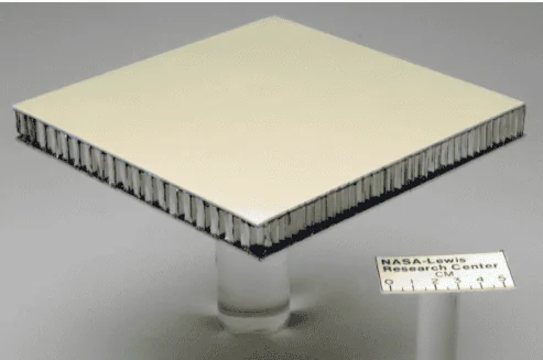

@Dragline These formed tops remind me of the type of Kevlar, Nomex and fiberglass honeycomb panels used in the manufacture of aircraft.
The panels I have seen have the finished coatings applied prior to the forming process. ( vacuum or hot press )
These edges really need to have a UV resistant strip.
A few references :
Understanding Honeycomb Panel and Honeycomb Composite Structures - YouTube
aeroFIBER™ Honeycomb Panels (collinsaerospace.com)
