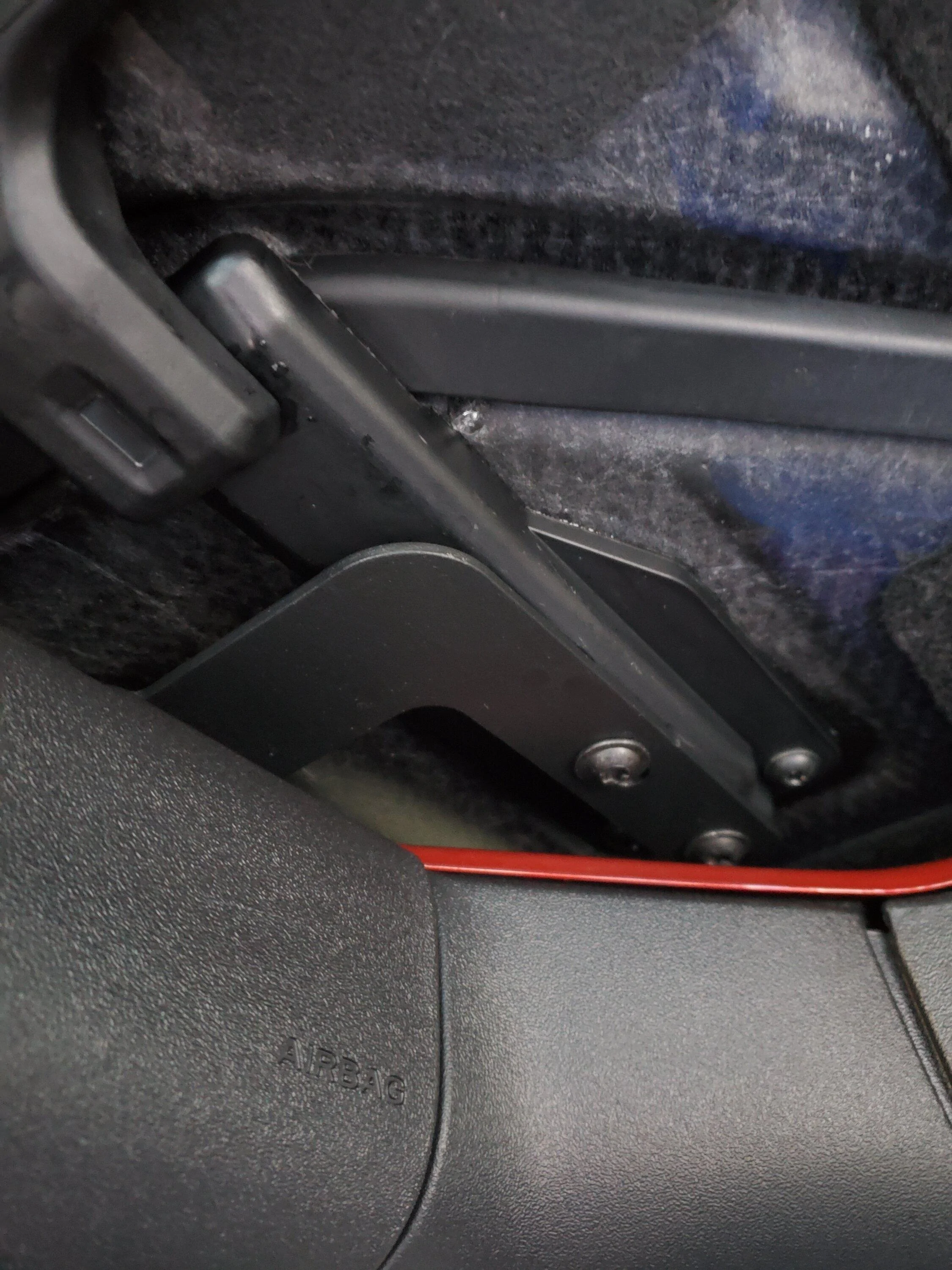

I think I've seen others with this leak, not sure when though. Definitely at the seam between the rear clamshell and the mid section.
I have removed and reseated the mid section, curious if others have had this issue and there's an easy fix or have to go through the hassle of dealing with dealer trying to resolve.

Dam, that's the worst one I've seen yet. As much as it sucks to have to go to the dealer you probably should take it in.
Has this been an issue since you drove off the lot? Did you inspect all the seals for defects/deformation? Have you removed the rear clam shell? When I reinstalled my clamshell I noticed that even with the alignment pins engaged I was still able to move the top slightly. I ended up installing both the front and mid panels and verified proper clamshell alignment/engagement to the mid panel before I tightened it down.

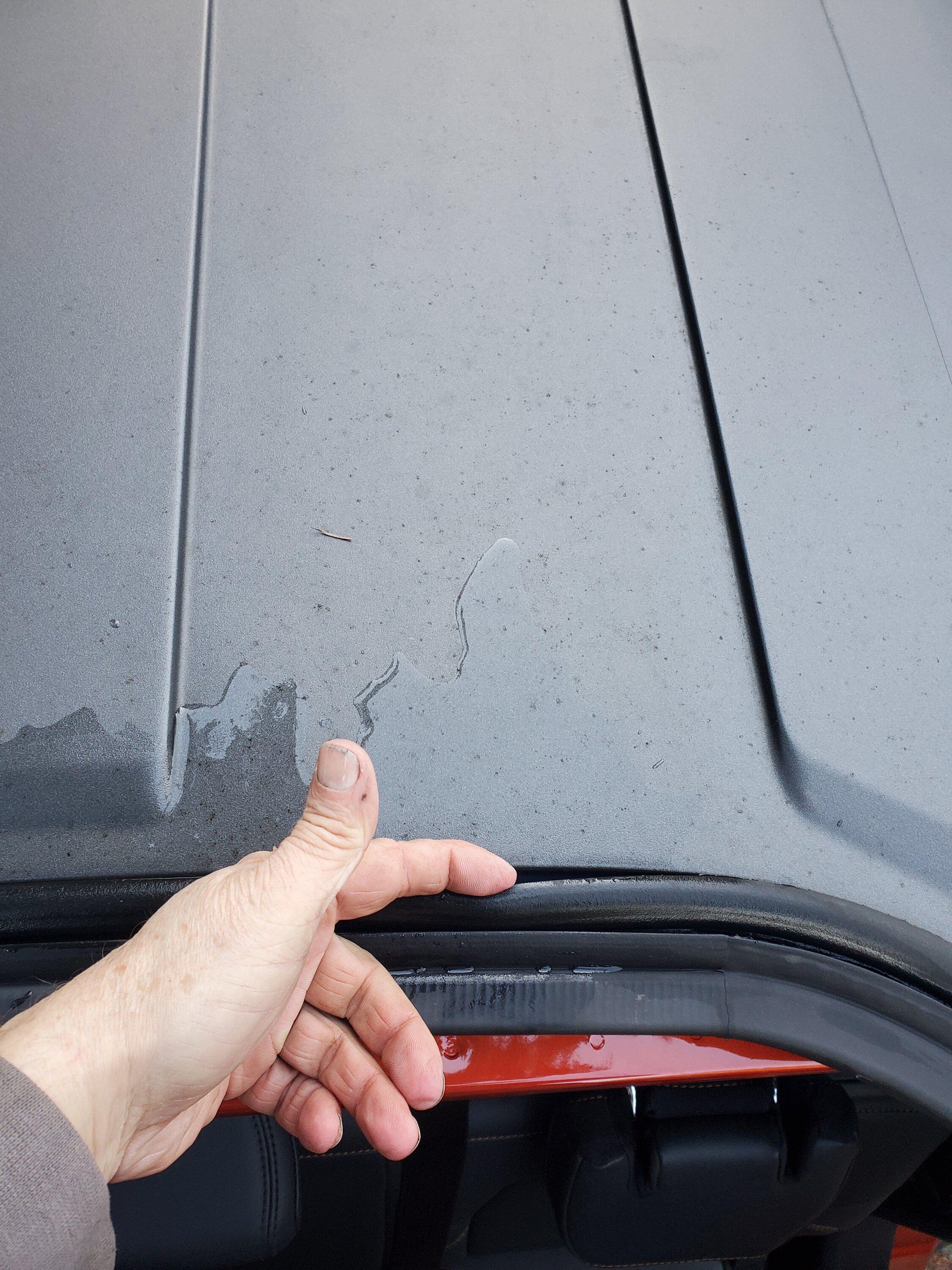

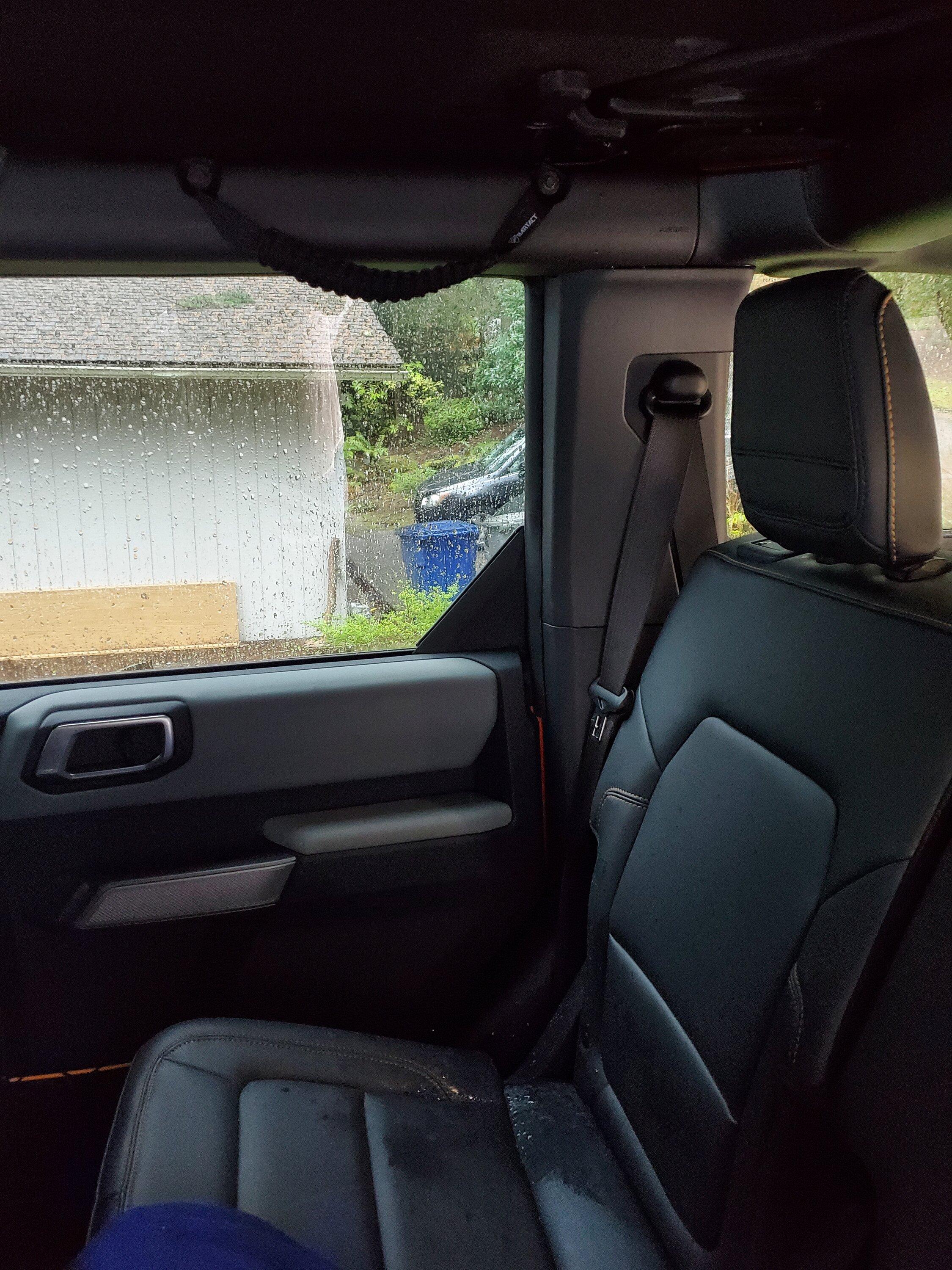

Welp, haven't been able to get it in to the dealer yet because of my schedule, but have things set up to take it in early next week.
Did get a chance to do a little investigation on my own though. Didn't rain yesterday (yay!) so things were all dry. Removed the panels and did a visual of the seal between the mid-section/clamshell. Everything looked good, nothing noticeable. Put it all back together making sure not to twist the seal or pinch anything.
Then I ran a hose over the roof, didn't direct it at the area, just let it flood over the entire roof. Went back in to the vehicle and sure enough, a drip was starting...
Ford Bronco MIC leak, rear passenger at back clamshell 20230119_141910
Interestingly, it seemed to be coming out of the seal, not around it. There was also noticeable moisture building up along the edge of the bracket that attaches to the clamshell.
When I moved the mid-section, it seemed like a lot of water was running out of it. As I said it was dry, but it appeared all this water was coming out of the roof section itself. Wondering if water collects within the roof panels and builds up until it finds a way out, i.e. through bolt holes for attaching brackets? If the edges of the panel honeycomb aren't sealed, water will get it in no matter what. Without some sort of weep hole it will build up till it finds a way out...
Gonna remove the mid-section again and gently pour water along the clamshell seal and watch to see if it works it's way through the panel and comes through inside...

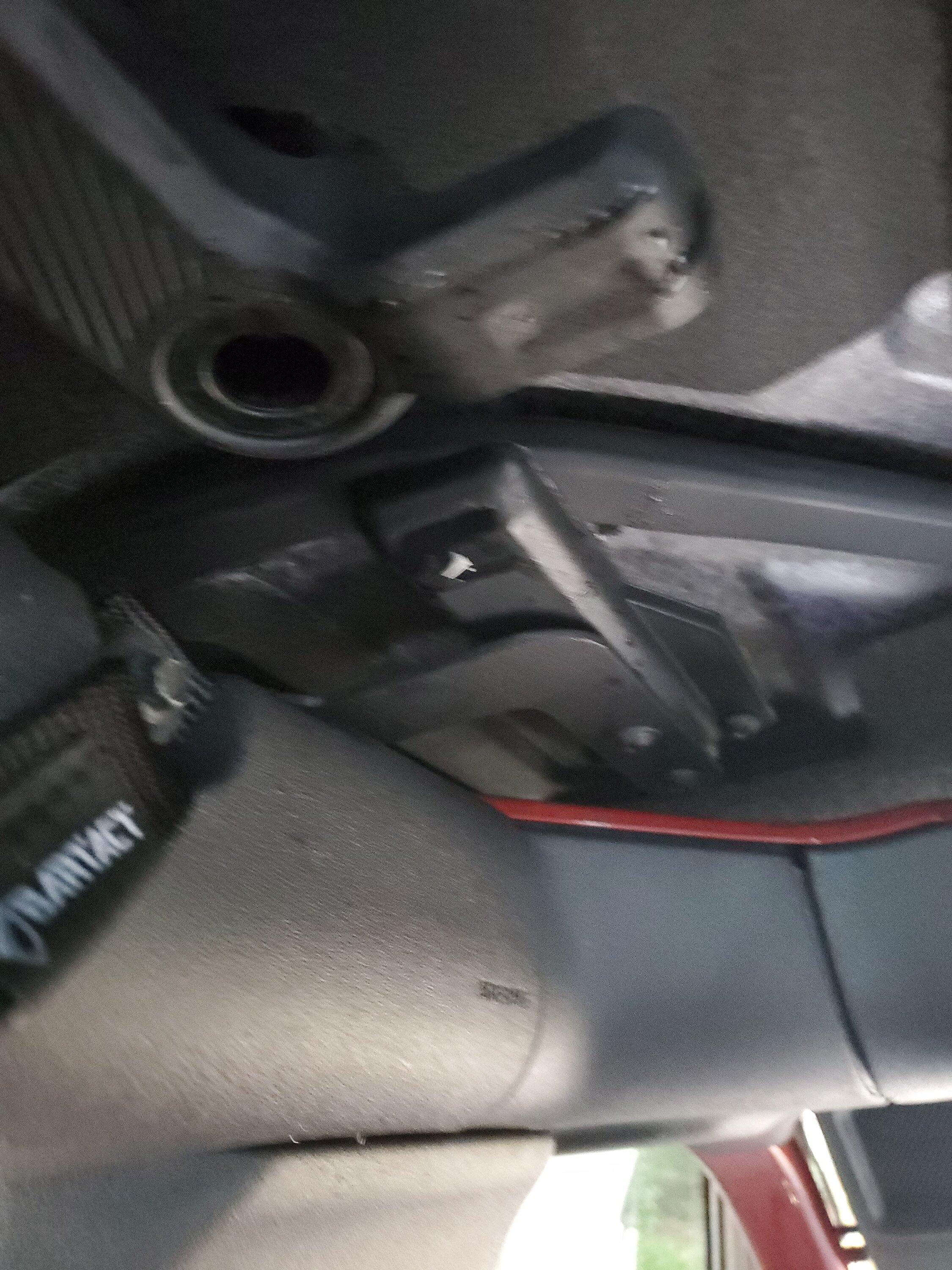

Well, for anyone following along...
Think I may have found the source of the leak. Inspected the seal along the whole rear clamshell. There is a section where it isn't adhered to the clamshell and it lets water under the seal. I poured a little water around it and sure enough in a little bit it was dripping out inside, seemed to be seeping around the entire bracket where it was attached.
I'm taking it in to the dealer next week. We'll see what they (and Ford, they gave me a case number) say.

Dealer had a chance to take a closer look at it and it is the seal. Don't know where the actual problem is though. They have one coming in, was supposed to be in today but no joy.
Apparently this is starting to show up more, dealer had another one come in this week too.
Ford customer service has been very active with following this through. They reached out through the forum here, gave me a case number. Followed up with phone calls, and have been in contact with the dealer service dept. The head service writer asked me who I knew at Ford, LOL.
