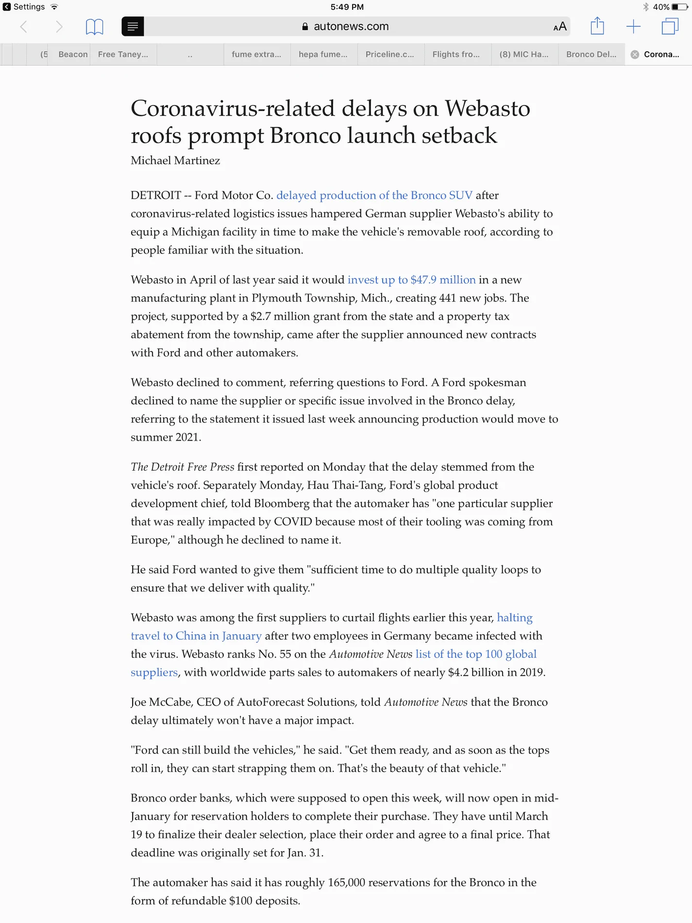

Actually the modular tops will be made in Michigan at a brand new factory which is the reason for the hold up. The company is called Webasto.
The MIC Units are the foreign units

All tops will be made in Michigan
As of now the MICs are not according to my sources, but Webasto probably will make those too when that factory gets up and running

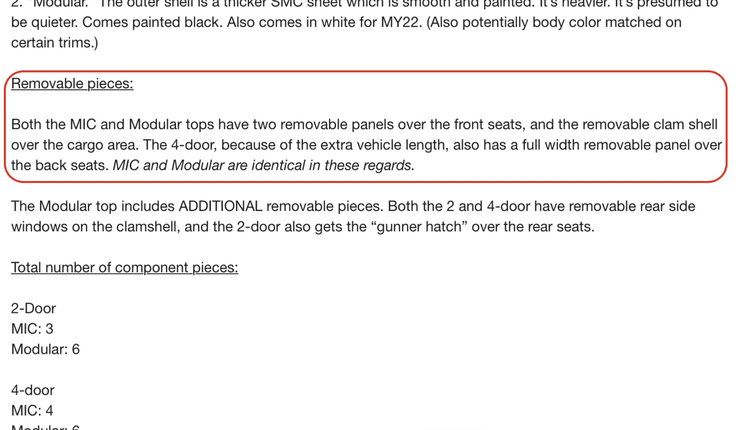

It is attached to the rear clamshell. I was just saying that if you REALLY wanted to remove it you can, but in the same way you can remove a steering wheel or seat. You need tools.
OK...it could be the booze talking at this point, but I don't get it. If the documentation below shows that the clamshell is designed to be removable, why wouldn't the rear cargo glass be included in that? Are you saying that it requires tools just like the back of the MIC top requires tools, or are you saying that the rear cargo glass wasn't intended to be removed?
@ZackDanger As the local expert on the tops, can the entire rear section of the modular top be removed similar to how the MIC top can be removed? I know the modular top has the unique rear quarter panel windows that pop out, but was the entire rear clamshell, including the rear cargo glass, designed to be taken off?

Maybe it is the booze... but I don’t understand the confusion.
With both the MIC and Modular tops... the entire rear clam shell is removable. It is shaped and designed to attach to the vehicle in exactly the same way. They’re basically the same top in this regard, just made out of different material.
(Additionally, the two side windows on the mod clam shell are removable. They pop out of the frame.)

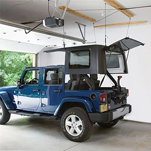

On both tops, the rear-most flip up glass is bolted to the clamshell at the hinges. When you remove the hard top, the rear glass comes with it. It’s permanently attached to the top because you have the wiper, washer, gas struts, and defrost hardware in it. The rear top and glass are exactly like how they are found on the Jeep Wrangler.
Ford Bronco MIC Hardtop vs Modular Painted 1609474765987
(Ignore that “diving board” sticking out over the seats... the Bronco doesn’t have that. Ford fixed that obvious oversight)
I think maybe you’re confused because there was a ton of discussion here a while ago with people asking if they could take off *just* the flip up glass (and leave the clam shell on)... and we had a hard time explaining that it was bolted to the top... so I think maybe people are just eager to make that point again and it comes across as sounding like the glass isn’t removable at all?
