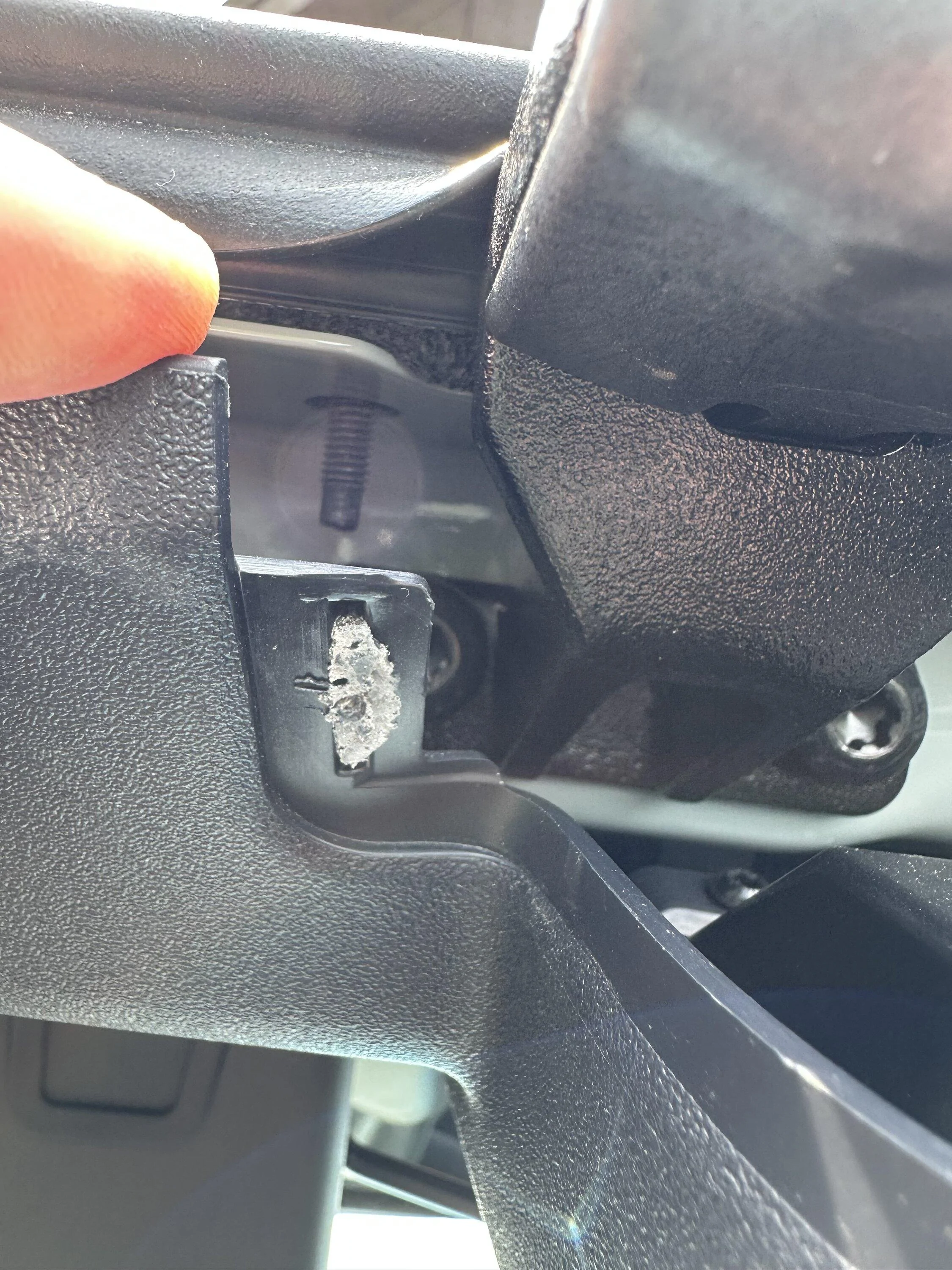

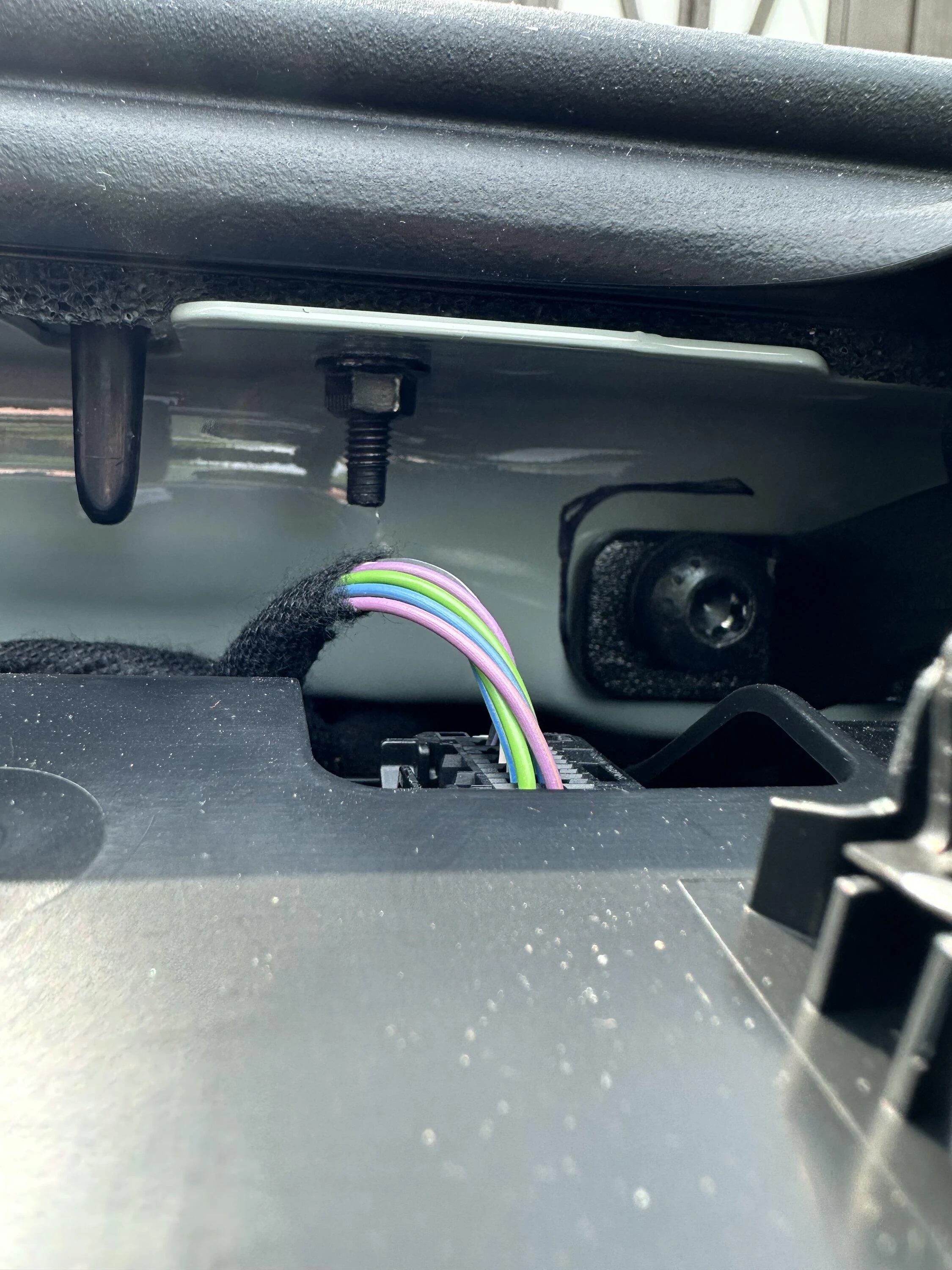

I also have this leak, had it in the dealer and still leaking. I did some investigation under the interior trim and noticed the two drivers side bolts holding the header seal to the body are missing the nuts. Does anyone know the size or part number of those bolts to order @Ford Motor Company? I think the water is leaking through those loose bolts into the interior trim and then into the drivers side airbag and aux switch panel.
Ford Bronco MIC 2.0 leaking into A pillar trim IMG_0056
Ford Bronco MIC 2.0 leaking into A pillar trim IMG_0054
Ford Bronco MIC 2.0 leaking into A pillar trim IMG_0055
Just an FYI for everyone following this thread. I had my dealer order and add the nuts to the bolts highlighted above and this completely fixed my leak. As I inferred, the leak was caused from water getting into the sealed channel along the A-Pillar. This is supposed to happen, and there are drainage holes at either end of the channel. However, because of the missing nuts, water was leaking through the holes with the loose bolts, into the interior plastic trim under the A-Pillar and then would leak out either through the Aux Switch housing (and into the gap around the hero switches and all over the electric in there) or through the drivers side A-Pillar airbag housing. This is also why it generally wouldn’t leak when the car wasn’t moving. When the car was moving, and those bolts would shake/move, and water would then leak through. @Ford Motor Company I would look into this as the cause of a lot of leaks along theA-Pillar. I think several vehicles may be missing the nuts as I’ve indicated.
Holy necro post
Fighting a leak that started this fall, 2022 Badlands. Had been fine since new, but then it started from above the visor, coming from where the trim pieces fit together. Not when sitting, not even in heavy rain, but when driving. Usually after driving 5-10 miles. Tried applying the sealant to the entire front edge of the seal, but it came back. Saw your picture and was more aggressive with pulling the trim down so I could see in there. Sure enough, missing a nut. I had been thinking they were captive nuts so figured I was going to have to pull the seal out completely this spring and seal around them all. Hopefully this is the fix I was looking for. Thx!
