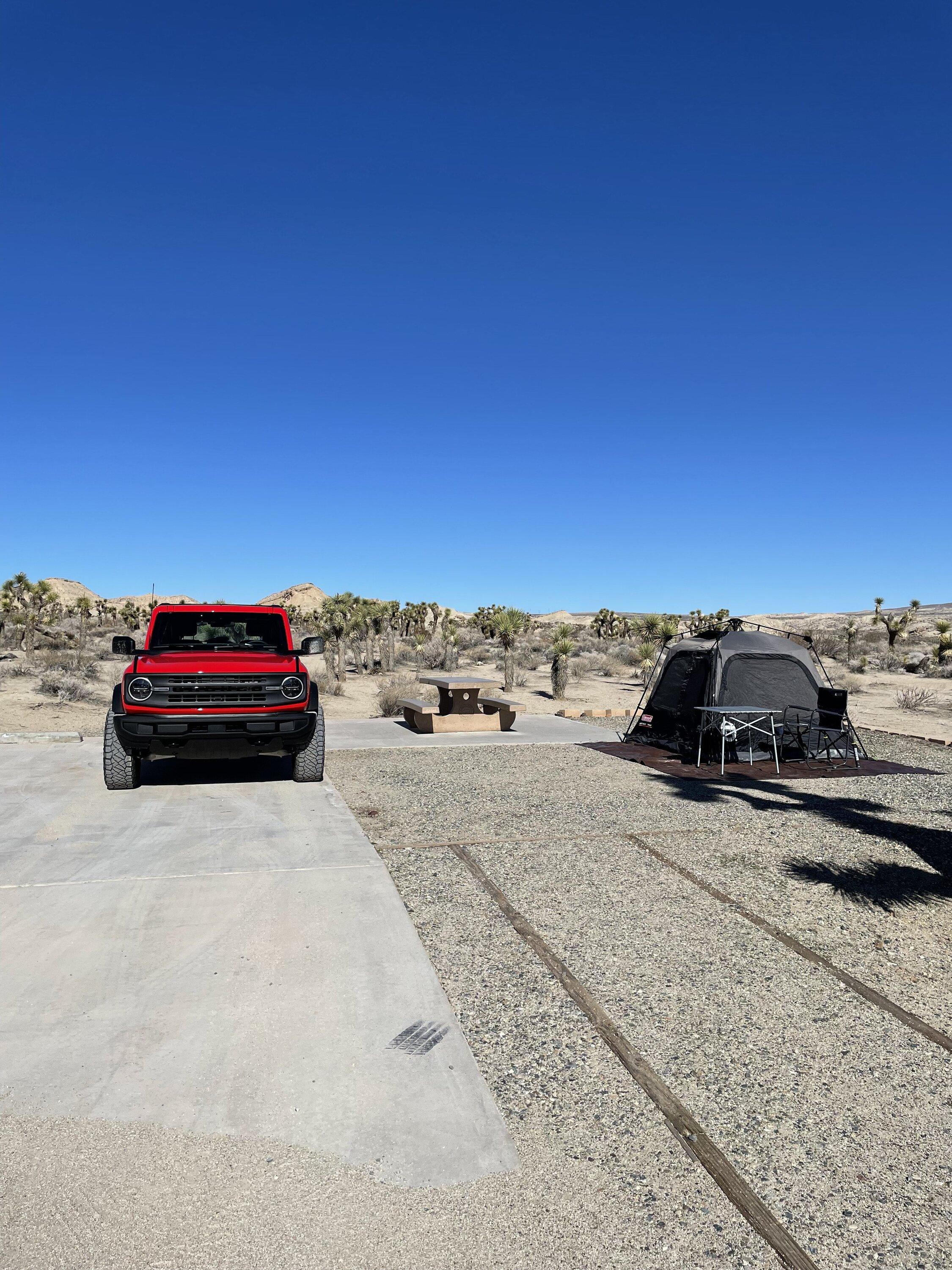

I have the exact wheels you're asking about. Here are some pictures from the side and the front. The wheel and tire sizes are in my signature. There is definitely poke. Zero offset.

The Method 305 with a +25 is a perfect fit in your particular application. There will be a slight poke with the stock 265/70R17. That poke will be more pronounced with a taller/wider tire.
Hub rings are always a good idea. A very inexpensive way to eliminate vibrations.

I was told by a distributor that they did not require hub rings. If they are optional which ones would I need to buy? I also have the push through caps that stick out (see above pictures). Would I need to order new center caps as well? Thanks.

@Desert_Brush In addition to the cap you currently have, there is a lower profile cap available to order if you wanted. After talking with their technical department, hub rings are not needed as they interfere with the push through center cap and will not seat flush. my apologies for the misinformation.
