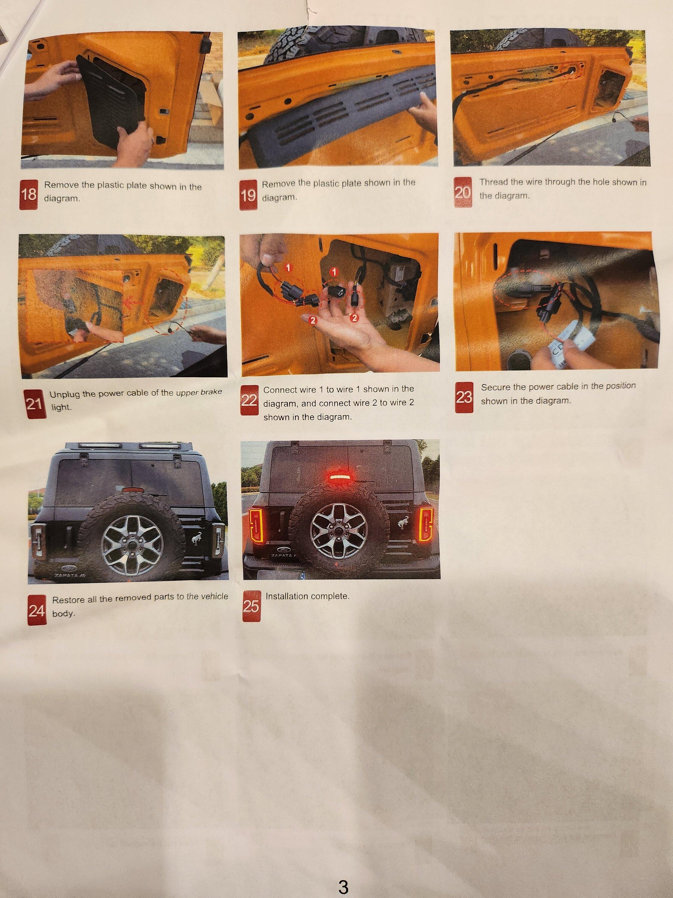

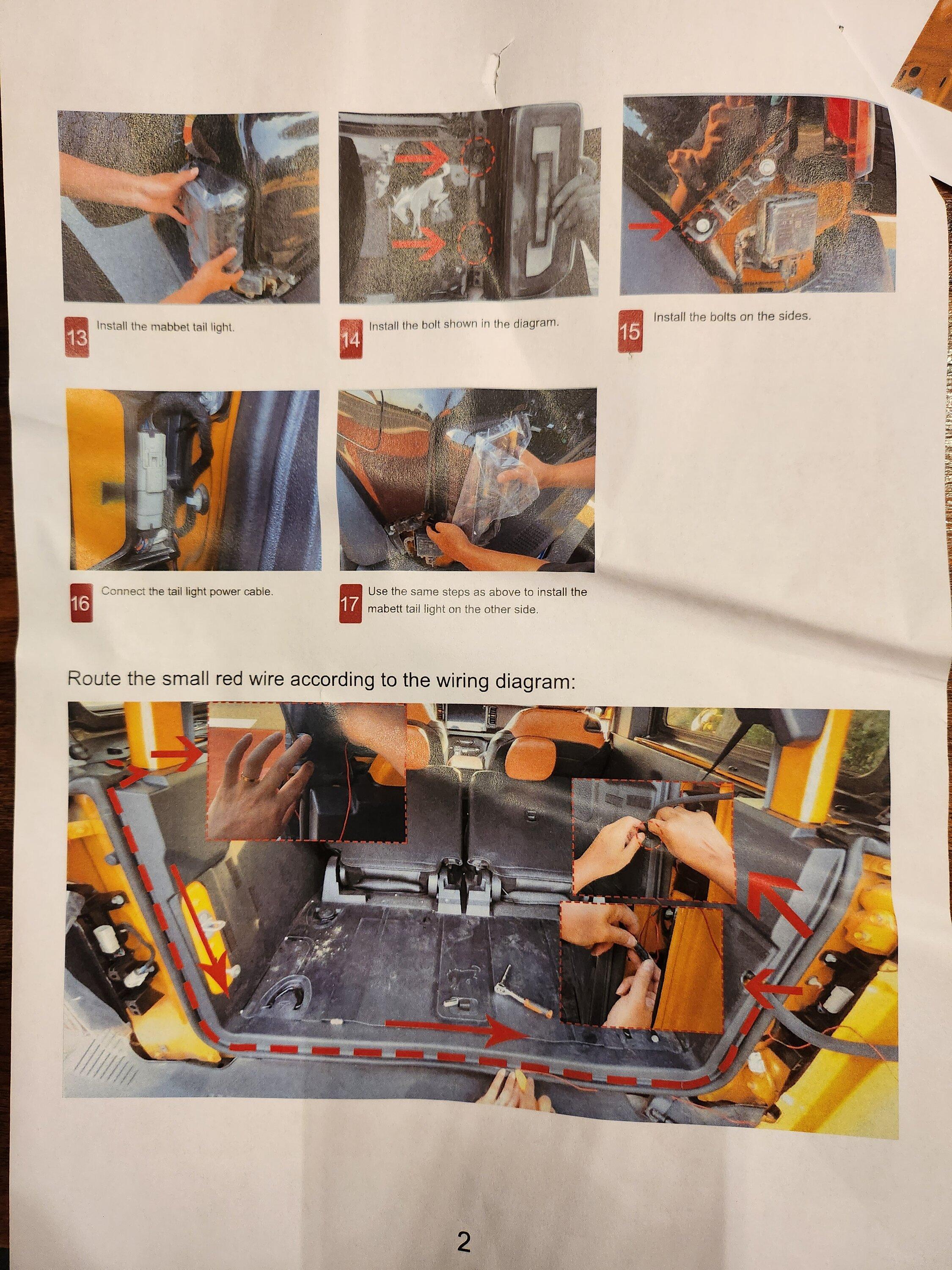

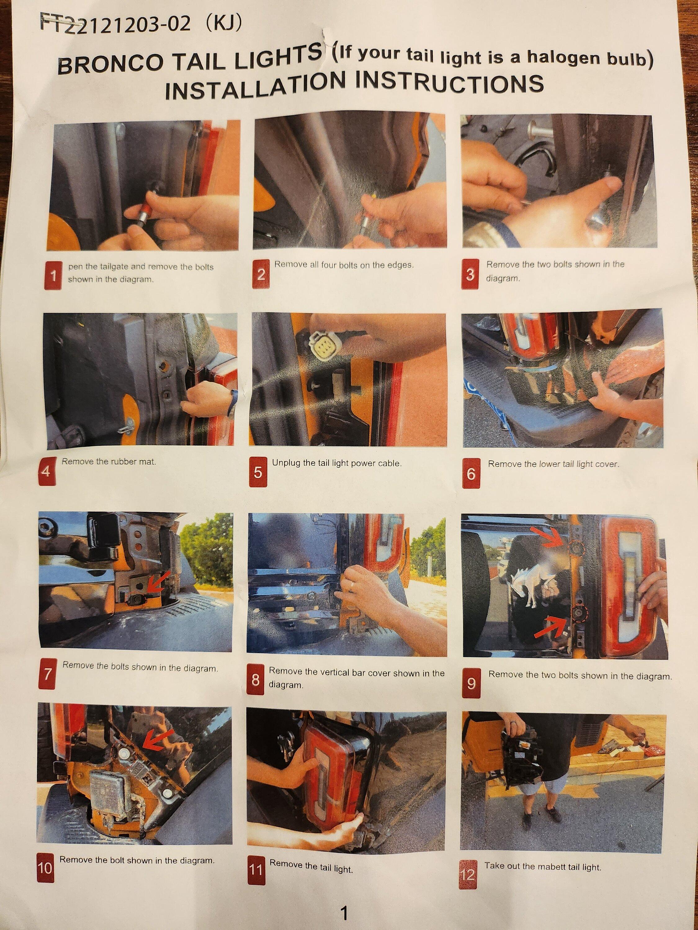

Oooh - am I reading this correctly? I can upgrade to OEM LED-style taillights from my standard halogens?
If possible, could someone attach the installation instructions if coming from factory halogens?
They look good!
When I recorded my install video (above), I was sent a prototype version of the tail lights.
The connector that comes on them is plug and play with a load resistor to work directly with the Halogen tail lights. Simple plug and play.
Being as I had the LED tail lights already, I was sent an additional harness by Mabett and removed the load resistor and harness and replaced it with the new harness they sent me. Worked perfectly, plug and play for the LEDs.
Not 100% sure of the production solution that they are providing, but that is what they sent me originally.
