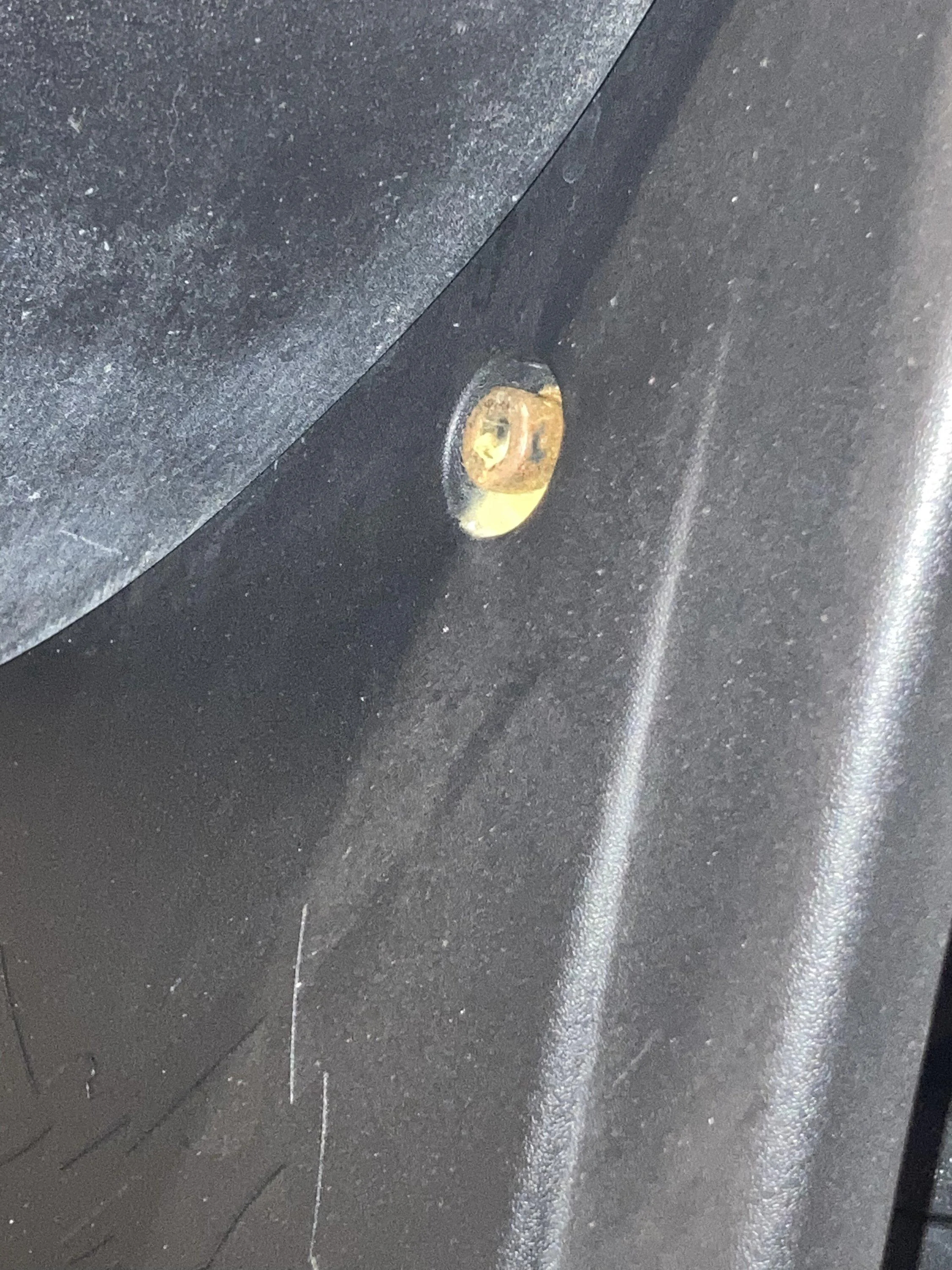

Mabett, so do I need to replace the U-clips due to rust? I bought stainless steel bolts and installing my front mud flaps today!
I haven't received any feedback on rust on U-clips

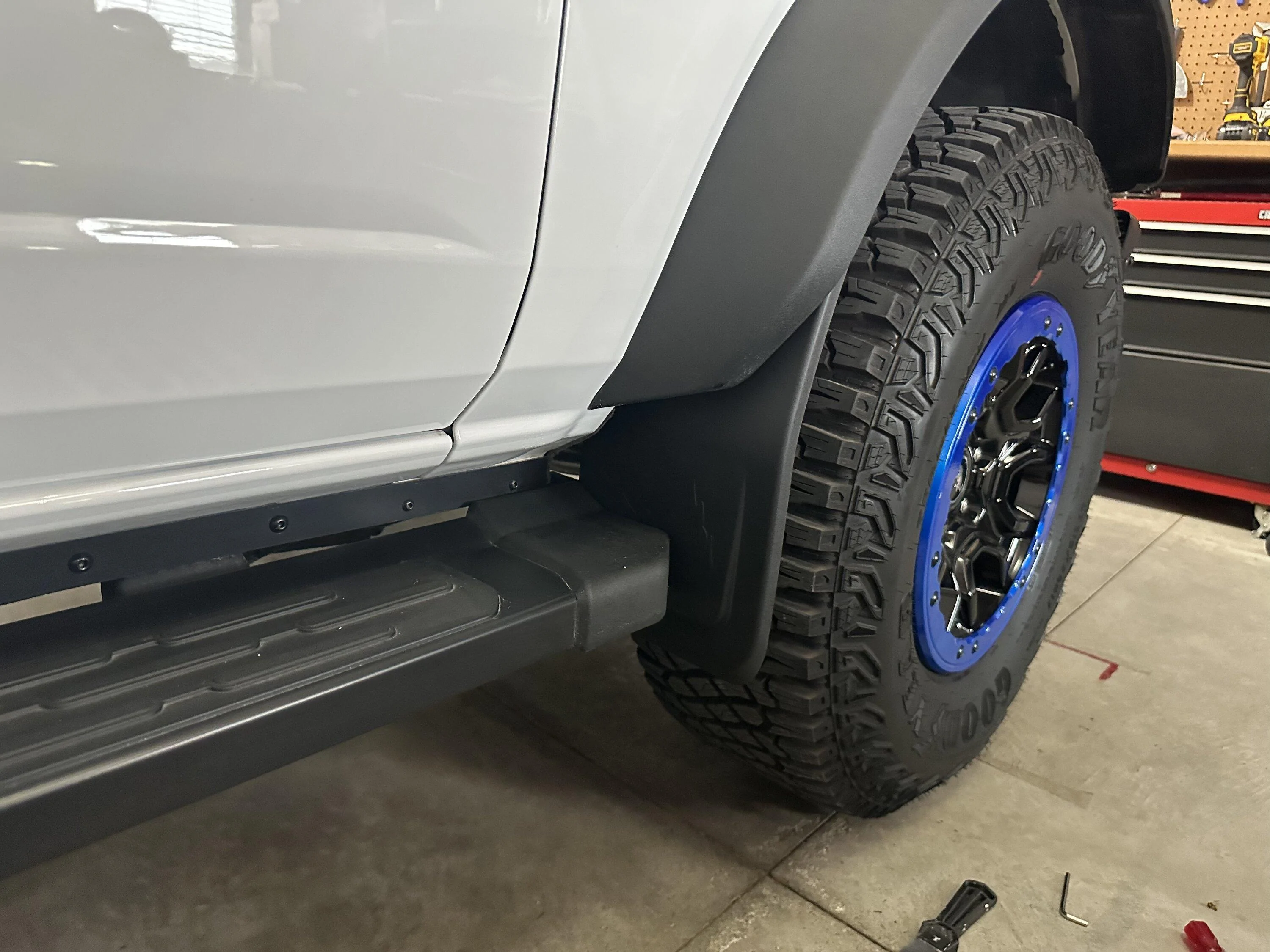

Some install comments after installing the Mabett front flaps.
- I used stainless bolts and clips from Amazon.
- The bolts that go into clips on the fenders should be 20mm instead of 16mm long. A couple were hard to get started. It would be easier if they were longer
- Mabett should provide a new longer push pin for the in-board hole or maybe a screw. It is very hard to get engagement when you add the flap thickness.

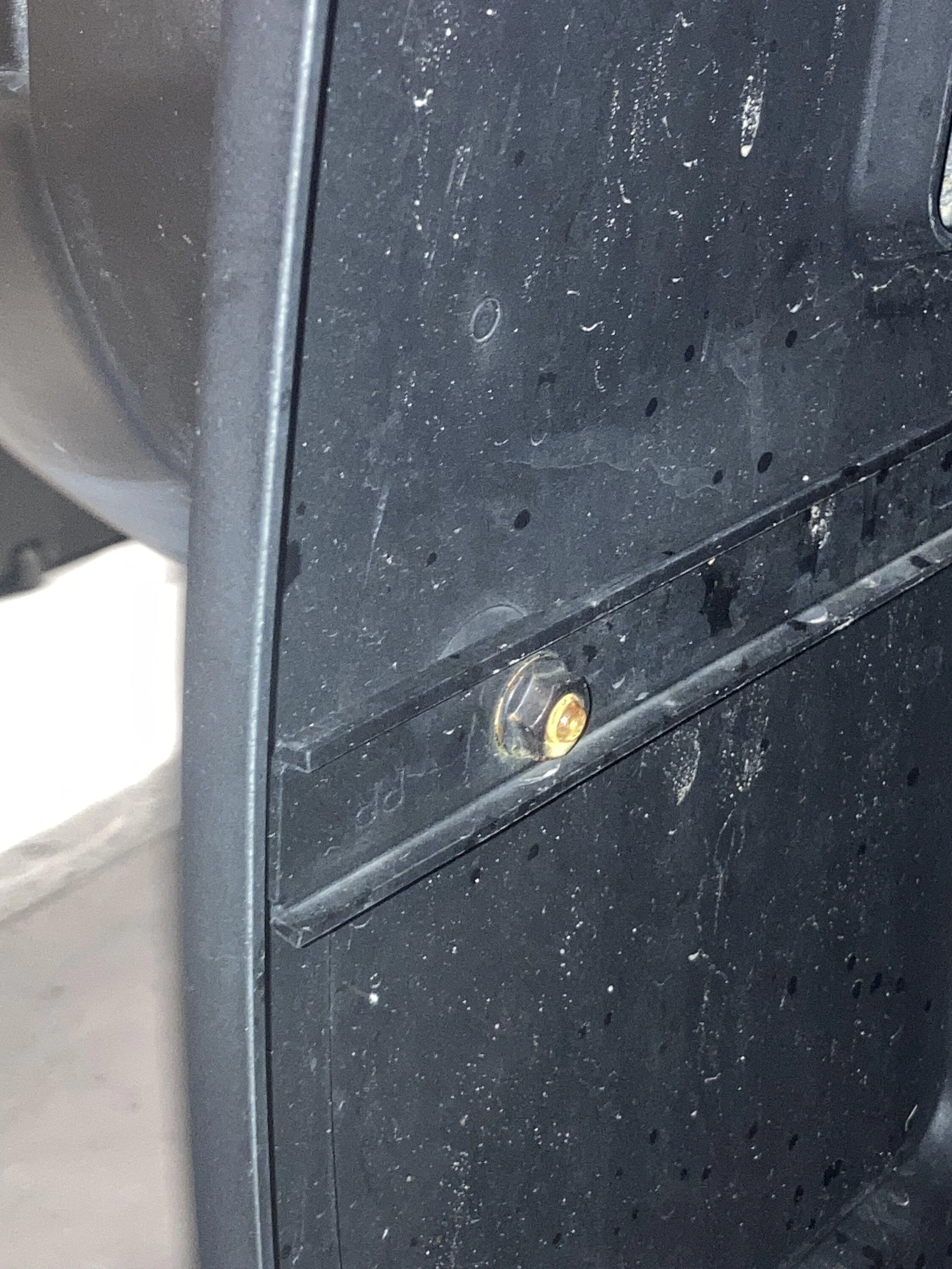

I finally installed mine last Friday and love them! I bought these stainless bolts and clips from Amazon and they were perfect, but what about the size for the rear?

I bought the front and rear flaps. The stainless steel bolts and clips that I ordered separately didn’t fit these locations.

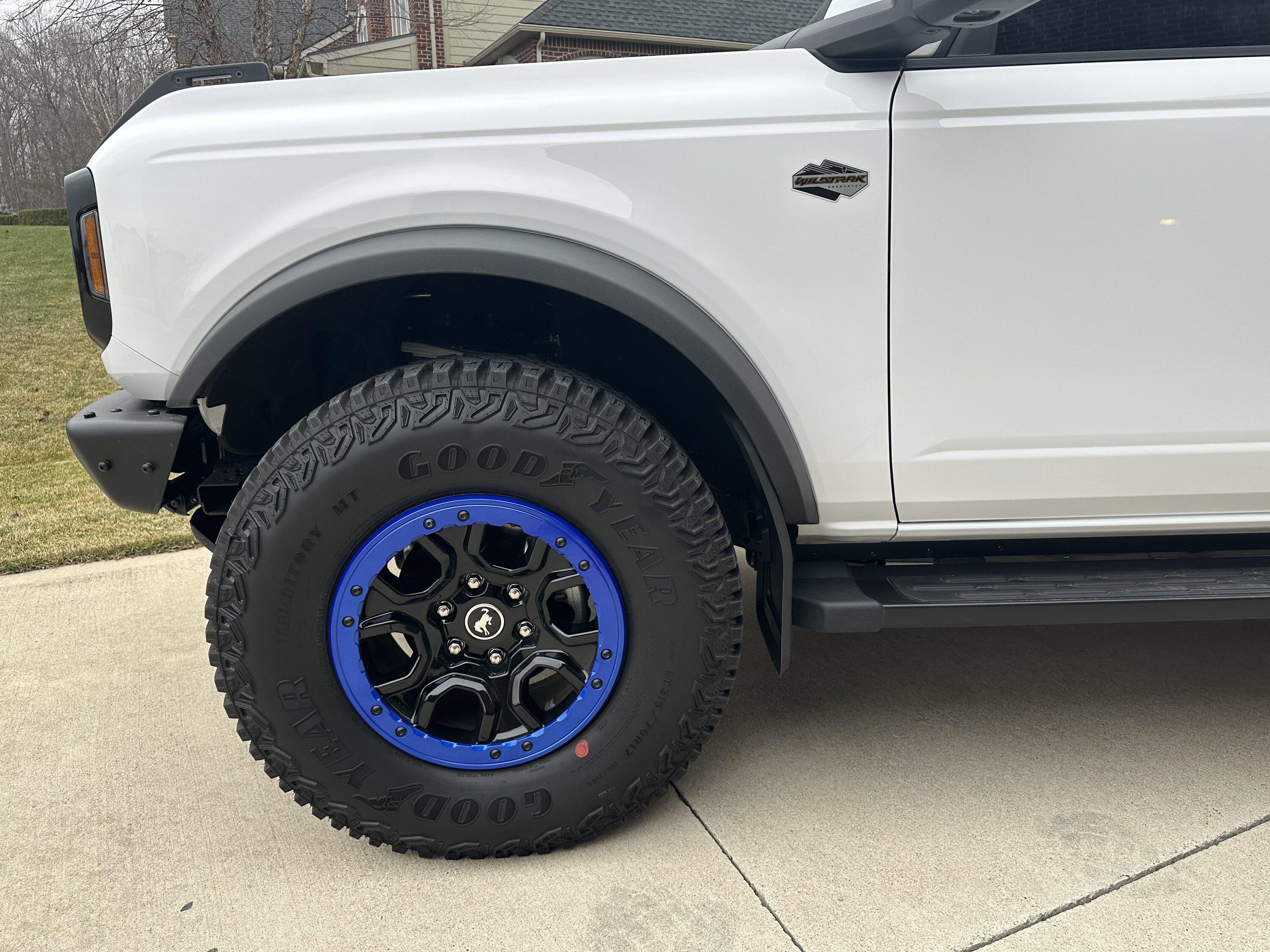

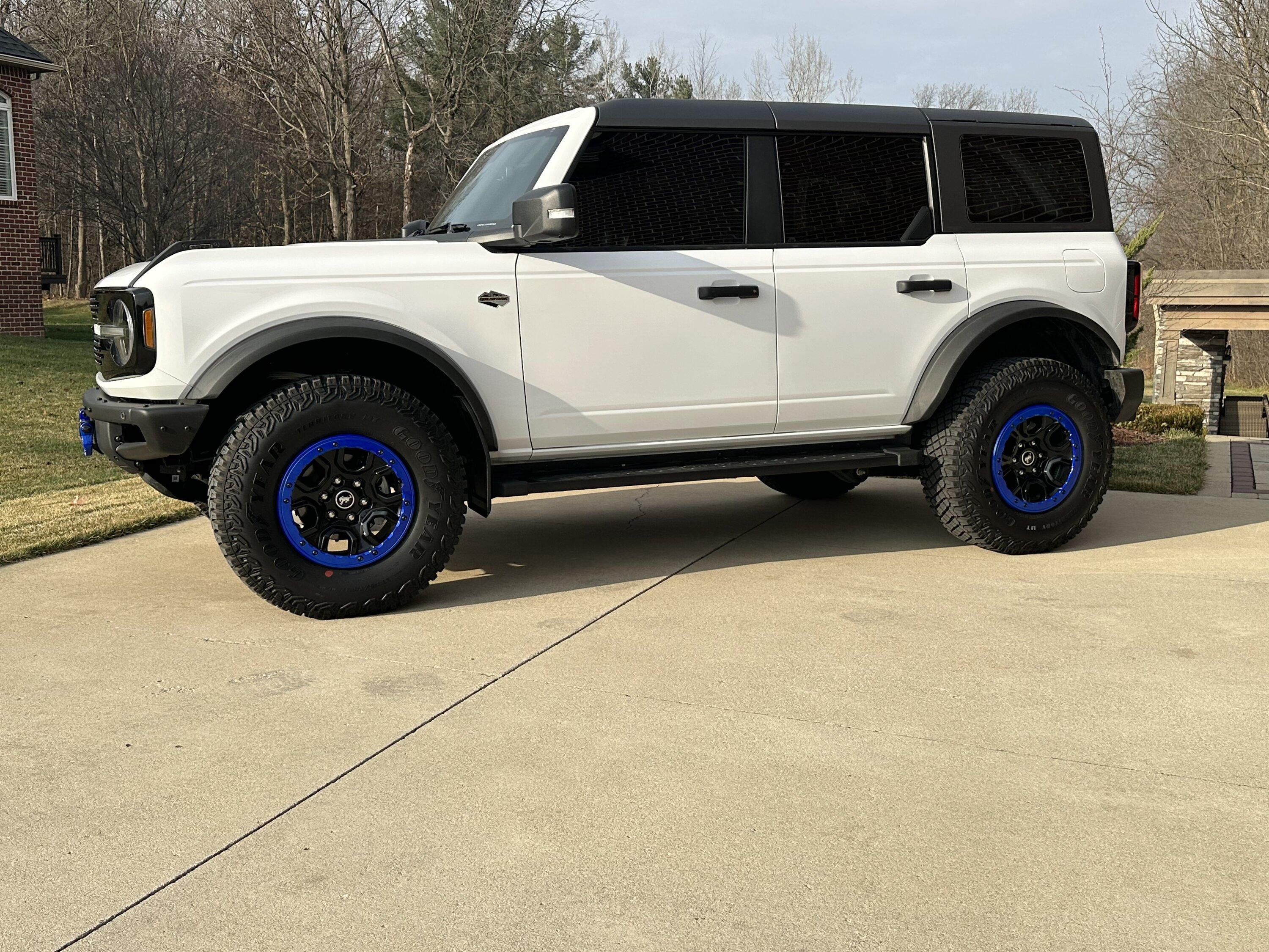

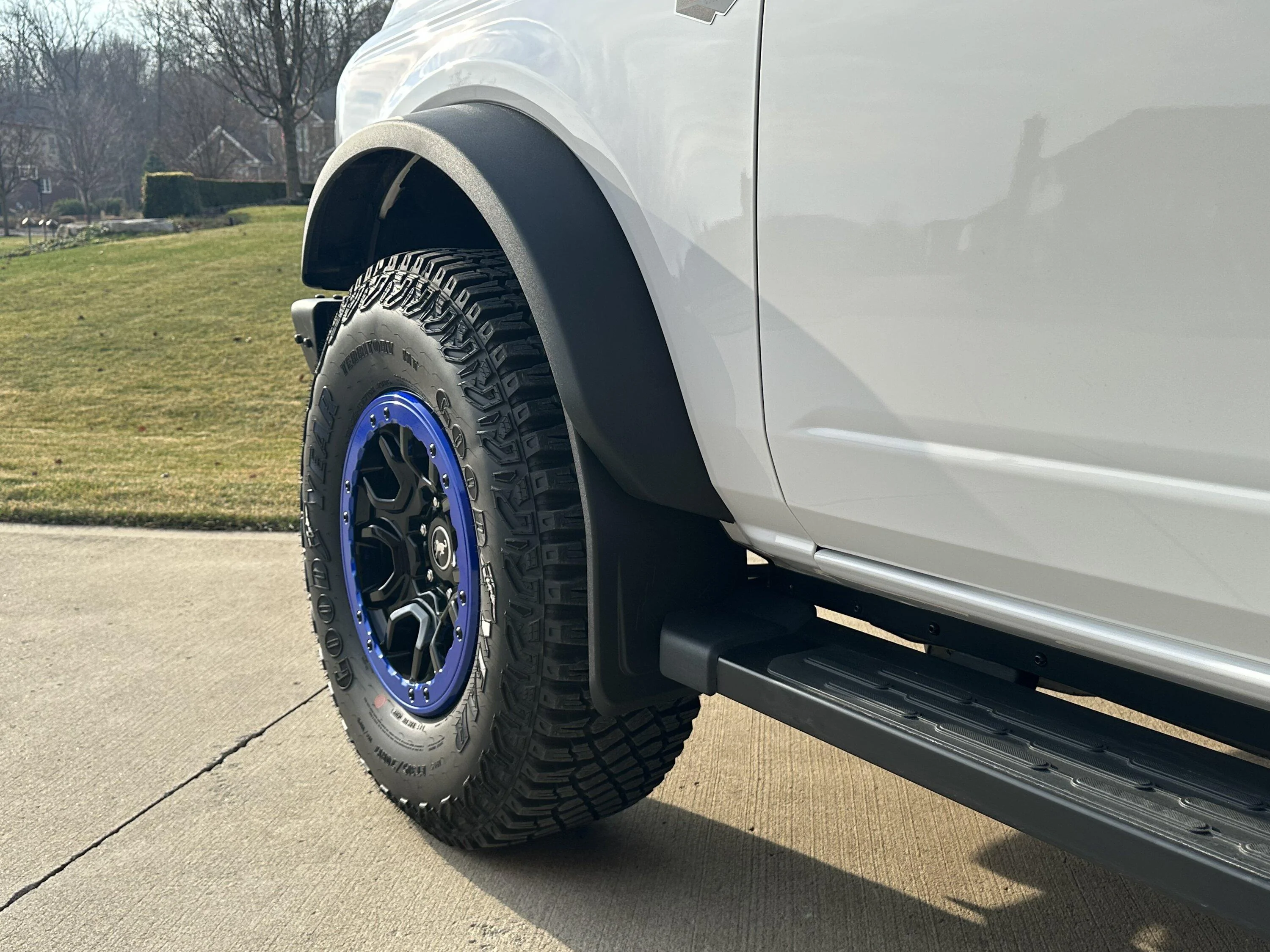

Just installed mine and love the look too! I did the fronts only on my Wildtrak. Also made a vid of the install if anyone wanted to see an other perspective of installation. Some other good vids out there I see as well. This is the look on my White 4-door Wildtrak.
