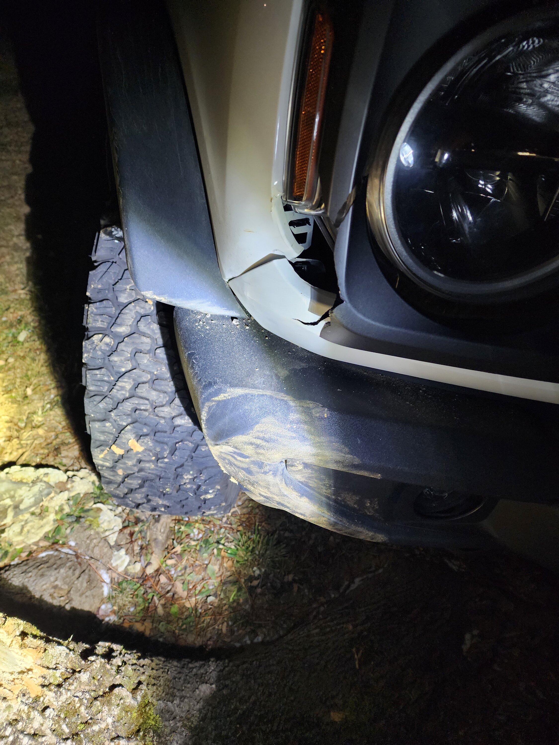

Almost daily I am getting the low power mode. My e brake did not stop my vehicle from moving while I was not in it. Per usual the dealership is not taking an accountability.

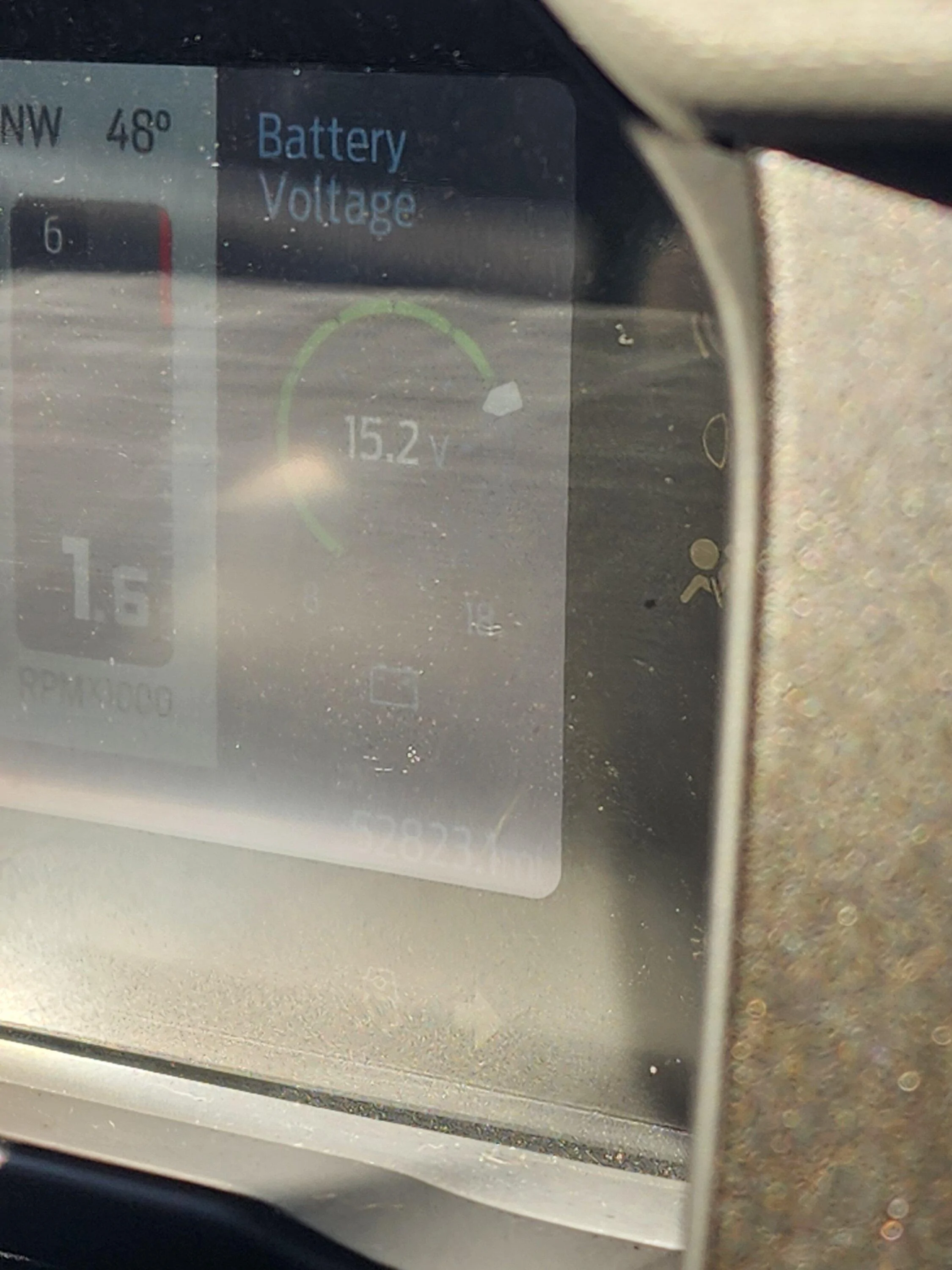

Update that could be related. I am having weird battery voltage issues. It will be at 13 and spike to 15.2 in a mili second. Anything over 15 is not normal nor is the spiking.
Ford Bronco Low power mode. E brake failure! 20231216_112310
15.2 isn’t abnormal depending on whether the battery is in a refresh phase or not. Normal range is 12.2-15.2 but either way, with your low power mode issues you should probably just have the battery check out. Could just be as simple as a weak/failing battery.
